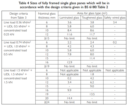

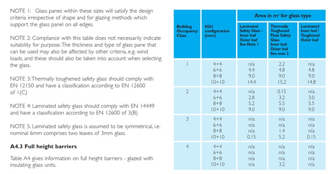

craig Posted January 22 Share Posted January 22 (edited) I use https://skyciv.com/wind-load-calculator/ and https://www.omnicalculator.com/physics/wind-load / https://www.omnicalculator.com/physics/air-density I tend to enter the data into skyciv, then obtain the m/s and enter the m2 of the unit and assess the glass and unit requirements based on those results. I do have a program being built specifically for this but at the moment this is what we use. It is then for your SE to check this data and sign off (in Scotland it is becoming more and more common that is information is being requested for form Q). The glass size should be within the sizes defined these tables. Although it shows double, it only refers to the inner and outer panes in triple glazed units. Edited January 22 by craig 1 Link to comment Share on other sites More sharing options...

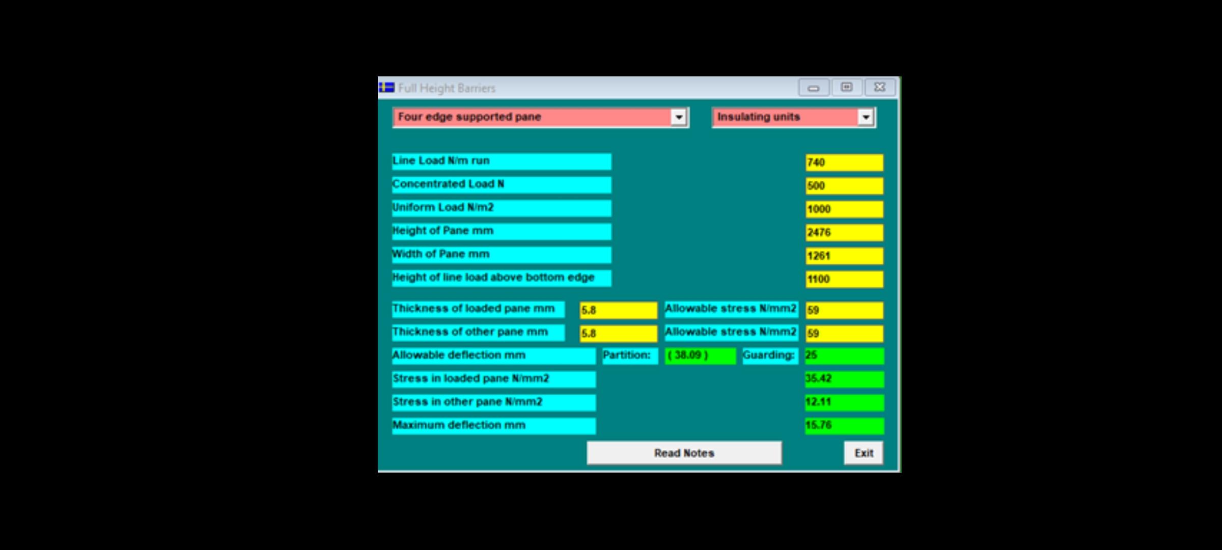

JohnMo Posted January 22 Share Posted January 22 We are in a high wind area and all our windows were subject to structural approval. Take a look at the allowable deflection - quite surprising Link to comment Share on other sites More sharing options...
craig Posted January 23 Share Posted January 23 @JohnMo Do you mind me asking what program that is? Link to comment Share on other sites More sharing options...
JohnMo Posted January 23 Share Posted January 23 20 minutes ago, craig said: @JohnMo Do you mind me asking what program that is? Sorry no clue, the window supplies provided the information to our structural engineer and I was copied on the email. Link to comment Share on other sites More sharing options...
Kelvin Posted January 23 Share Posted January 23 It looks either written in house or it’s the front end of a spreadsheet. Link to comment Share on other sites More sharing options...
craig Posted January 23 Share Posted January 23 (edited) 30 minutes ago, JohnMo said: Sorry no clue, the window supplies provided the information to our structural engineer and I was copied on the email. Thanks, I'm writing our own one at the moment in excel purely for our benefit, as getting these calcs can be a nightmare at times. 4 minutes ago, Kelvin said: It looks either written in house or it’s the front end of a spreadsheet. You'd think that by looking at it but some of these programs are still stuck in the 80s 😉😂 Edited January 23 by craig Link to comment Share on other sites More sharing options...
JohnMo Posted January 23 Share Posted January 23 Just been back through the email trail and the data came directly from the glass supplier 1 Link to comment Share on other sites More sharing options...
