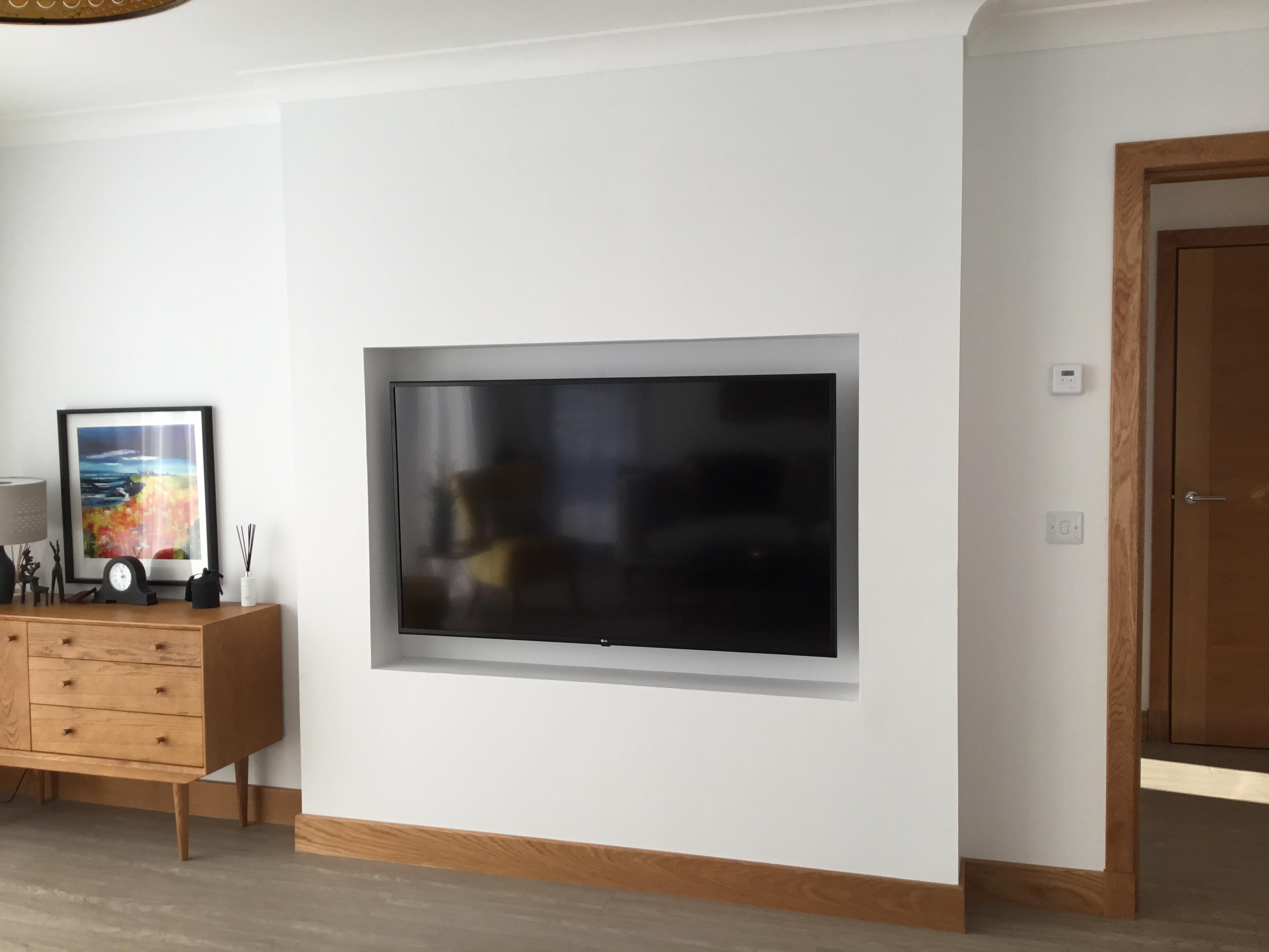

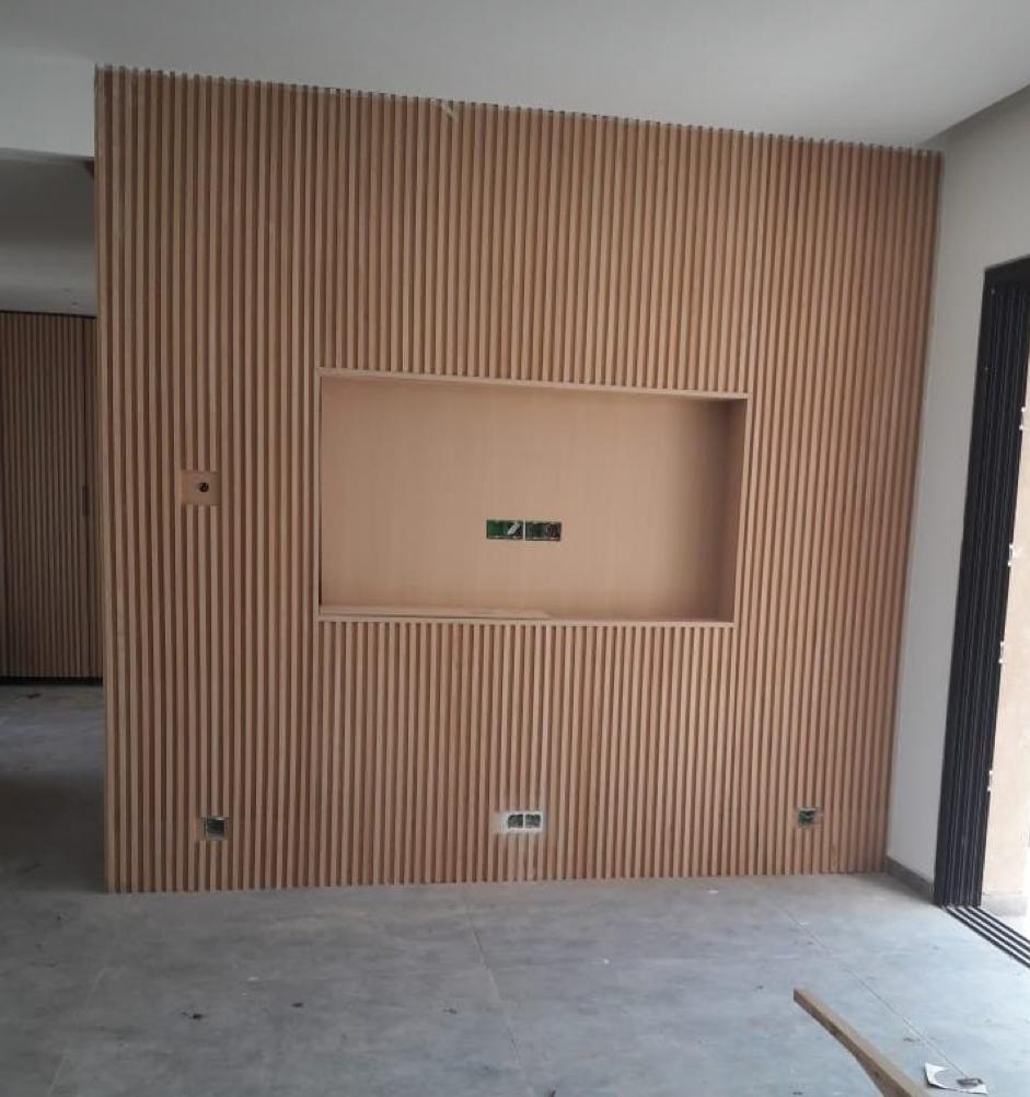

Bozza Posted January 17, 2024 Posted January 17, 2024 (edited) Ours has a 100mm gap top & bottom and 70mm gap either side. I think the idea to have a 2-3mm gap would be impracticable. For starters, your fingers would need to be 2-3mm deep to lift the thing onto the bracket unless you devised some sort of tool or clamp. Or put in a scissor type mount but trying to get that installed with such accuracy would be very difficult to maintain a precise equal 2-3mm gap all around. It would have to be a mount with precise x-y adjustment. Or some sort of suction cup for the screen. Bad idea that lifting a telly by the screen. We’ve had to access the back of our telly a few times since we installed it. secondly you’d have to replace the existing telly with something identical size if it breaks down. Thirdly any heat generated by the back of the telly. All that before the speakers issues. Though you don’t need gaps as big as ours, I think you’d regret not having a decent gap around the telly. another option may be if you like that vertical wood slat aesthetic would be to to construct a decorative screen with a precise cut out, that could hinge out like a door or a panel section that could pop off. Edited January 17, 2024 by Bozza
