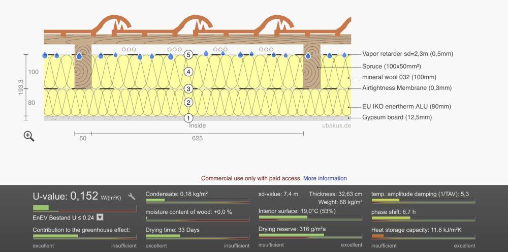

Gus Potter Posted December 18, 2023 Posted December 18, 2023 (edited) 2 hours ago, ectoplasmosis said: The rafters are ~100mm deep, with a wind-tightness membrane above, then slates. Would it be possible to full-fill between rafters with Dritherm 32, or would an airgap be necessary? Examine the detail of this closely. It does work and often design this way myself in principle but use PIR between the rafters and an insulated plasterboard under with a vapour control layer. Under the tiles is usually a breathable (wind tightness) membrane, say Tyvek, part of it's function is also to resist wind driven snow. You seem to have that. But note.. the detail shows timber on top of the rafters.. NOT OSB3 for example as it is not vapour permeable enough. Usually I do something like this with a 100mm timber sarking board with a 5.0mm gap between each board. The timber sarking provides stiffness to many of the roofs I do so as it has a structural application anyway. Ideally we want to leave a 15 - 20mm gap between the top of the insulation and the underside of the sarking. This is an unvented space, not like the 50mm vented space you have traditionally. You could partially fill with Dritherm 32 in principle so long as you leave the 15 - 20mm space above it so long as that space is breathable. Don't know how warm it will be though so best check. I would also check the location of the air tightness membrane as you could get condensation on the underside of that... bad news. The bottom of the joists will be cold (they are a repeating bridge) so that is where you'll get bands of condensation. I would put the vapour control layer just above the plasterboard. Edited December 18, 2023 by Gus Potter
