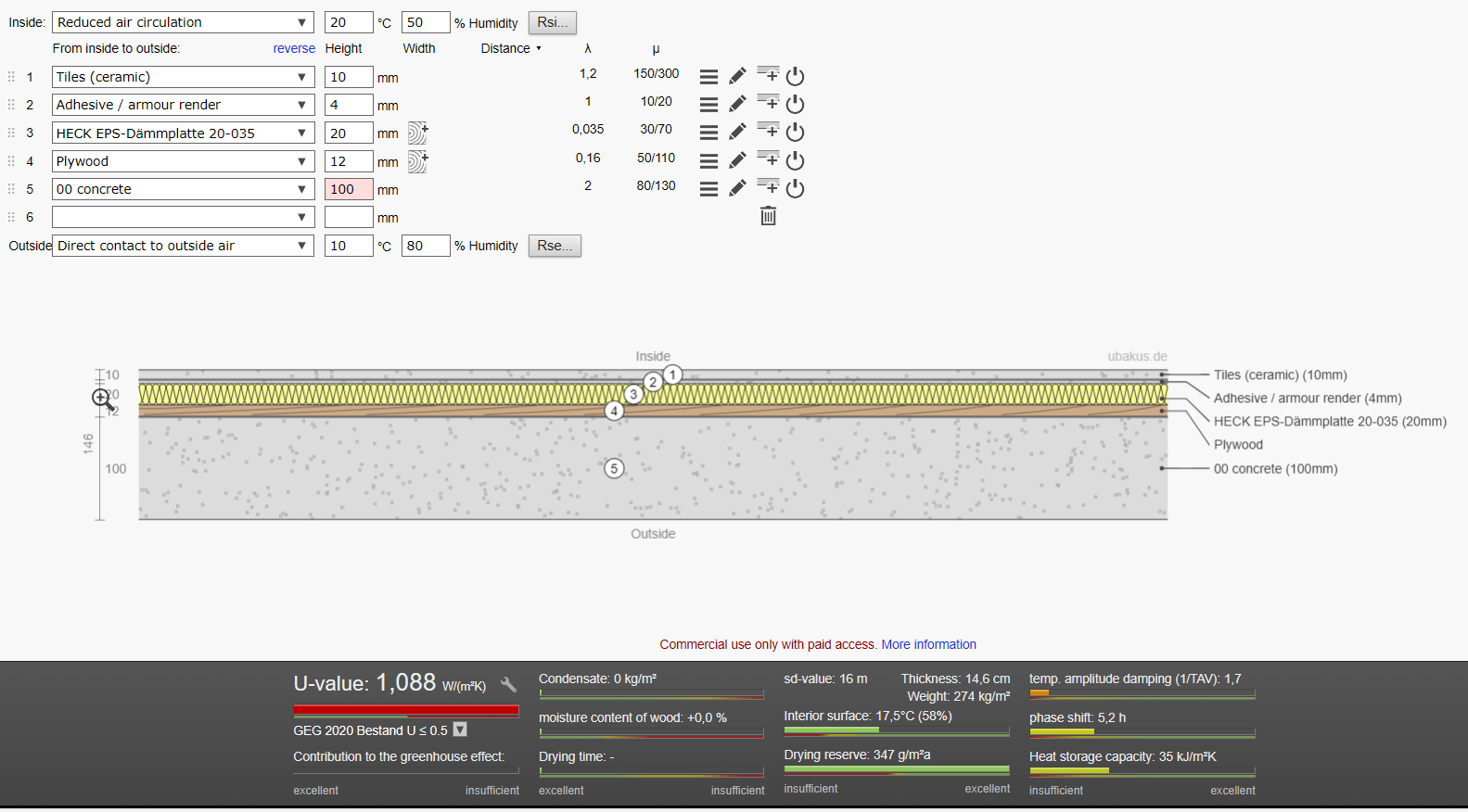

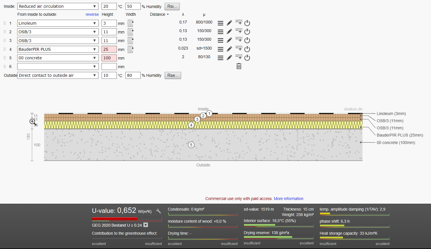

Iceverge Posted December 5, 2023 Share Posted December 5, 2023 (edited) Here's a look at the Wunda system with 12mm ply. 46mm thick, That U value isn't the whole story because where the pipe tracks are there's almost zero insulation under them and they're the greatest point of heat loss. Here's my proposal. Sand cement slurry to fill any large gaps in block and beam. Self levelling compound to level out any big dips. 25mm PIR, all joints tightly fitted, foamed and taped with aluminium tape. Foamed with IL330 or taped to walls for airtightness. Float 2 x 11mm OSB layers , joints crossed, screwed and glued. Then finish with lino or LVT. Total 50mm thick. Much cheaper than the Wunda system and 40% less heat loss. No specialist materials and more solid to boot. Alternatively replace one layer of OSB with T&G engineered flooring glued down. You may need to lay the OSB on a diagonal to avoid any joints lining up. For the heating I would opt for radiators throughout. Easier to balance for this application and with suitable floor coverings you won't suffer from cold feet. Make them as large as you can to future proof for an ASHP. Edited December 5, 2023 by Iceverge 1 Link to comment Share on other sites More sharing options...
