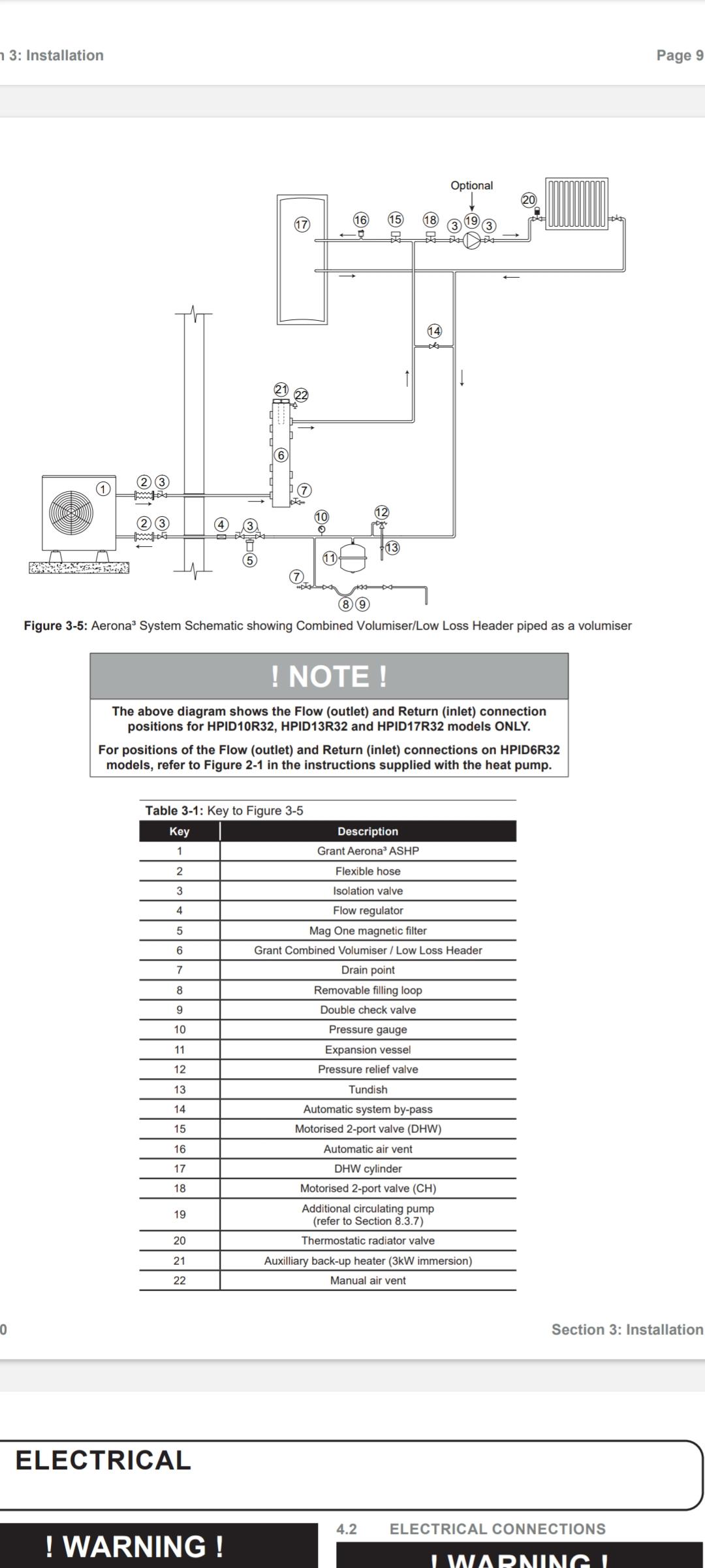

Andy T Posted January 17 Author Share Posted January 17 On 15/01/2024 at 17:49, JohnMo said: The Grant unit can be installed in two ways a buffer/low loss header configuration, buffer gives hydraulic separation between heat and UFH - you do not want this configuration. The other is a system volumiser - a buffer is installed in the supply piping only. This is ok. Ideally you want, UFH as a single zone, no buffer, no mixer and no additional pumps, just run on weather compensation. Heat pumps have a minimum system volume as long as your system configuration complies no need for a buffer. But installers want to install in buffers I can see on the quote it states "we have allowed for all associated pipework for the connection and fitting of the Grant external unit and cylinder valves, pumps and volumizer/buffer tank". It is to supply and fit a Grant Aerona 3 Air source heat components: 1 No. 10kw R32 Inverter Driven HPID10R32 unit 1 No. installations pack A (HPIDR32PACKA) 1 No. UK Elite High performance 250L cylinder 1 No. Grant Mag 1 filter Link to comment Share on other sites More sharing options...
Andy T Posted January 17 Author Share Posted January 17 On 15/01/2024 at 17:30, sharpener said: Get them to draw a diagram of the system they propose and explain what all the components are for. Not so you can find out for yourself, but so you can tell if they know themselves. Thank you. Good idea. I will ask for a diagram Link to comment Share on other sites More sharing options...

JohnMo Posted January 17 Share Posted January 17 1 hour ago, sharpener said: Pack A includes a small one for installation indoors. Looks reasonably appropriate to me though you might get away without one at all. Unfortunately it's instructions give two ways to install, low loss header with hydraulic seperation or volumiser without hydraulic seperation. It really best to install without hydraulic seperation, to have lowest possible flow temperature. So clarity required. So layout should look like this 2 Link to comment Share on other sites More sharing options...

PhilT Posted January 19 Share Posted January 19 On 17/01/2024 at 15:40, JohnMo said: It really best to install without hydraulic seperation, to have lowest possible flow temperature. I'm wondering if this (see photo) gets you the best of both worlds. The LLH (vertical black cylinder - capacity c. 2 litres) is connected such that only the primary flow (right top/bottom) can loop back around into the primary circuit. The LLH secondary return (bottom left is sealed off, instead rejoining the primary circuit return from the LLH further back downstream to the heat pump, thus eliminating any mixing of secondary return with primary feed. Link to comment Share on other sites More sharing options...
JohnMo Posted January 19 Share Posted January 19 Think if you want zones or you don't have enough system capacity the Gant volumiser or the attached Kensa scheme are better. Hydraulic seperation just add inefficiency, as it's too easy to have a heat imbalance Link to comment Share on other sites More sharing options...
