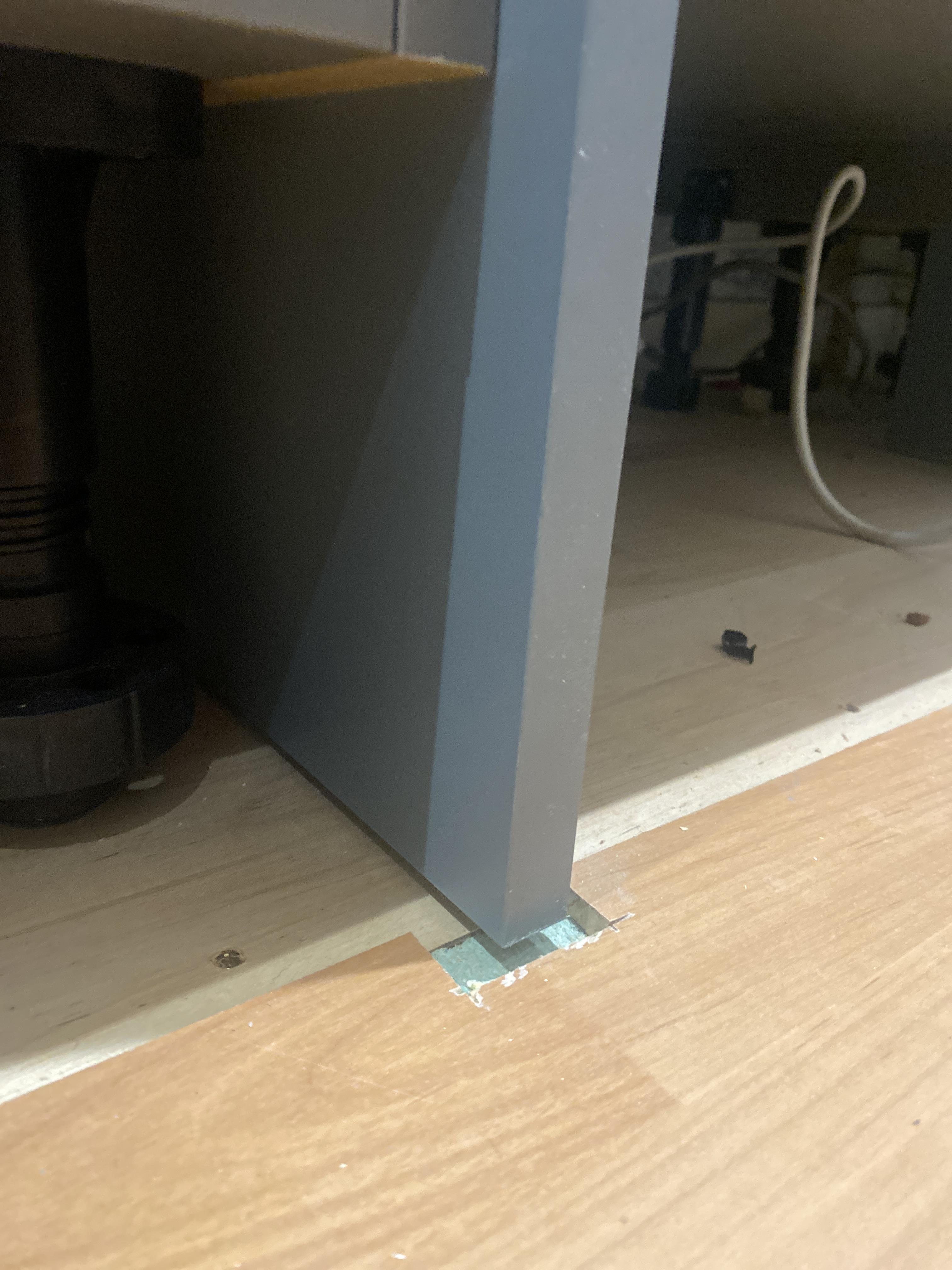

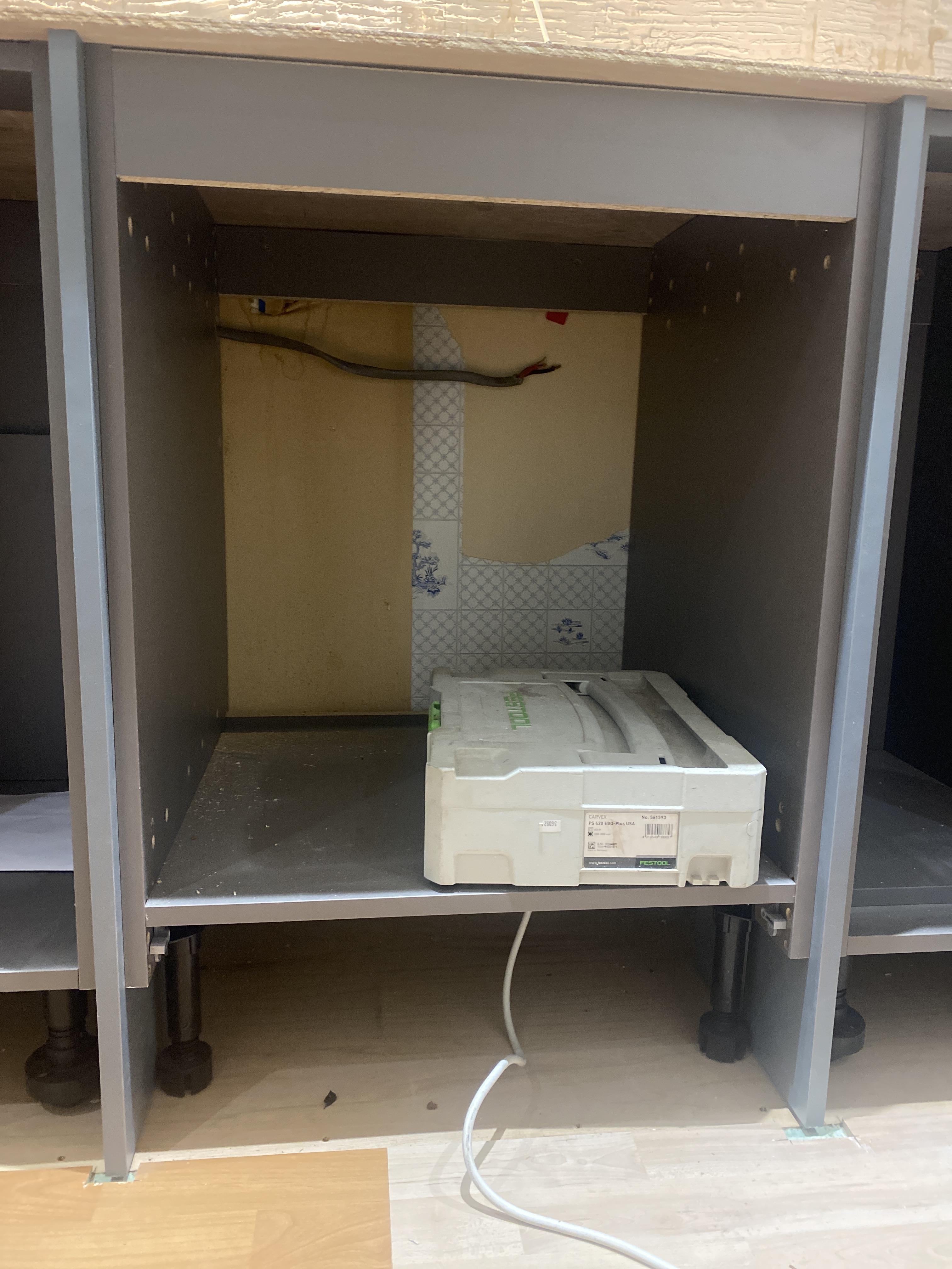

Logan Posted December 3, 2023 Posted December 3, 2023 I’m looking to install herringbone LVT click flooring. How do I fit it under these decor pieces that go to the floor? My kitchen fitter has installed them to a height so they will land sitting on the finished flooring (so I’ll be working with a gap of 5.5mm underneath once I remove the existing laminate floor). DIY job or PRO?

joe90 Posted December 3, 2023 Posted December 3, 2023 You have to start the flooring from that side really, tucking the first ones under the end panels, yes herringbone can be tricky to get right (but looks good). https://www.factory-direct-flooring.co.uk/advice-centre/how-to-lay-herringbone-flooring?gclid=Cj0KCQiA67CrBhC1ARIsACKAa8RzHQp3M_P9FKKj4_nHJNJBlj8FpXALzR_8bYU67-ar8K0QlLNbzIAaAmNxEALw_wcB
eandg Posted December 3, 2023 Posted December 3, 2023 On 03/12/2023 at 12:20, Conor said: We had a floor fitter do our herring bone. No way would I have attempted it. Requires skill and patience in bundles. I'll take a look at how he did around our gables. Expand Same. It didn't look too hard but that's the fitter's skills and experience and the finish was spot on. Wish I had him on a day rate as he did very well and rattled through it - but it'd easily have taken me three times as long and with a lot more waste.
oliwoodings Posted December 3, 2023 Posted December 3, 2023 It's too late now, but another way to do it would have been to lay the floor first (after marking up where the plinths will eventually sit), put floor protector sheets down and then install the kitchen. Did this recently on a project, worked well.
