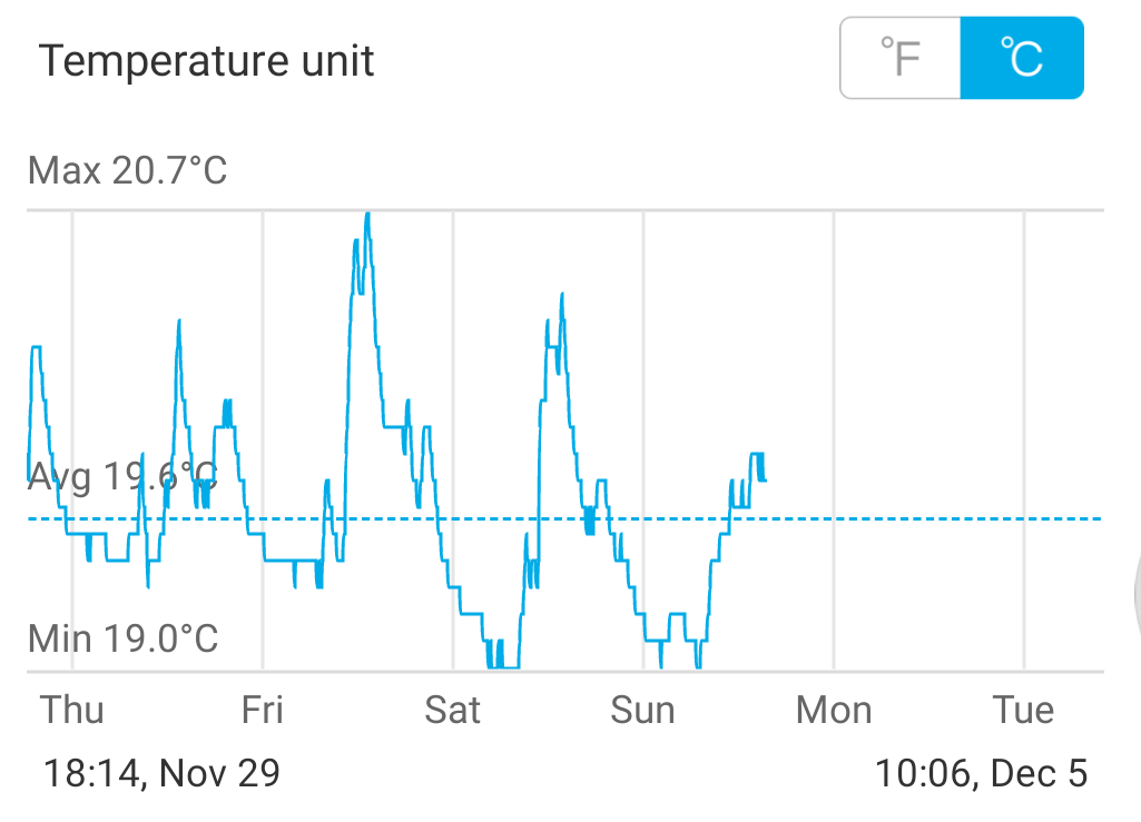

Beelbeebub Posted December 3, 2023 Posted December 3, 2023 2 hours ago, HughF said: Not sure what the physical layer is, I think it’s something custom, but it’s designed to re-use old thermostat wiring. quite a few master and slave shields/interfaces are available. I might grab one. The plan would be to read the target flow temperature, calculated by the load compensating opentherm thermostat, from the thermostat. Convert this into a modbus flow temperature packet for the target heat pump, and then send it to the heat pump. A web front end (it would connect to your home wifi) would allow for customisation/selection of the heatpump from the list of those supported. I'm fiddling with my UFH (boiler driven) - at the moment it is just on/off from the thermal store at a set temp. I'm planning on measuring external temp (via my MHRV intake), and doing a simple linear weather comp to get the desired delta T between the floor slab temp and the desired internal temp. Its then easy to calculate the desired slab temp (thermostat setting plus calculated delta T). The controller then activates the UFH pump until the slab return temp is to the target. When it is, it shuts a valve that controls the hot water input into the mixer, but keeps the pump circulating to measure the slab temp. Rinse repeat

Beelbeebub Posted December 3, 2023 Posted December 3, 2023 3 hours ago, JohnMo said: Why not do away with the conventional UFH mixer and just use a 3 port mixer with actuator to give you full control of the flow temperature to the floor. A normal UFH mixer always mixes a percentage of return water into the hot water. A 3 port mixer doesn't. Reuse the pump and top adapter piece to the manifold. Instead of running the pump 24/7 could a simple room thermostat be used to give a feedback loop? Or run a pump sniffer cycle for 10 mins an hour. I might, but it requires a load more plumbing. What I actually have is a standard thermal actuator (a UFH zone valve) plumbed into the return from the 4nport mixing valve for the UFH. This is historical to preven some thermosyphon from my thermal store to the UFH. Currently it is plumbed in parallel with the UFH pump. When the thermostat calls for heat, the pump is activated and the zone valve (eventually) opens. Until that happens the UFH water just recirculates round the slab. As the valve opens the mixing valve starts to blend and the flow temp rises to whatever it's set to. I've noticed that I can actually control the flow temp to any point between slab return temp and the mixing valve setting by opening the zone valve fractionally. As the valve moves slowly, my idea is to measure the flow temp and then "blip" the thermal actuator on and off to hold it at the intermediate opening point that gives the desired flow temperature.
Beelbeebub Posted December 3, 2023 Posted December 3, 2023 The pump will only run when the room temp (measured by a probe in the MHRV room extract manifold) is below the set point. Eventually some logic will be put in so that continually running the pump whilst the slab return is at target temp (which is taken to indicate the target slab temp is too low to maintain the desired temp) will trigger a slight uplift in the target slab temp. (Maybe - if I can be arsed to do all the work)
Beelbeebub Posted December 3, 2023 Posted December 3, 2023 The big thing slowing me up is that the current system is very simple, uses no custom hardware and actually works pretty well. Here is the internal temp track for the last few days. Realistically, i'm chasing marginal gains. (But it is a fun exercise)
