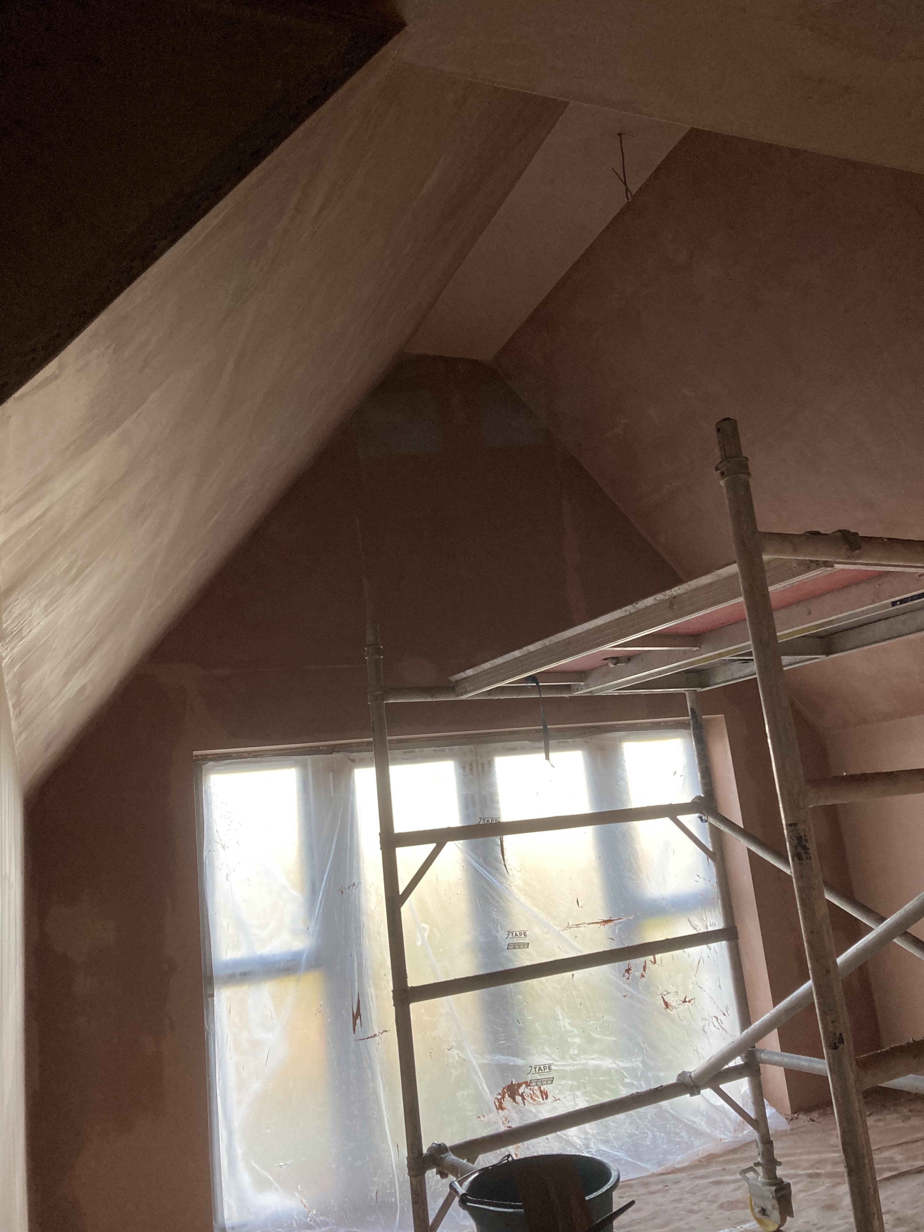

nod Posted November 30, 2023 Share Posted November 30, 2023 I managed to get a free day today to skim the bedroom and dressing room out Weathers not ideal But it’s a start 3 Link to comment Share on other sites More sharing options...

Canski Posted November 30, 2023 Share Posted November 30, 2023 Do you worry about frost Nod when plastering in these cold temperatures ? I’m planning on plasterers for mid January. Link to comment Share on other sites More sharing options...
nod Posted December 1, 2023 Author Share Posted December 1, 2023 11 hours ago, Canski said: Do you worry about frost Nod when plastering in these cold temperatures ? I’m planning on plasterers for mid January. I have a gas blower that I’ve set on the ground floor well away from the the plaster That I switch on for ten minutes before each mix We are currently plastering a site for WD Last year they correctly stated 4 and residing outside temperature This year they have revised this to 2 above INTERNAL temperature No heaters allowed H&S 😂We are adding excel orator to each mix Would I do this on my own house Absolutely not The problem isn’t so much now It’s a couple of months down the line when the heating goes on Getting back to yours Get the internal temperature up to 5+ and you will be fine 1 Link to comment Share on other sites More sharing options...
Mr Punter Posted December 1, 2023 Share Posted December 1, 2023 1 hour ago, nod said: We are adding excel orator to each mix I have not seen this added to plaster before, just cement based mixes. Link to comment Share on other sites More sharing options...
