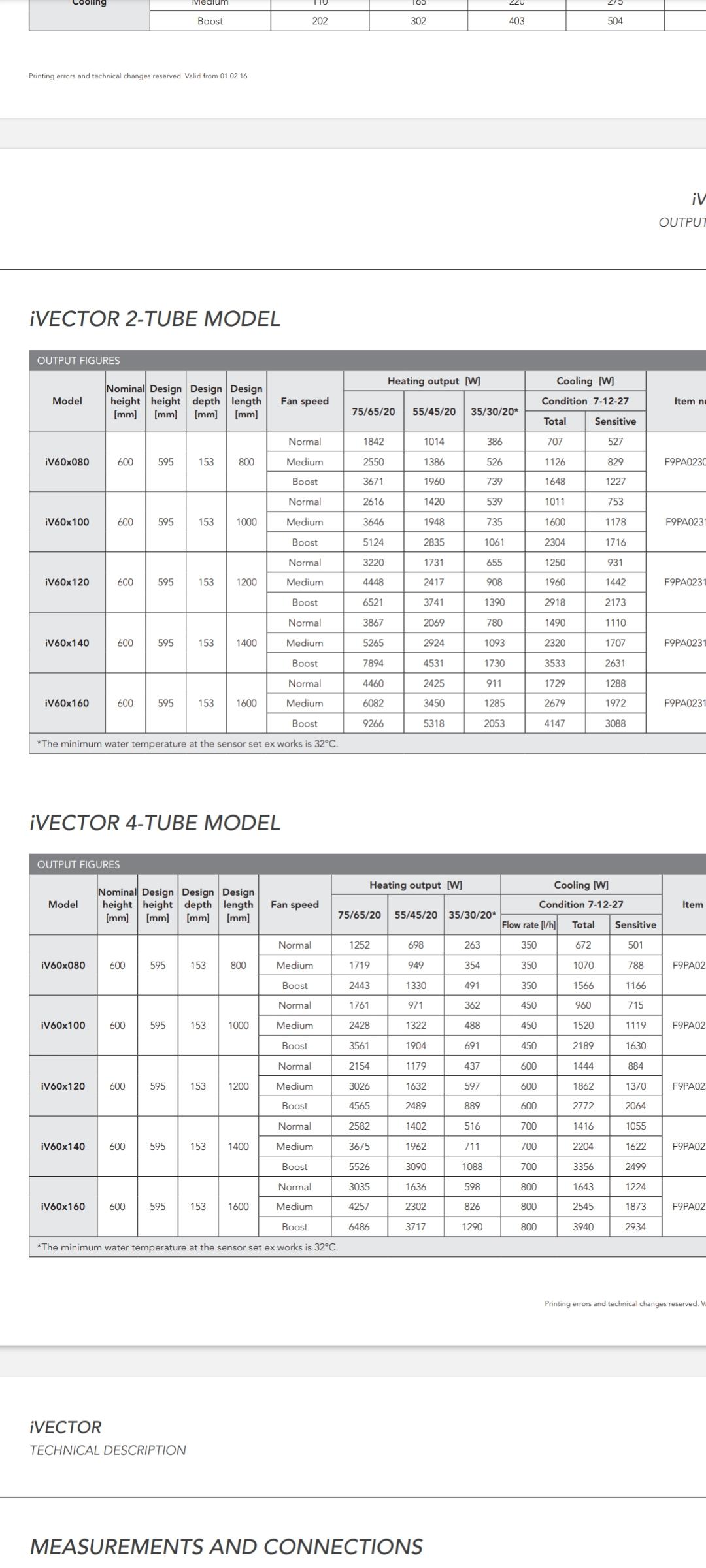

Beelbeebub Posted January 9, 2024 Share Posted January 9, 2024 9 minutes ago, JohnMo said: So garden room UFH, although just about works, really isn't much use at heat pump temperatures. So a bit of research later, have purchased a fan coil unit. A Myson iVector MK2. Bargain from eBay, about a 1/3 the normal price. It is a 4 pipe fan coil, so has two heat exchanges, one for heating and one for cooling, I will pipe both heat exchanges to a single pipe in a parallel. This should increase heat transfer area and hopefully be able to run slightly cooler. Fan coils come with a temperature sensor, and the normal set point is 32 degrees for the fan to start. So the water has to be above 32 degs to get the heater running. But the Myson one has an adjustable set point, so should simplify setup. So far have mounted it on the wall. Intend to use the UFH manifold to feed the fan coil, with the Salus actuators to manage a 7 deg dT. Heater on wall, with cover off and on Will be very interested in outcome as I am trying a similar thing with the reverso unit to replace a failed UFH system though the system currently gas powered. Link to comment Share on other sites More sharing options...

JohnMo Posted January 10, 2024 Author Share Posted January 10, 2024 44 minutes ago, SteamyTea said: More than a through the wall ASHP then. A bit bonkers really, good job I only paid a fraction of that. With high water temp it will chuck out 6kW, something a through wall would never do. Link to comment Share on other sites More sharing options...
SteamyTea Posted January 10, 2024 Share Posted January 10, 2024 1 minute ago, JohnMo said: With high water temp it will chuck out 6kW, something a through wall would never do. Enough to heat a sauna, most domestic ones are only 4.5 kW, though they do chuck out air at a couple of hundred Celsius. Link to comment Share on other sites More sharing options...
JohnMo Posted January 10, 2024 Author Share Posted January 10, 2024 Output chart for the various sizes and different flow temperatures Link to comment Share on other sites More sharing options...
