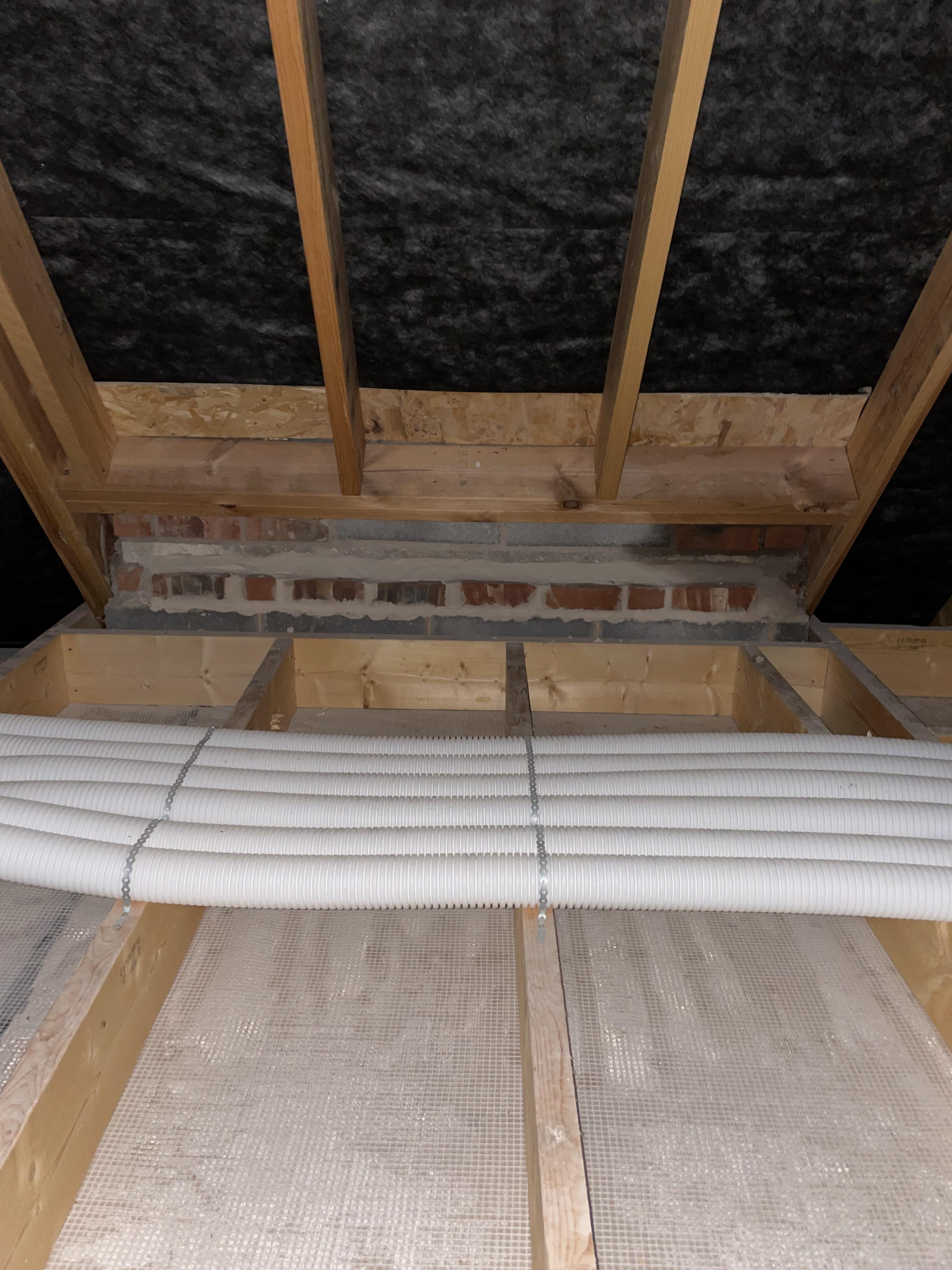

Thanks @MikeGrahamT21 I am going to try and get it insulated this week
I haven’t got a loft hatch at the minute and also found a leak on my chimney in the loft so I am thinking these maybe the cause of moisture getting in there
I turned my de-humidifiers on last night at 9pm and got to the house at 8am and they had pulled about 4L out
Consider taping a piece of VCL on the loft door hole to stop it going up, just as a temp measure, and get that heating on full whack, windows on vent, dehumidifiers running max, you’ll get there!!
