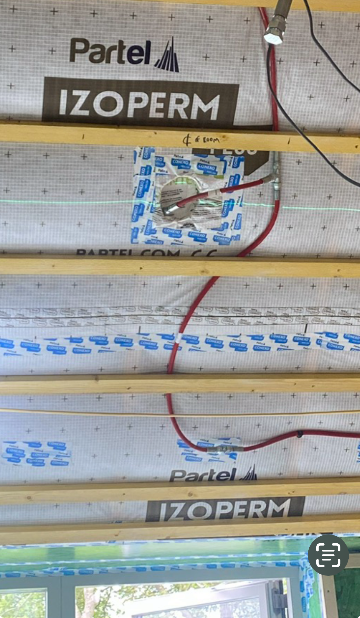

MattD Posted November 26, 2023 Posted November 26, 2023 We're in Wales, meaning all new builds must have a sprinkler system. We're designing a two-bed timber framed cottage with one-and-a-half floors (bedrooms in the attic space). Sprinklers are required in bedrooms, meaning we will need to allow for the sprinkler pipes in the ceiling service void. Since the bedrooms are in the attic (roof space), service void space is limited. I was under the impression that a ceiling service void is typically 25-75mm: 25 if you only plan on running cables, and 50 or even 75 if you plan on running water pipes too. Just to be on the safe side, I thought I'd contact the sprinkler company we're thinking of using to ask them how much space they need. They said 120mm (as a minimum!) Does this sound right? Can anyone else who has built for a domestic sprinkler system confirm if this much space is really necessary? If we make our ceiling service void that large we would effectively need to box in the entire timber frame, which would be a real shame. I'm not entirely convinced that the sprinkler company really understood what I was asking about, but thought it worth asking here in case anyone else has had experience with this. They said the sprinkler heads require 120mm.
Stratman Posted February 6 Posted February 6 Hi There Looks like you didn't get any responses to your query. Did you get it resolved in the end? We will have vaulted ceilings upstairs and I just came across similar advice from the sprinkler company - actually 130mm void. Also in Wales by the way. The TF supplier is installing only 25mm service battens below the VCL to the underside of the roof joists. Does anyone out there have any experience or suggestions?
Nickfromwales Posted February 6 Posted February 6 19 minutes ago, Stratman said: Hi There Looks like you didn't get any responses to your query. Did you get it resolved in the end? We will have vaulted ceilings upstairs and I just came across similar advice from the sprinkler company - actually 130mm void. Also in Wales by the way. The TF supplier is installing only 25mm service battens below the VCL to the underside of the roof joists. Does anyone out there have any experience or suggestions? Yup. Done a few with both types (sprinklers and mist) of automatic fire suppression systems. This was what I did on an MBC PH TF client project. I made top hats out of membrane and tape, using an off cut of the 125mm duct (or something round etc) and then set them in to give the required depth. Did the same downstairs when I did the prep for the cinema room speakers to go in (Dolby Atmos ones in the same type of ceiling, under the balcony). Easy enough to sort without adding more battens, if you know beforehand what’s going in etc. I got MBC to specify holes in glulam and steel beams to allow services to get about the superstructure with ease. Makes 1st fix a breeze!
Nickfromwales Posted February 6 Posted February 6 @Stratman, have you asked if you can go for a mist system instead?
Stratman Posted February 6 Posted February 6 50 minutes ago, Nickfromwales said: I made top hats out of membrane and tape, using an off cut of the 125mm duct Fantastic - thank you! And I see the pipes are just tucked over the battens below the VCL.

Nickfromwales Posted February 6 Posted February 6 @Stratman Mist system saves a load of money on tanks / pumps / bigger incoming cold mains, and only runs for a set 45 mins iirc. The equivalent of you filling a bath and tipping it over, and that's the sum of the water damage vs a sprinkler which will devastate the property by flowing continuously until discovered.
Stratman Posted February 6 Posted February 6 Thank this is really useful. I will ask BCO about mist system as at the moment the sprinkler company is concerned that water pressure will be inadequate so will need a pump set and tank to the tune of several more grand cost.
