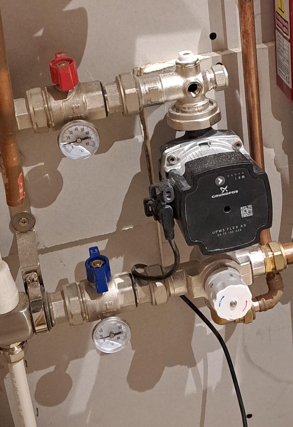

dnb Posted November 18, 2023 Share Posted November 18, 2023 (edited) Now it's getting cold and I am still a regular member of house not finished anonymous I have installed a Willis heater setup for my underfloor heating using old bits of plumbing from the many boxes of spares I have. All good so far, but I find that I have lost a small blanking plug that goes in the mixer unit's return piece. I assume it is for a temperature probe or similar, but I wasn't going to bother for the moment. (The UFH is intended as a backup heat source for the house - the "real" heating is via ducted air, but I am a while away from commissioning this but it seemed silly to not put pipes in the screed when the opportunity presented itself.) Here is a photo of the offending hole in the UFH assembly. I believe it might be 7/16" UNF but Google suggests this is not a common plumbing part size - mostly returning hits on brake pipe flares and similar automotive things (all my cars have metric brake lines, so no help here). It could also be M12, but this doesn't feel a particularly good match with the thread gauge and as one would expect the entire stock of M12 bolts in the house have all gone on their annual holiday to the back of the extremely full shed. Does anyone know for sure? The local plumbing places don't have much that is non-standard in stock and I would prefer to not have to buy anything big to get this to work. Thanks! Edited November 18, 2023 by dnb Link to comment Share on other sites More sharing options...

dnb Posted November 18, 2023 Author Share Posted November 18, 2023 2 minutes ago, Conor said: I bet if you unscrew one of the pressure gauges, How much? Want to bet that I haven't done this and found they don't fit already? (The gauges in the picture are temperature, and push in to holes in the manifold) I tried the pressure gauge from a couple of spare PRVs and both were too small (one was 3/8" BSP and the other was 1/8" BSP) and neither worked. 3/8" BSP OD is around 16mm so this is hardly surprising. And I've already established that 1/4" BSP isn't right. I have an extremely large box of plumbing spares from my mis-spent youth and from various parent's estate clearances. I am most surprised there is nothing in the magic box that works. 1 Link to comment Share on other sites More sharing options...

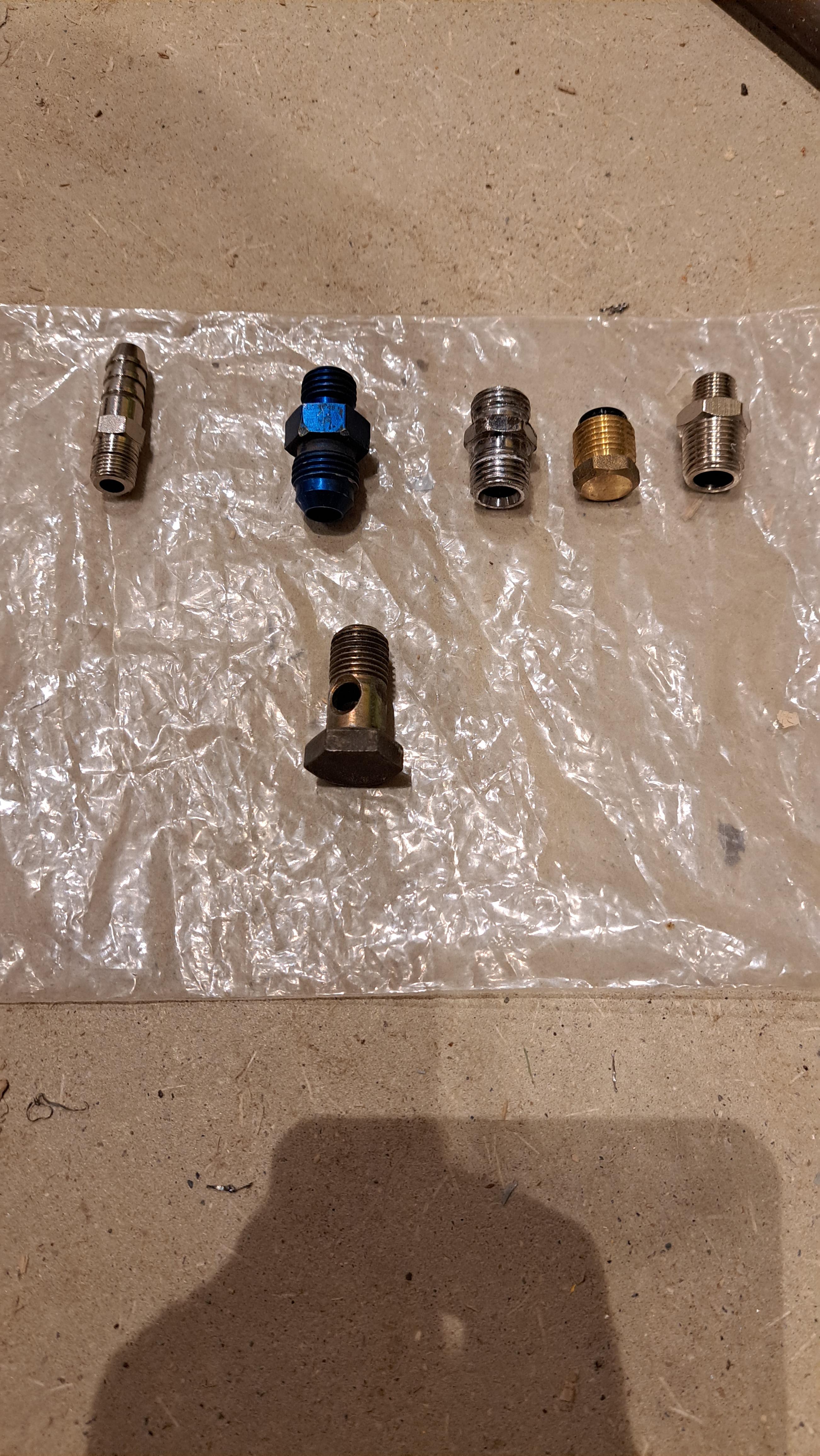

dnb Posted November 18, 2023 Author Share Posted November 18, 2023 From left to right we have 1/8 bspt, JIC -6AN with M12, 1/4bpst to npt, 1/4bppp and 1/4bspt to 1/8 npt. None fit. On the bottom we have a random banjo bolt from the brakes of one of my cars. I can't recall which. This fits well but doesn't help block the hole up! Link to comment Share on other sites More sharing options...
dnb Posted November 19, 2023 Author Share Posted November 19, 2023 Got some better measurements now I have a long bolt that fits. Seems I mis-counted the threads in the hole (off-by-one error I think... ) so it's very close to 20TPI. Major diameter is still as before as between 11 and 12mm. So I am left with 2 likely alternatives: M12 1.25mm pitch or 7/16" UNF. The banjo bolt appears to be M12 and is a little slack in the manifold, but nothing PTFE tape can't fix, but the 7/16" UNF is has a slightly bigger diameter and over 5 threads 20 TPI vs 20.3 TPI makes little difference. Why would anyone make plumbing parts with unusual threads? It's just irritating. I found a 1/4" BSPT thread tap in one of my old tool boxes. I think I know where this is going. 🤪 Link to comment Share on other sites More sharing options...
