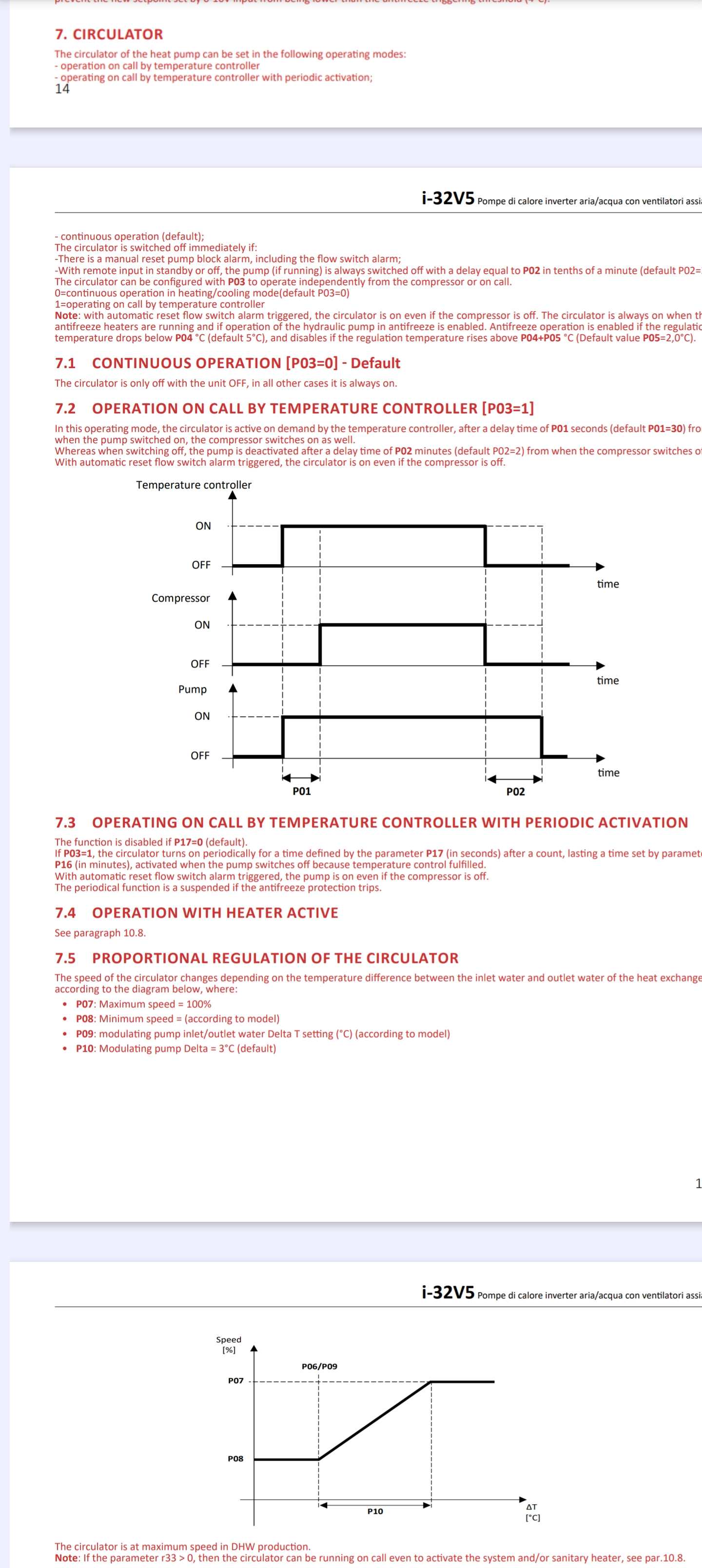

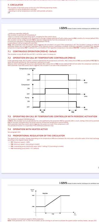

I assume you are just running the pump in an on/off form. Any thoughts about speed control? Reason for mentioning is when I've thought about what I might want to do, if it ever happens, is that the pump might serve as a useful way to distribute heat/cold between rooms to try and keep things equalised despite some rooms having higher heatloss/gain than others.
Edit: Clarification, idea being that to do that equalisation you'd likely want to run the pump more than for a short period every 40 mins. Running slow for longer might be better than more frequent full on pulses. I've done no maths on this as don't want to start detailled work until I actually have a project.
Edited by -rick-
5 minutes ago, -rick- said:
Good result.
The controller does all the on off stuff, the pump also run variable speed, more so in heating than cooling. It has various control strategies for the circulation pump. So it's currently on periodic running and proportional regulation.

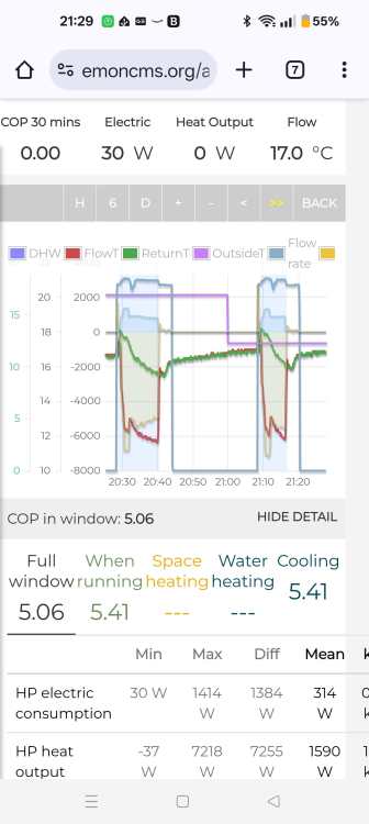

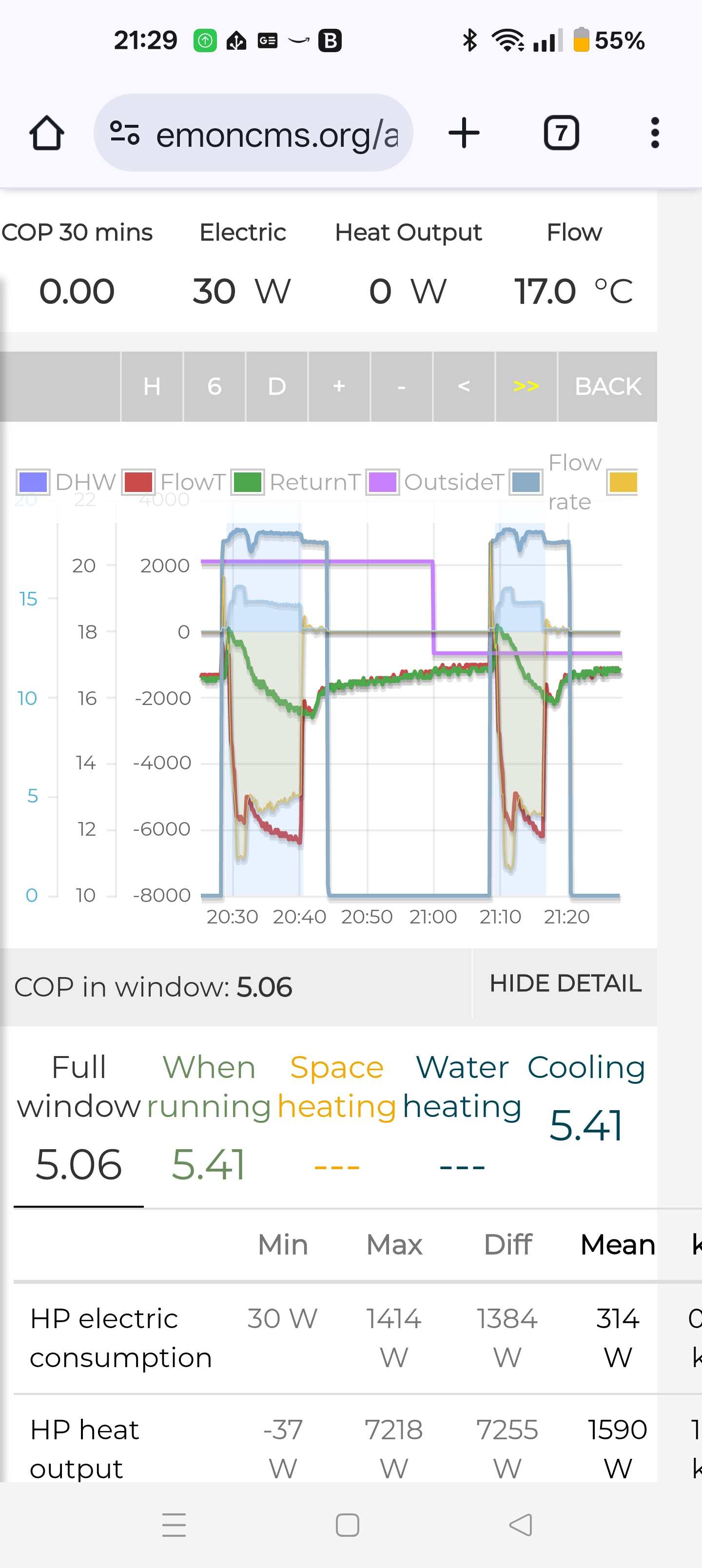

An hour or so of the data from the heat pump monitor
Screenshot_2025-07-09-21-29-11-50_40deb401b9ffe8e1df2f1cc5ba480b12.thumb.jpg.733cc2a5e168c8cedb530258741e7862.jpg
The flow rate is the light blue line. Speed control works trying to control dT.
My main reason for running 24/7 was to distribute heat evenly, but the intermittent nature doesn't seem to affect the way the house feels. So at the moment I see no reason to pay for it to run it.

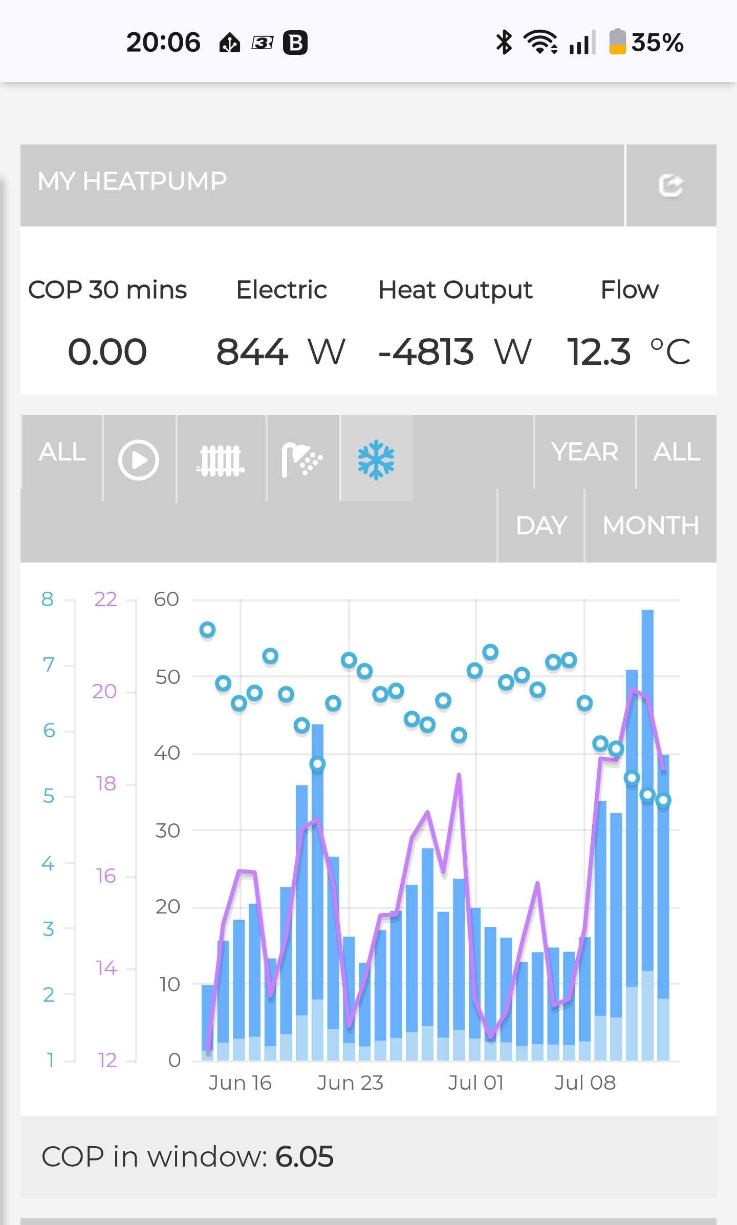

So over the last 5 days, things have remained stable with daily CoP. Generally sitting at around 4.8 to 4.9. the dots on the graph are the daily average CoP. The purple line average daily temperature.  The chart below is for all running and standby etc for cooling and DHW, including powering a WiFi extender, all monitoring stuff.
Screenshot_2025-07-13-19-44-13-02_40deb401b9ffe8e1df2f1cc5ba480b12(1).thumb.jpg.5c1df14f629e84b13fd7651bc8effa6b.jpg
This what the chart looks like if I only include the CoP for cooling while running and no standby.
Screenshot_2025-07-13-20-06-01-41_40deb401b9ffe8e1df2f1cc5ba480b12(1).thumb.jpg.bcf4b3fdaf62ff5b21b058d5a2ac3fa8.jpg
So even though the CoP while cooling is lower than before, it's been the hottest day time temps so far this year at around 30 Deg.

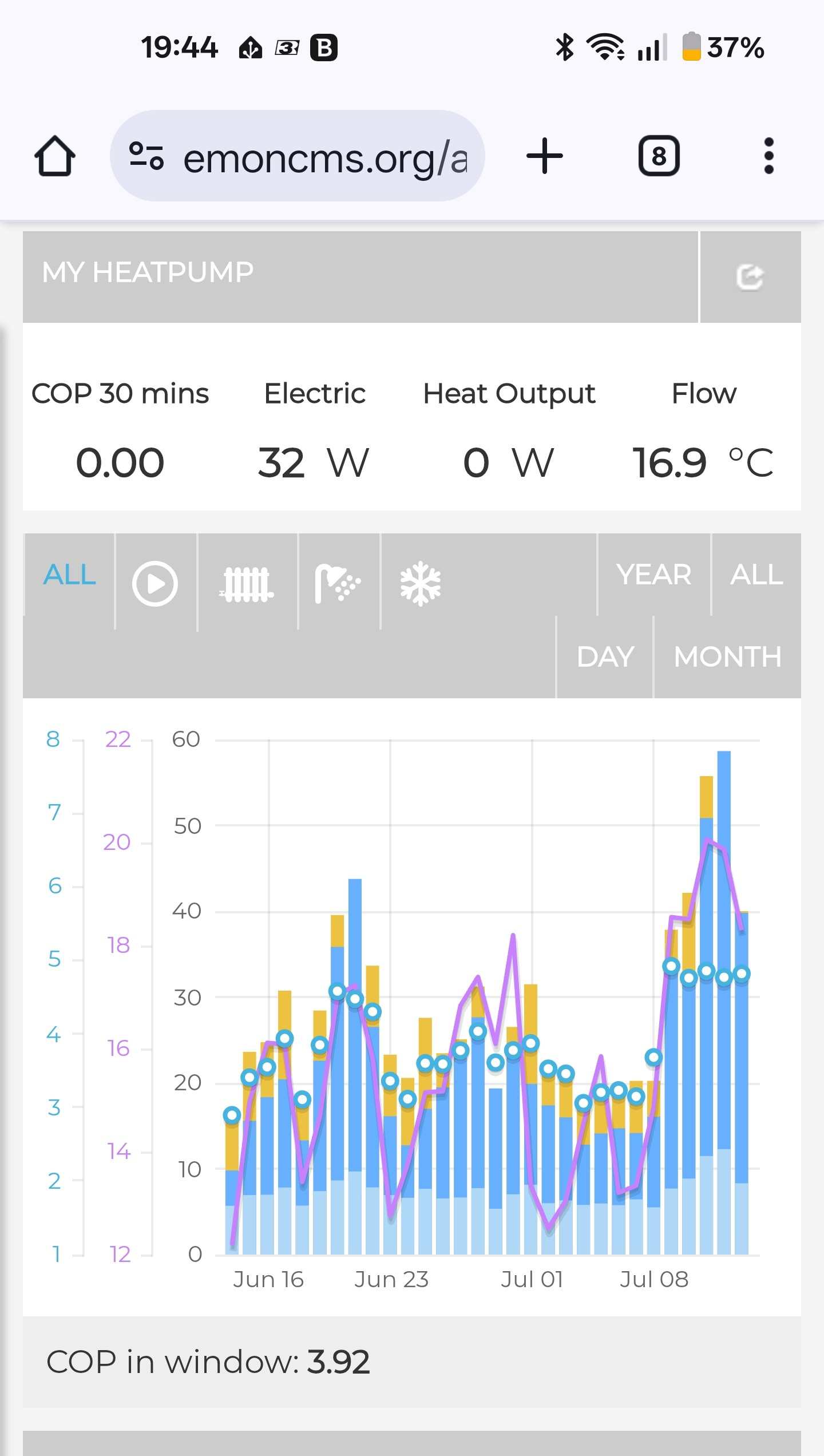

After the minor change to circulation pump settings and leaving a week to settle in, thought I would check the heat pump monitor SCoP leader board to see how my system looked compared to others. So currently sitting 9th overall based on 7 days of figures
Screenshot_2025-07-17-08-23-24-29_40deb401b9ffe8e1df2f1cc5ba480b12.thumb.jpg.a6b627a3b3372c5da9e04ccb6ea2b11e.jpg
Mine is Maxa i32V5.
I wonder how many on the list are actually doing cooling aswell? Done well tweaking your settings.
