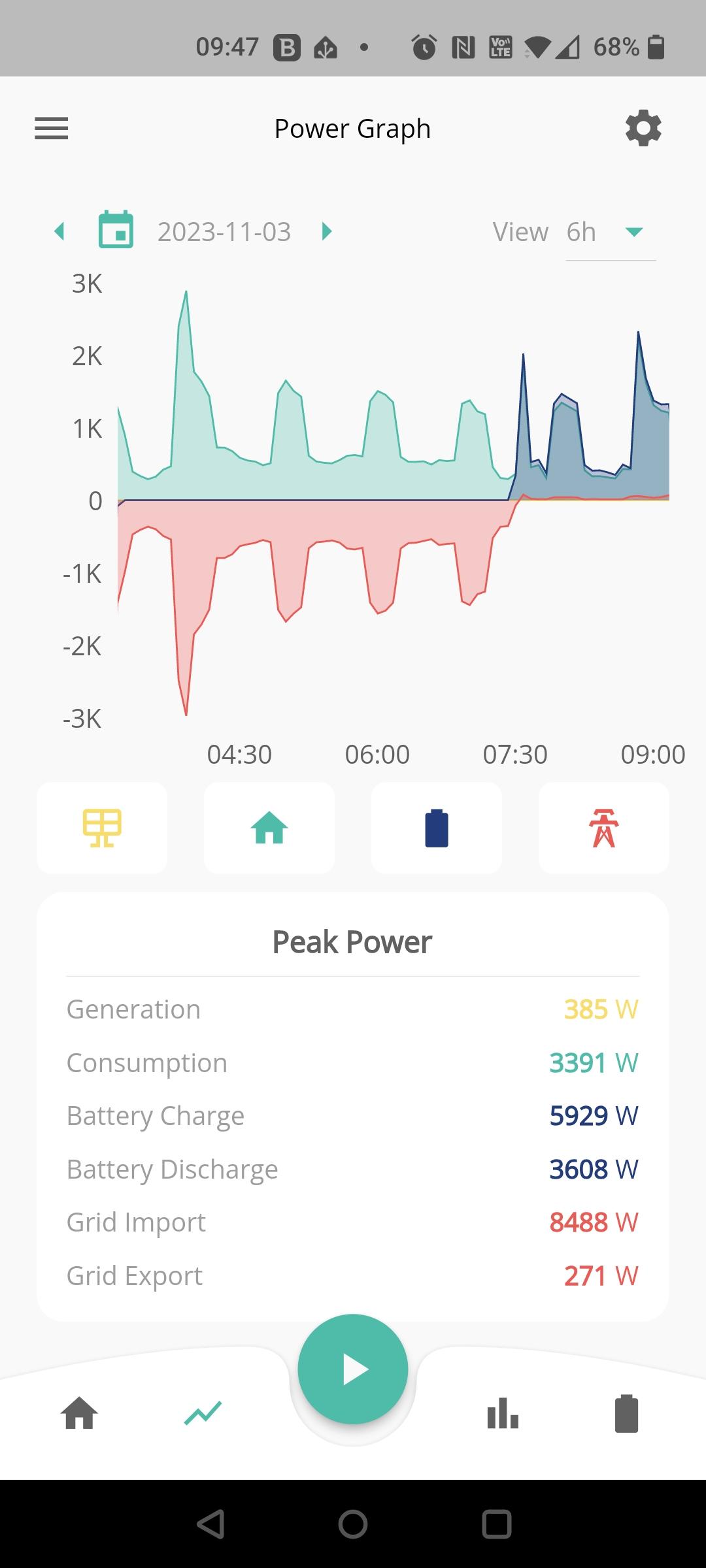

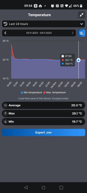

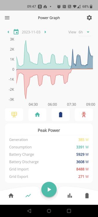

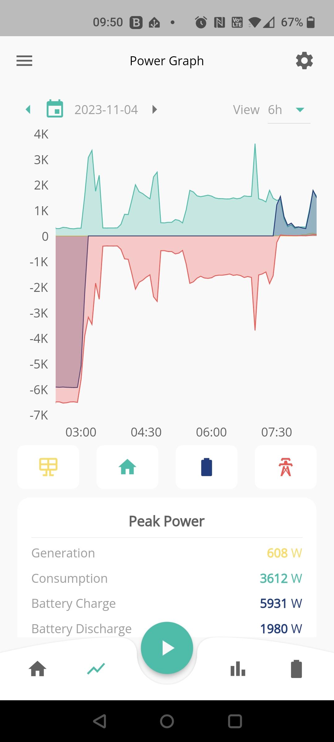

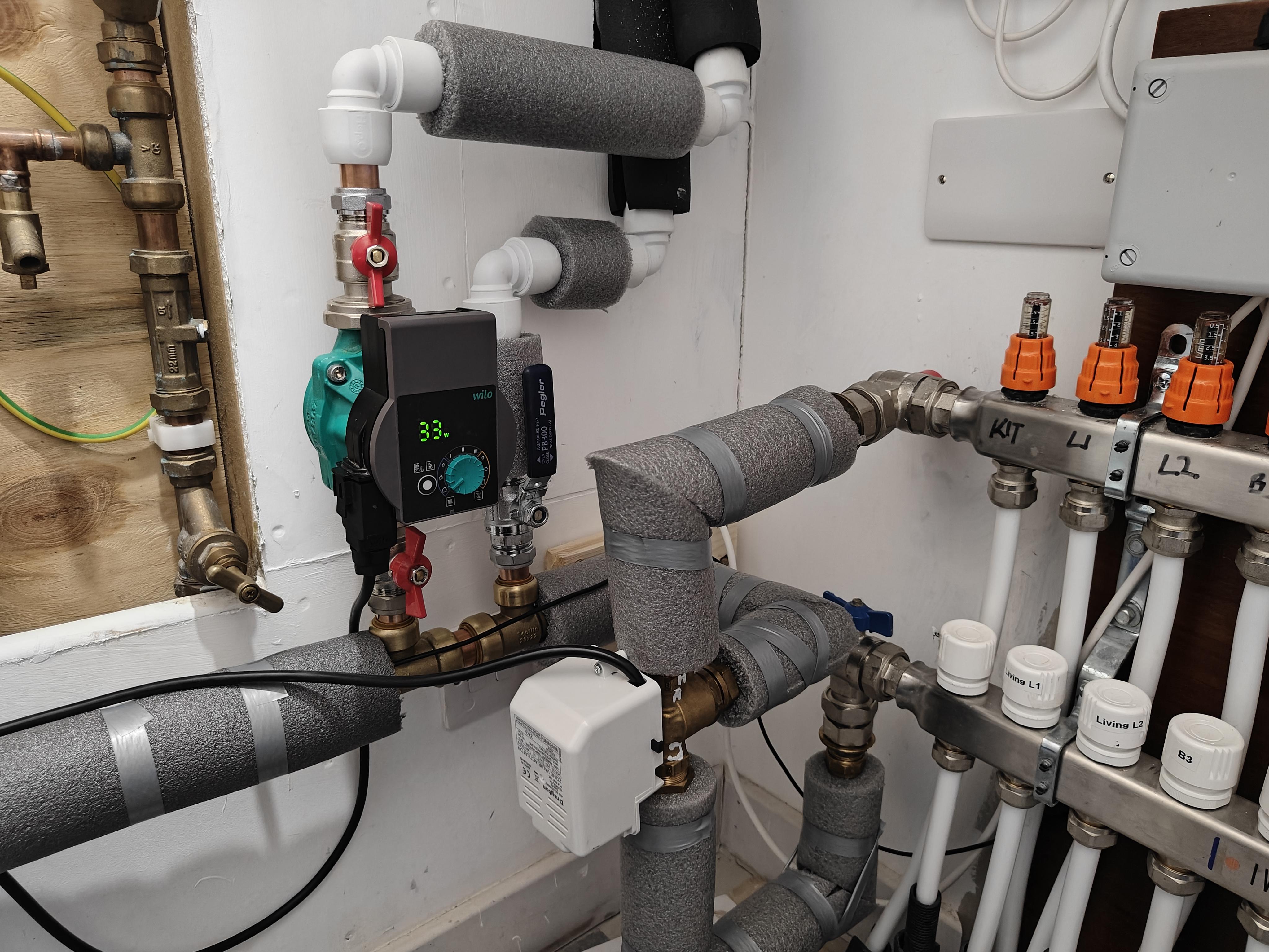

JohnMo Posted November 3, 2023 Share Posted November 3, 2023 New build originally designed around a gas boiler and UFH, flow temp are low as could be, due to 300mm pipe centres. So previous setup was, gas boiler, big buffer, mixer and pump on the manifold. The flow temp out the buffer was consistent, but filled based WC (Weather Compensation) curve. Flow temps varied between 26 and 34 degs (at -9 OAT). The heat pump is installed without a buffer, all UFH loops open, with no actuators, mixer or pump on the manifold, so as simple as it gets. Have a single thermostat, just to give a start permissive for the heating. Couple of observation 1. The min heating temperature of the heat pump is 25 degs, dT is 5.4 degs, so a return temp would be 21.5. 2. After one heat cycle at a low flow temp (26 degs), the floor doesn't cool down enough to allow to ASHP to start up again. So heat pump would not restart. That didn't work 3. At low loads heat pumps cycle, I typically have a 10 to 20 minutes run time and 45 minutes off. The recirculation pumps continues running at all times. If the heating load decreases (OAT, solar gain etc), the heat isn't transferred out the flow as quickly, so the off period of the ASHP increases. 4. To compensate for the on/off run nature of the ASHP, and to get the required heat into the floor, you need to flow at higher temperatures at low loads, than you would expect. 5. So to make up for the on/off nature I increased the flow temp to 29. The flow temp pattern through the floor is typically (8 deg day), heat pump ramps up to set temperature and when it cannot modulate to control dT the heat pump shuts down. The flow temp and return temperature stabilise down to about 24 and flow will slowly cool over over the next 40 minutes, down to about 23 and the heat pump starts. 6. Very small increments in flow temp have an impact on house temp, less than 0.5 degs change in target temp, can be felt in the house. 7. Been tracking the temp on a Shelly H&T today, temperature drift in the house is around 0.2 degs. Have tested the 3 basic modes of operation so far, operation controlled by thermostat, batch charging overnight on cheap rate, and continuous running 24/7 on straight weather compensation. So far leaving it to run all the time seems the cheapest to run and easiest to implement. Have a simple Shelly H&T set up in the hall, to record how temperature moves over time and OAT changes, this will allow fine tuning of the WC curve. 2 Link to comment Share on other sites More sharing options...
ReedRichards Posted November 4, 2023 Share Posted November 4, 2023 How warm is it inside the house? Link to comment Share on other sites More sharing options...

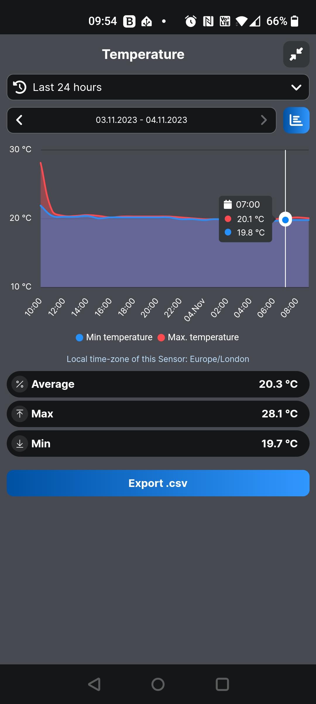

JohnMo Posted November 4, 2023 Author Share Posted November 4, 2023 26 minutes ago, ReedRichards said: How warm is it inside the house? We have it at 20 degrees, the temp over the last 24 hr has been very stable. Found that any hotter is too hot with the UFH, much cooler you are looking for a jumper. However there was zero sun yesterday, as it was peeing down all day, 8 degs in the day. Outside temp in the evening and overnight dropped to 4 degs for about 10 hrs. More of a brighter day today, so will get some solar gain, so will see how things react in the house and the ASHP. This was the cycles of the heat pump on a 7 deg night (couple of nights ago)- short runs long off time. (Green spikes are the ASHP) Last night at 4 degrees, run time extends with one run over 2 hours. Some of the bigger spikes are the dishwasher, the one 7am is kettle. House temps, the big spike was the H&T in my hand. Link to comment Share on other sites More sharing options...

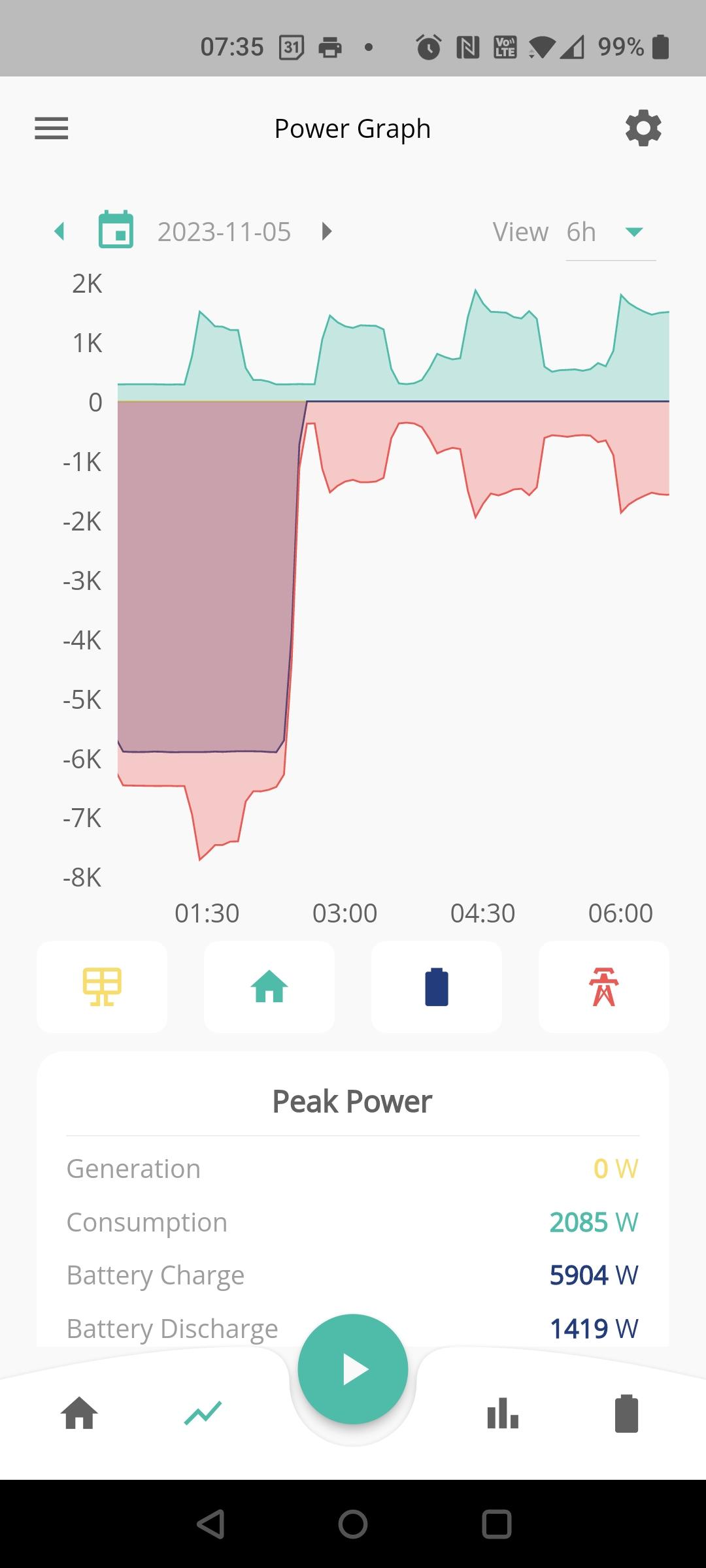

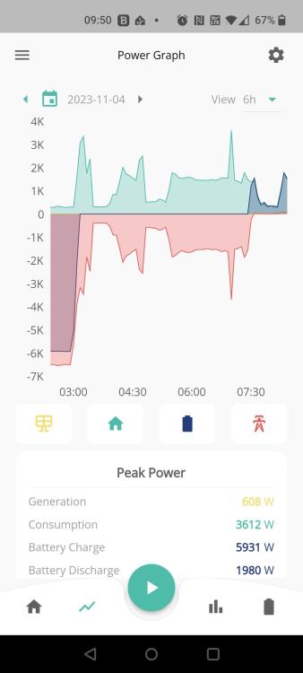

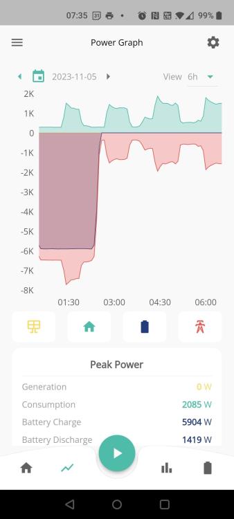

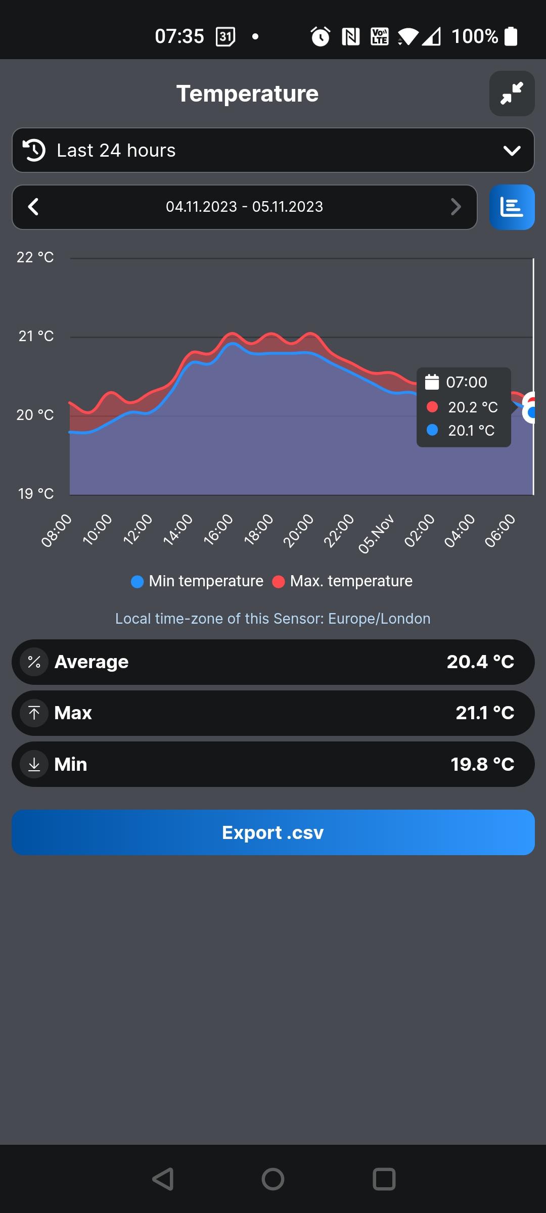

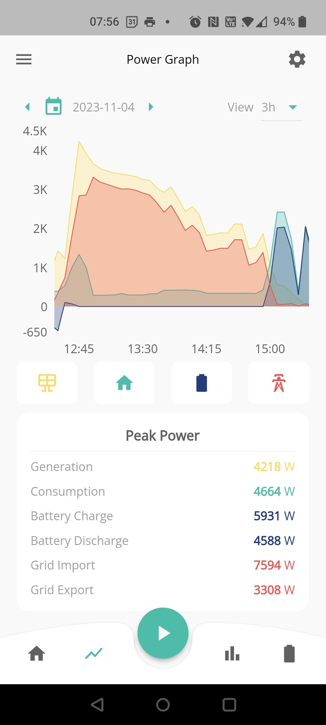

JohnMo Posted November 5, 2023 Author Share Posted November 5, 2023 Still using the weather compensation without any thermostat intervention to see what happens on different days. So yesterday was foggy in the morning and sunny in the afternoon but 8 degrees and by 6pm was down to 2 degs. We had some solar gain in the afternoon which warmed the front rooms of the house. So a couple of plots to show what happened This is the H&T in the hall, the heat from the solar gain moving into the hall, and slowly going back to the starting temperature over night. So couple of busy views, this is yesterday evening. The afternoon plot shows a slow down of the heat pump when the sun was out. The yellow is solar being generated. A 2hr window when the ASHP didn't add heat to the house. The evening when outside temp is 2 degs And this morning, you can see the run times getting longer. So although the ASHP isn't stopping when the room temp goes higher, it is sensing from the return water what is happening in the house. As for energy consumption the last 24hrs we used 12kWh on the ASHP and all auxiliary equipment. The previous 24hrs, with no solar gain and slightly warmer temperatures 9.5kWh Against a calculated heat loss of the garden room and house of close to 60kWh. So all things being equal a CoP of around 5. Which is inline with what to expect from the technical manual, running temp and Link to comment Share on other sites More sharing options...

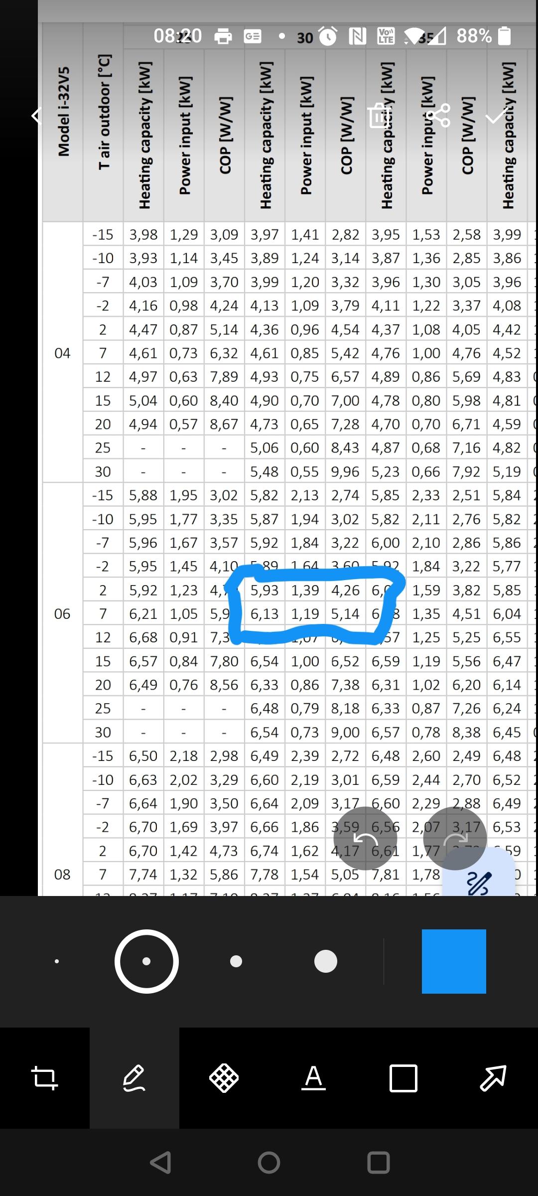

JohnMo Posted November 5, 2023 Author Share Posted November 5, 2023 The unit is really bigger than I need, but at the moment it's just outside short cycling and quite controlled. Short cycling for an ASHP is anything less than 10mins. Generally getting a good 15 min or more. Doing batch heating it was running for 4 hrs non stop some days. But the CoP wasn't any better. The big reason for running 24/7 is to displace the standby heating I was doing on our summer house, this required an electric heater set at 14 deg 24/7 and was using around 5 to 6kWh per day on its own. All of yesterday and so far today it's only used standby power for the thermostat 10Wh. Link to comment Share on other sites More sharing options...

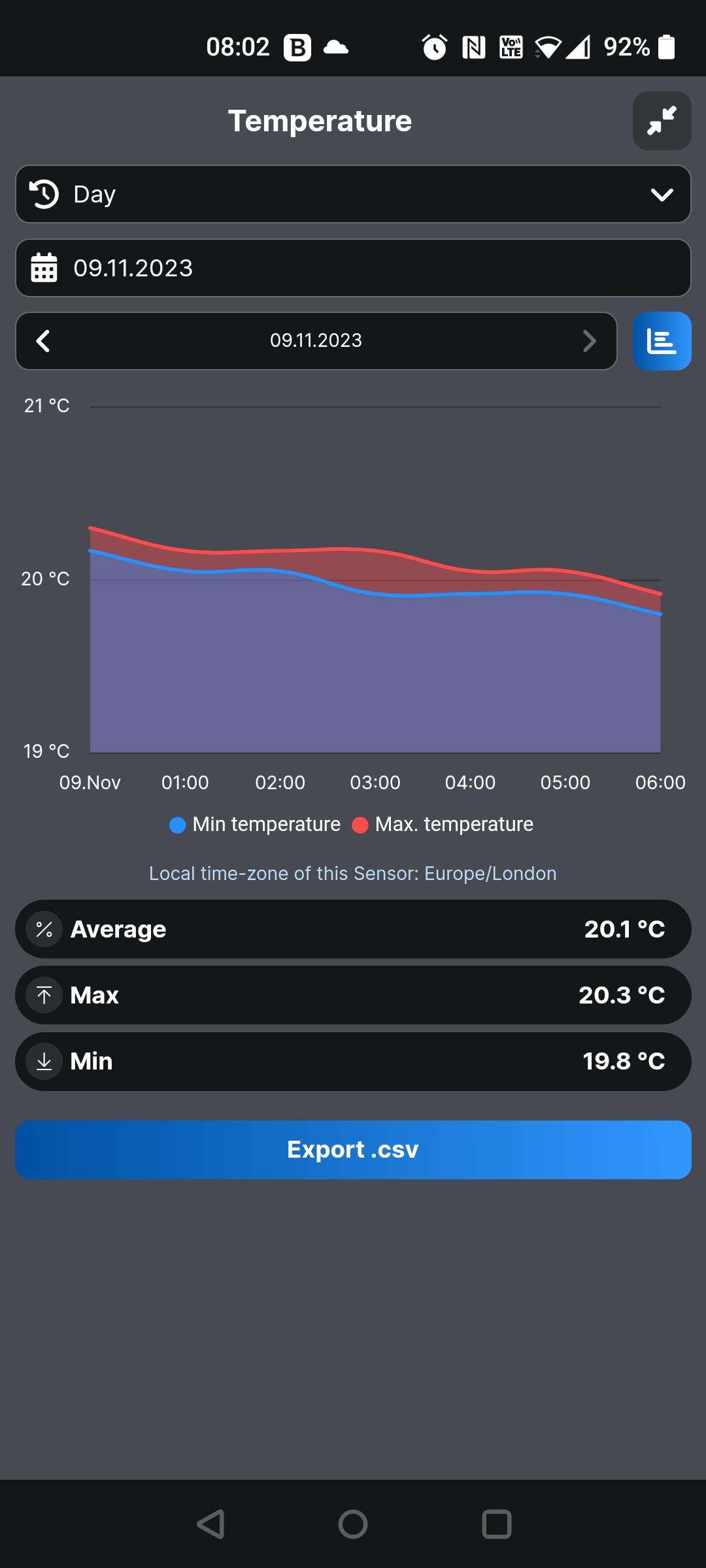

JohnMo Posted November 9, 2023 Author Share Posted November 9, 2023 Starting get cold nights, was down to -1 last night. So using the H&T sensor to track temperature inside the house. The house temperature gradient is a downward slope, so to compensate, have increase the end of the WC curve up 0.2 degrees. We have another cold night, tonight expecting it to be -2, so will see if the change has made any difference. Also with colder temperatures the run time of ASHP has increased. Now running just over an hour at a time overnight, with around 30 mins off. Link to comment Share on other sites More sharing options...

JohnMo Posted November 10, 2023 Author Share Posted November 10, 2023 41 minutes ago, sliderule said: Now it only cycles off once or twice a night I am thinking about reducing the flow rates to the floor loops. A quick calculation shows between the summer house and the house House manifold flow 12.4 Summer house manifold flow 2. With ASHP dT, I am pushing around 5.2kW into the floor. But have a peak demand around 3.5kW. This should allow the ASHP to run at a lower output and cycle less. Link to comment Share on other sites More sharing options...

JohnMo Posted November 12, 2023 Author Share Posted November 12, 2023 It's a 6kW heat pump, with a flow and dT that was demanding 6kW. Reducing the flow has allowed the heat pump to modulate down further. Overnight it was down to -2 OAT and the heat pump ran for 7 hours straight, except to defrost. 1 Link to comment Share on other sites More sharing options...
