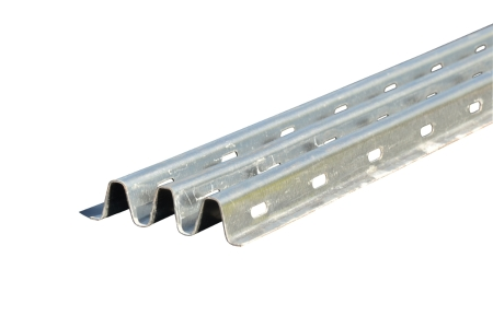

Russell griffiths Posted November 3, 2023 Posted November 3, 2023 Tanking slurry, you can buy it mixed in a big bucket, look at your local builders merchants lintel, you can get an internal steel lintel that is a galvanised steel in a wavy shape to add strength approx 30mm high. Again local builders merchants.

centralLondonJOHN Posted November 4, 2023 Author Posted November 4, 2023 This Catnic product certainly adds to the mix. Thank you
