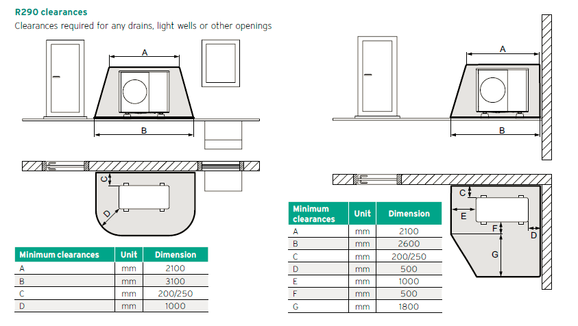

kandgmitchell Posted November 1, 2023 Posted November 1, 2023 Right from planning stage I had allowed for the ASHP unit to stand against the side of the house near the front corner. Now in the throes of organising the foundation design I see the location of the ASHP base will impinge on the required safety zone around the Vaillant Arotherm due to the position of the side door. I have now slid the location of the base further to the front which means the fan unit will protrude about half it's length past the front wall. This installation is part of the house package and their designers have raised a concern that the unit will be exposed and not function as well as one fully against a wall. Their suggestion is to put it against the front wall. Well they can tell my wife that, I'm certainly not! Vaillant suggest the unit can be remotely sited or placed on a flat roof so I can't see the problem. Is there a problem? If there is I'll come up with a screen for the height of the unit.

kandgmitchell Posted November 2, 2023 Author Posted November 2, 2023 Vaillant have an installation requirement that the unit should be a minimum of 1.0m from openings into the building in case ofthe escape of the gas used in the unit. The installer isn't going to ignore that I'm afraid as it was they who raised it. It's more about their concern that wind passing through the unit reduces it's efficiency that I need. Is it a thing?

ProDave Posted November 2, 2023 Posted November 2, 2023 5 minutes ago, JohnMo said: The heat pump will be makings air pass through itself when online, the air will be ambient, so would any wind. It's an inanimate object, not affected by wind chill, as humans are. But if you rotate it 90 degrees from how it is shown with the front in line with the house I bet it will meet the 1 metre from the door opening. They draw ambient air in the back and cooled air gets expelled from the front, so site the front facing the road and the cold air will blow that way not towards your door. Alternatively, if they insist on that orientation, then surely the 1M would be measured in a straight line from the corner of the door opening, to the nearest corner of the ASHP. So how much further out from the building would it need to be for the front edge to be in line with the front of the wall and the 1M distance achieved. Cut a large piece of cardboard or plywood or whatever you have around to the size of the ASHP and go and try it on the ground.
sharpener Posted November 2, 2023 Posted November 2, 2023 3 hours ago, ProDave said: But if you rotate it 90 degrees from how it is shown with the front in line with the house I bet it will meet the 1 metre from the door opening. They draw ambient air in the back and cooled air gets expelled from the front, so site the front facing the road and the cold air will blow that way not towards your door. Alternatively, if they insist on that orientation, then surely the 1M would be measured in a straight line from the corner of the door opening, to the nearest corner of the ASHP. So how much further out from the building would it need to be for the front edge to be in line with the front of the wall and the 1M distance achieved. Cut a large piece of cardboard or plywood or whatever you have around to the size of the ASHP and go and try it on the ground. This is the actual spec:
ProDave Posted November 2, 2023 Posted November 2, 2023 I see. R290 is a posh name for Propane gas. Propane is heavier than air so they don't want a leak filling up drains, getting into buildings etc. Is is possible to swap to an ASHP using something other than R290?
