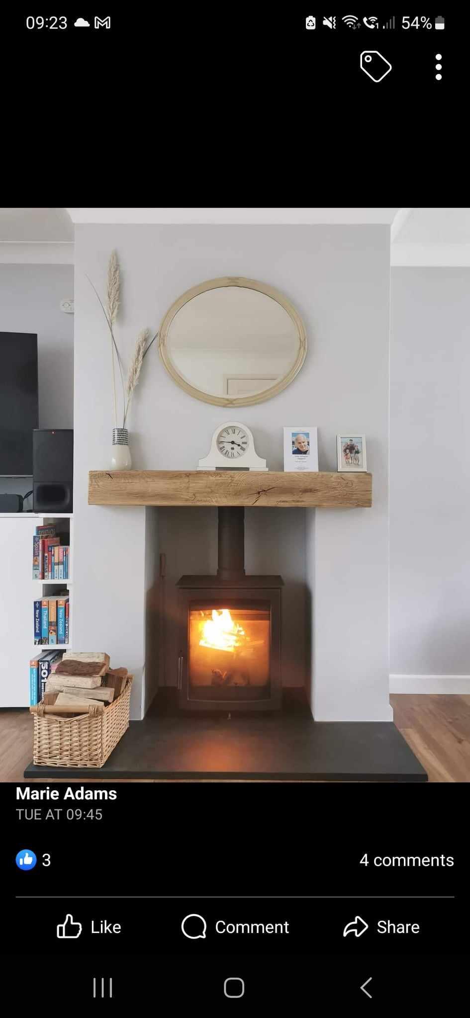

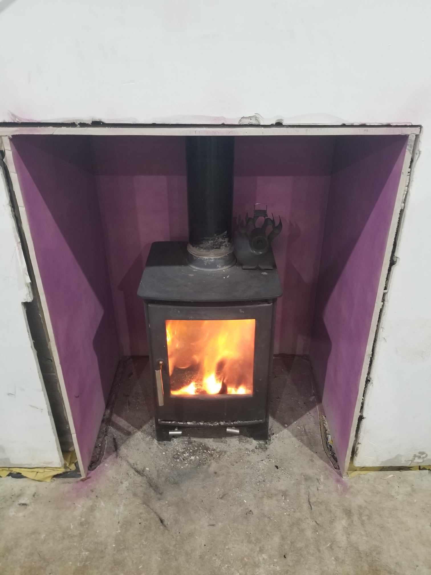

GrantMcscott Posted October 31, 2023 Share Posted October 31, 2023 Hi Looking for a seemless finish around fire looking for advise on how to finish as concered if we tape the corners that the Knauf Fill and Finish will just crack and fall off and the tape has paper in it. One image is what it looks like now and the other is what we want Link to comment Share on other sites More sharing options...
crispy_wafer Posted October 31, 2023 Share Posted October 31, 2023 I'd be having a looksie at what VITCAS offer in terms of high temp plaster 1 Link to comment Share on other sites More sharing options...
Canski Posted October 31, 2023 Share Posted October 31, 2023 I did my last one in metal plate. I think it’s called checka plate or something. Insulated behind the plate and the top was at an angle feeding the heat back into the room. Link to comment Share on other sites More sharing options...
GrantMcscott Posted October 31, 2023 Author Share Posted October 31, 2023 1 hour ago, Canski said: I did my last one in metal plate. I think it’s called checka plate or something. Insulated behind the plate and the top was at an angle feeding the heat back into the room. Will have a look Link to comment Share on other sites More sharing options...
Canski Posted October 31, 2023 Share Posted October 31, 2023 2 minutes ago, GrantMcscott said: Will have a look It's chequer plate BTW. I used steel. 1 Link to comment Share on other sites More sharing options...
Alan Ambrose Posted October 31, 2023 Share Posted October 31, 2023 There's some high temperature cement / mastic stuff used for sealing joints in flue pipes etc. A small amount of that maybe? Or else maybe get stainless cut and bent to fit - with or without powder coat to your taste. Slate hearth - but then the fire should probably sit on it? 1 Link to comment Share on other sites More sharing options...
