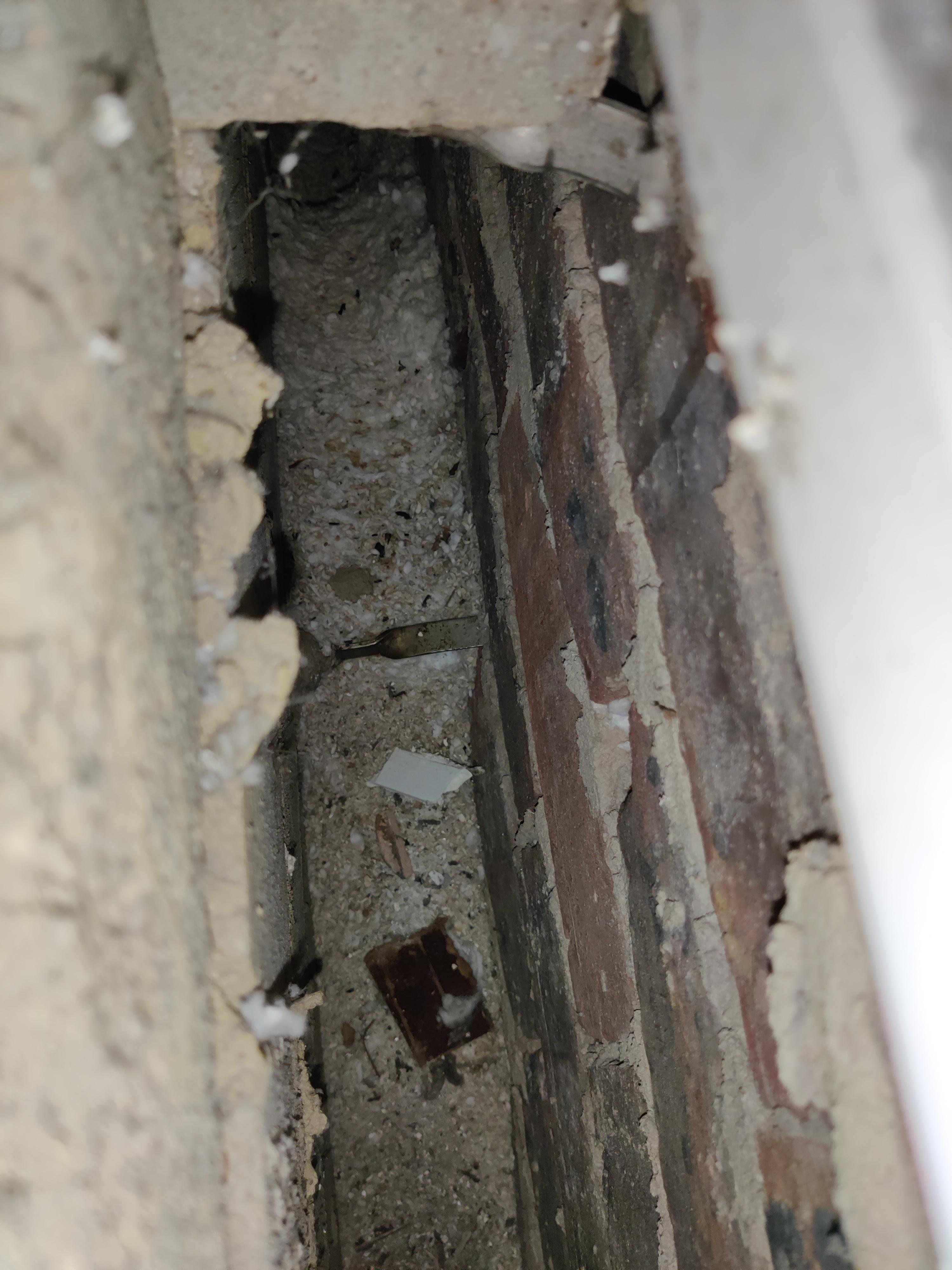

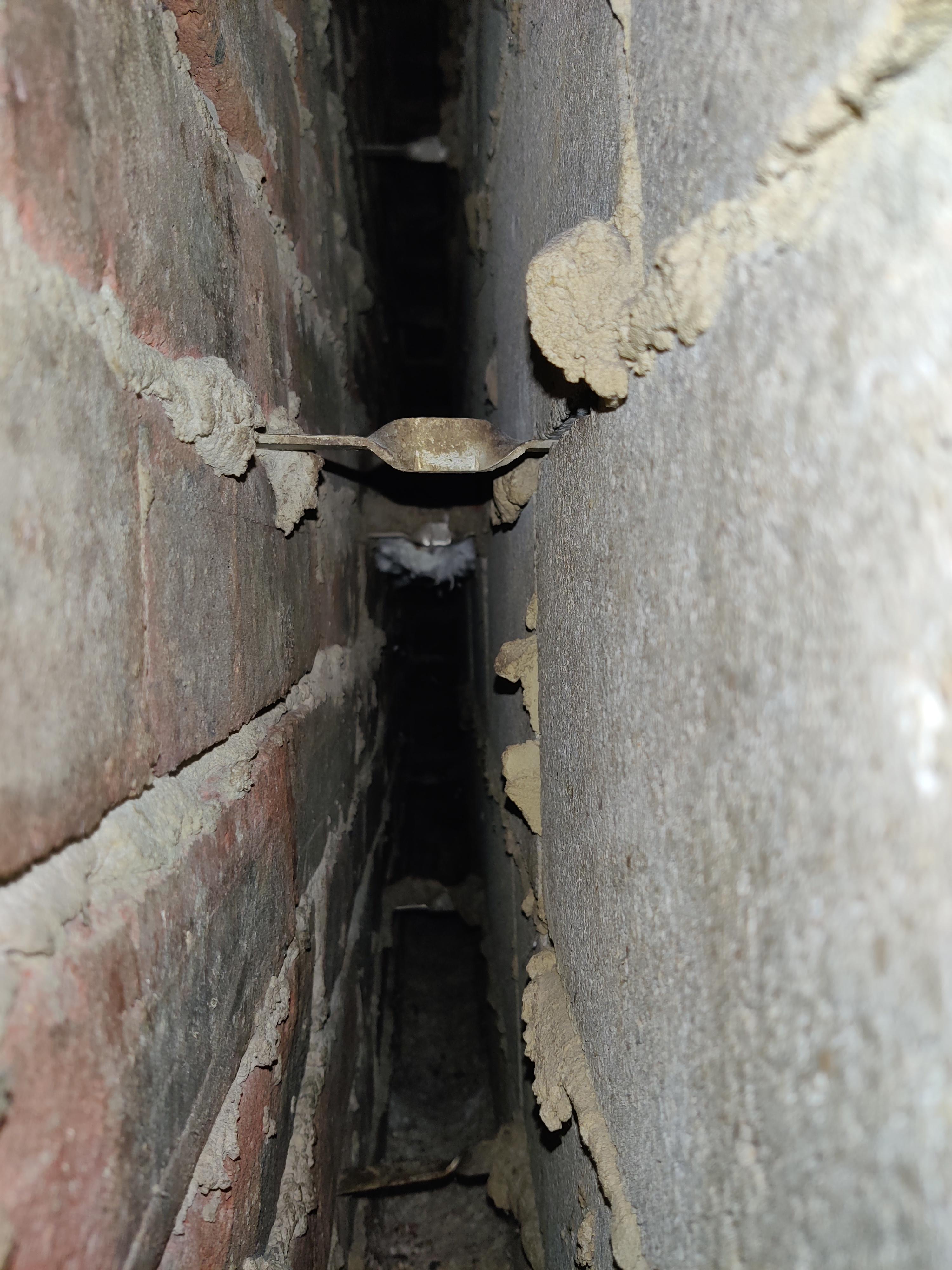

abernabei Posted October 30, 2023 Posted October 30, 2023 (edited) Hi everyone. we're in the middle of refurbishing a mid-60s ex-council maisonette. The property has insulated cavity wall, with a cotton-like material which I guess is mineral wool. We bought K118 insulated plasterboard (50mm phenolic board + 12.5mm plasterboard) to increase insulation and also to hide radiator pipes. However, after removing the window sills we have realised the cavity insulation has sagged in at least one of the walls (it hasn't in other likely-less-exposed-to-rain walls), leaving most of the first floor wall uninsulated. My first thought was to call someone in to top the cavity insulation up and resume our plan. However, after doing a bit of research it turns out there are a few schools of thought out there: - those who think cavity wall insulation without external wall insulation causes damp and should be removed, not topped up - those who think you should remove the old insulation and install new one Do you have any advice? What should we do? I have attached a pic of the view from one of the window sills on first floor, and another one of the section of the wall next to the window, which shows that section of the wall is now uninsulated. Edited October 30, 2023 by abernabei
markc Posted October 30, 2023 Posted October 30, 2023 The dreaded ‘sponge’ insulation so many got suckered into. Get it removed and replaced.
abernabei Posted October 30, 2023 Author Posted October 30, 2023 thanks Mark. What kind of insulation should I aim for?
markc Posted October 30, 2023 Posted October 30, 2023 2 minutes ago, abernabei said: thanks Mark. What kind of insulation should I aim for? I would go for blown bead eps, interesting to see what others would opt for
abernabei Posted October 30, 2023 Author Posted October 30, 2023 thanks, will keep that in mind. It will be interesting to see how they can remove and replace insulation without affecting the neighbouring (adjacent) flats above and next to us. I am not sure there's any separation in the cavities between the flats.

abernabei Posted October 31, 2023 Author Posted October 31, 2023 (edited) We haven't moved into the property yet so it's difficult to say. After we removed the wallpaper a few of the first floor walls (i.e. those which are not insulated) were partially covered in black mould. Not all of the uninsulated ones though. The wall that had the most was next to the bathroom (not sharing wall surface with the bathroom, but next to it along the same side), and there was evidence of a previous bathroom leak, which I guess must have caused that. That first floor wall is actually still insulated, we believe. The first floor walls which are definitely not insulated (anymore) did not have signs of black mould, but it is also true that they were originally not covered in wallpaper, so it's hard to know whether that black mould was a consequence of the insulation, or the bathroom leak, or the wallpaper plus the wardrobes standing in front of it, or all of that together. There was only little mould growth on the exterior walls on ground floor, which are the walls where the insulation has now squeezed into, except in the kitchen area...there's so much black mould behind the kitchen units it's unbelievable. In other words, it's difficult to say whether the insulation is/was causing damp 56 minutes ago, nod said: You will find it very difficult and expensive to remove You May find your only practical option is to top up why is that, out of interest? Can they not remove it with some kind of hoover through external holes and from the currently exposed window sills? They have easy access to the cavity. Edited October 31, 2023 by abernabei
