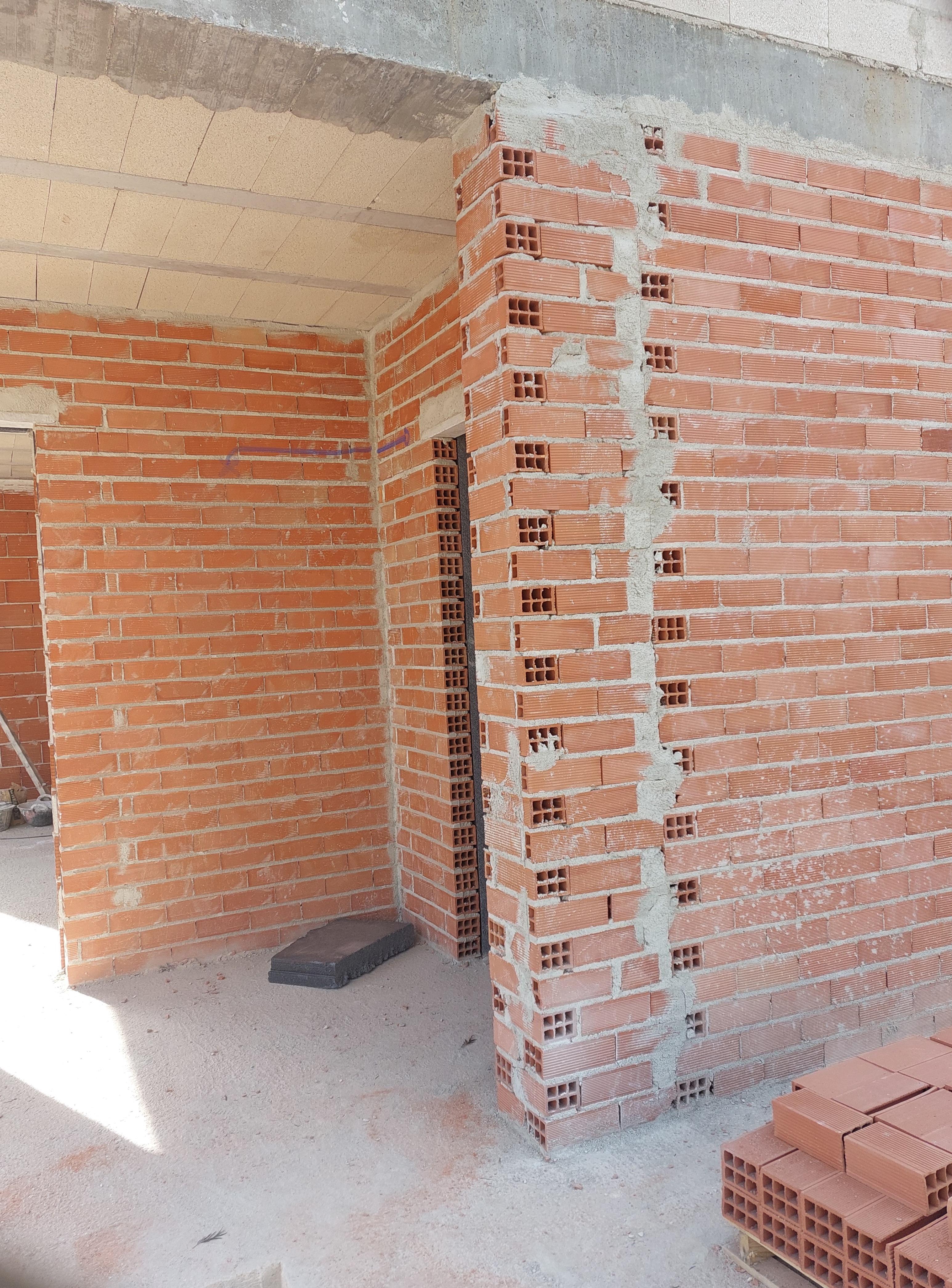

Estimator#1 Posted October 28, 2023 Share Posted October 28, 2023 Has anyone in UK used this product recently? Link to comment Share on other sites More sharing options...
Canski Posted October 28, 2023 Share Posted October 28, 2023 I haven't in the UK but I used them a lot in Germany in the 90's. What's up ? Link to comment Share on other sites More sharing options...
Russell griffiths Posted October 28, 2023 Share Posted October 28, 2023 I looked into them 5 years ago and couldn’t find anything to put in the plus column, so the got dismissed. Link to comment Share on other sites More sharing options...
saveasteading Posted October 28, 2023 Share Posted October 28, 2023 To me these are Mediterranean products appropriate to the climate . The insulation provided is very low. Their main advantage is in allowing rough work to be resolved by the following trades; easy to hack into shape. Perhaps some brownie points for not being made with cement. Link to comment Share on other sites More sharing options...
MikeGrahamT21 Posted October 28, 2023 Share Posted October 28, 2023 Our local Lidl got its main wall built with these, went up quick. Link to comment Share on other sites More sharing options...
Canski Posted October 28, 2023 Share Posted October 28, 2023 (edited) 4 hours ago, saveasteading said: To me these are Mediterranean products appropriate to the climate . It wasn’t very Mediterranean in Germany. Hot summers and very cold winters the blocks performed well. I see that now you can buy an insulated version that must improve the u values no end. Edited October 28, 2023 by Canski Link to comment Share on other sites More sharing options...
saveasteading Posted October 28, 2023 Share Posted October 28, 2023 Dampness is the UK differentiating issue. Yes you could use them, but I don't see an advantage that justifies the cost. The company has a factory in Kent, but don't appear to make these there....for a reason. Link to comment Share on other sites More sharing options...
saveasteading Posted October 29, 2023 Share Posted October 29, 2023 Busman's holiday. As I was saying. Appropriate in a different clime. This is much better work than the typical but will be covered in several coats of render. Fixing door jambs and conduits is a different technique. I appreciate that these are fairly basic blocks. Link to comment Share on other sites More sharing options...
