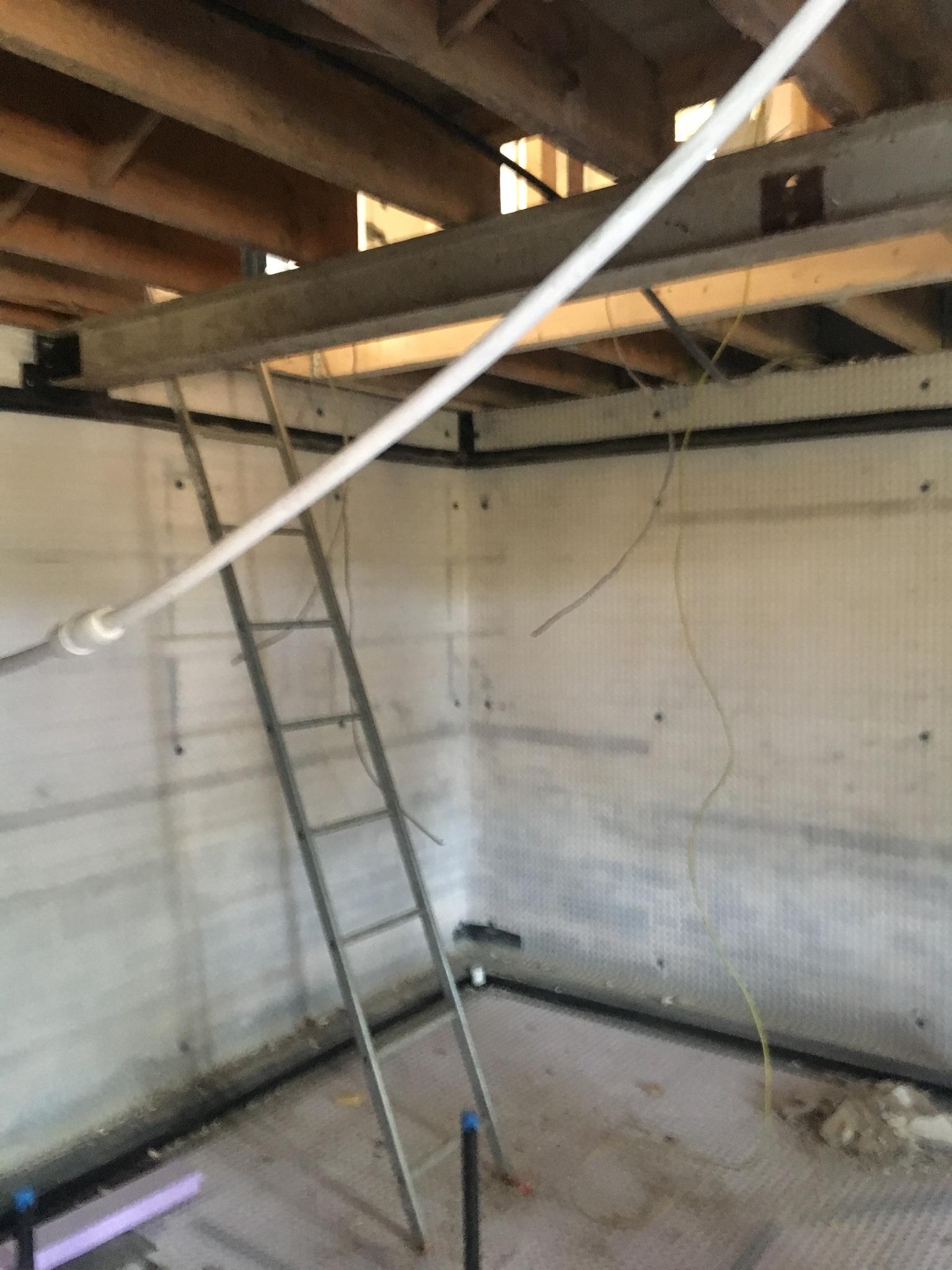

nod Posted October 26, 2023 Share Posted October 26, 2023 This is the last one that I did We had to run a drain around the outer edge and fit a pump But not always It’s probably worth getting a specialist survey to see if tanking will hold the damp back Or simply allow the water to collect behind the membrane There is the issue of certification to save problems further down the line Forever homes are rarely that Good luck Link to comment Share on other sites More sharing options...
markc Posted October 26, 2023 Share Posted October 26, 2023 (edited) I recently dug out a cellar floor and lined with membrane as damp was sealing in through the walls. Months before I dug a hole in the floor adjacent to a damp outside wall and monitored what happened during and after heavy rain - hole remained dry so I didn’t need a sump and pump etc. (storage space only). your floor/soil looks very wet so a drain and pump system is the way forward Edited October 26, 2023 by markc 2 Link to comment Share on other sites More sharing options...
scottishjohn Posted October 26, 2023 Share Posted October 26, 2023 (edited) if any help iwill tell you how my builders have tanked my old stone building which is 260 years old they built a 4" blokc wall next to stone wall --stuck on tanking membrane then gap and naother 4" wall and filled the gap with concrete If you can get wall dry enough to stick m,embrane then a gap and one " wall and fill gap with sloppy concrete that will work - concrete makes sure no amount of water pressure from other side will lift the mebrane you maybe cannot afford to loose 6" --but that will be a forever solution then dot and dab plaster board on to block wall ? Edited October 26, 2023 by scottishjohn Link to comment Share on other sites More sharing options...
