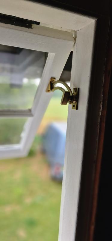

joe90 Posted October 25, 2023 Posted October 25, 2023 (edited) Try one of these, just stews to fit. https://www.ebay.co.uk/itm/266349296396?hash= made for windows but no reason they will not work for a cupboard door and if you need to open it further you have the option 🤷♂️ Edited October 25, 2023 by joe90
Adsibob Posted October 25, 2023 Author Posted October 25, 2023 2 hours ago, joe90 said: Try one of these, just stews to fit. https://www.ebay.co.uk/itm/266349296396?hash= made for windows but no reason they will not work for a cupboard door and if you need to open it further you have the option 🤷♂️ Thanks Joe, but couldn’t something like this damage the door (just because It’sa cheap door)?

joe90 Posted October 25, 2023 Posted October 25, 2023 2 hours ago, Adsibob said: Thanks Joe, but couldn’t something like this damage the door (just because It’sa cheap door)? No I don’t see why, just needs placing where 90’ is achievable.
