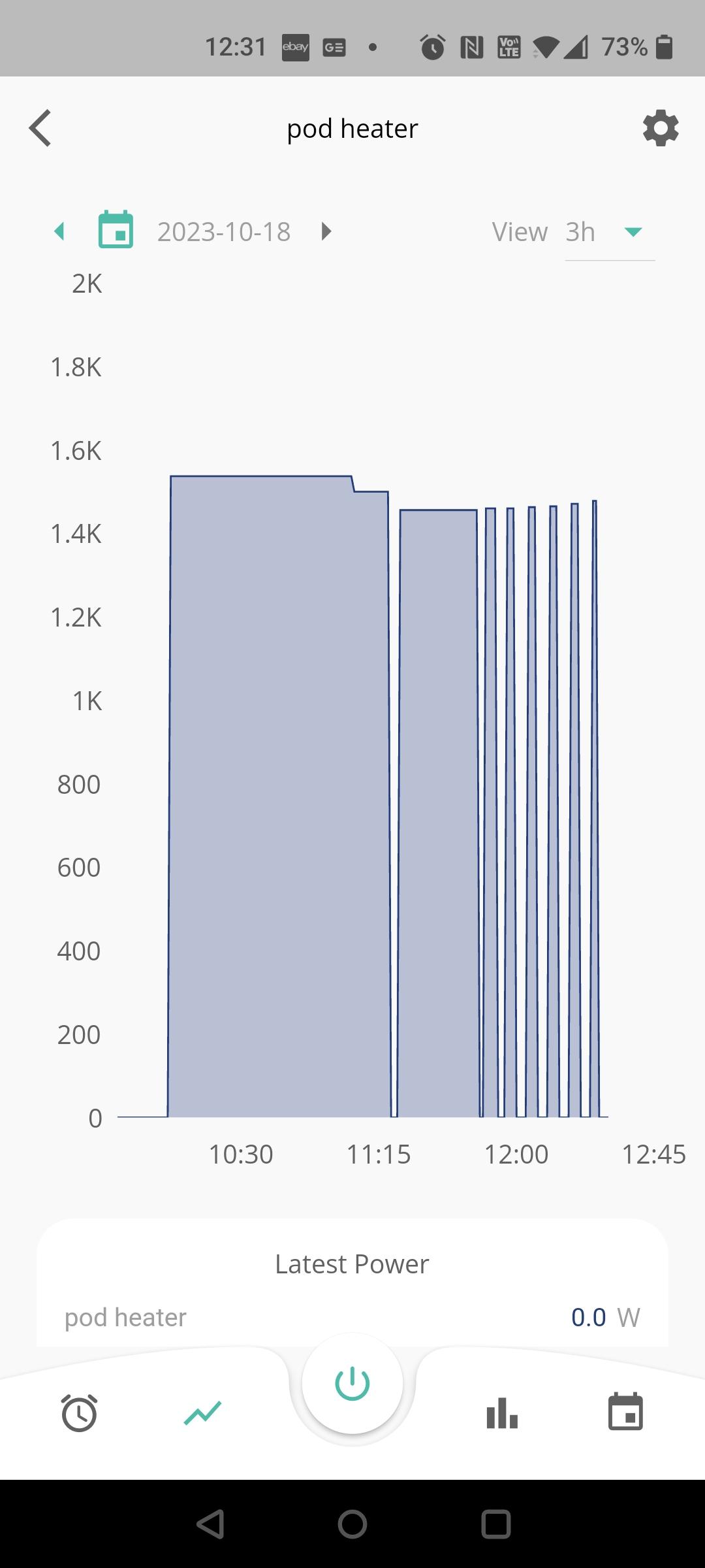

As a follow on from my previous topic on our summer room, which the wife uses as healing space.
We installed UFH, which was to be run from the house heating system, but unfortunately the heat output of the system is pretty rubbish (due to the low flow temps for the house. Only getting the summer house to 15 degs.  So purchased an electric radiator. Thought buy a decent one, so opted for a Dimplex. It has a built in timer and thermostat.

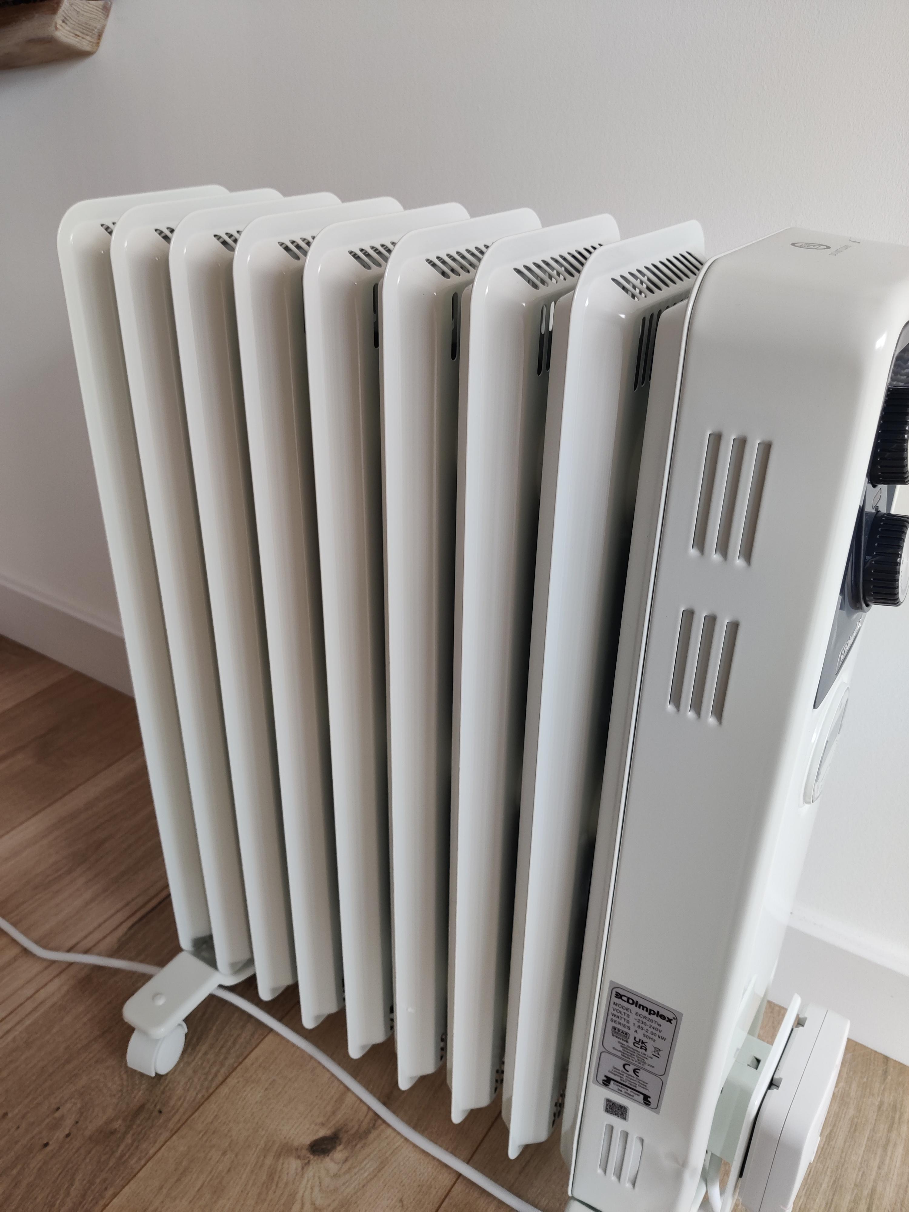

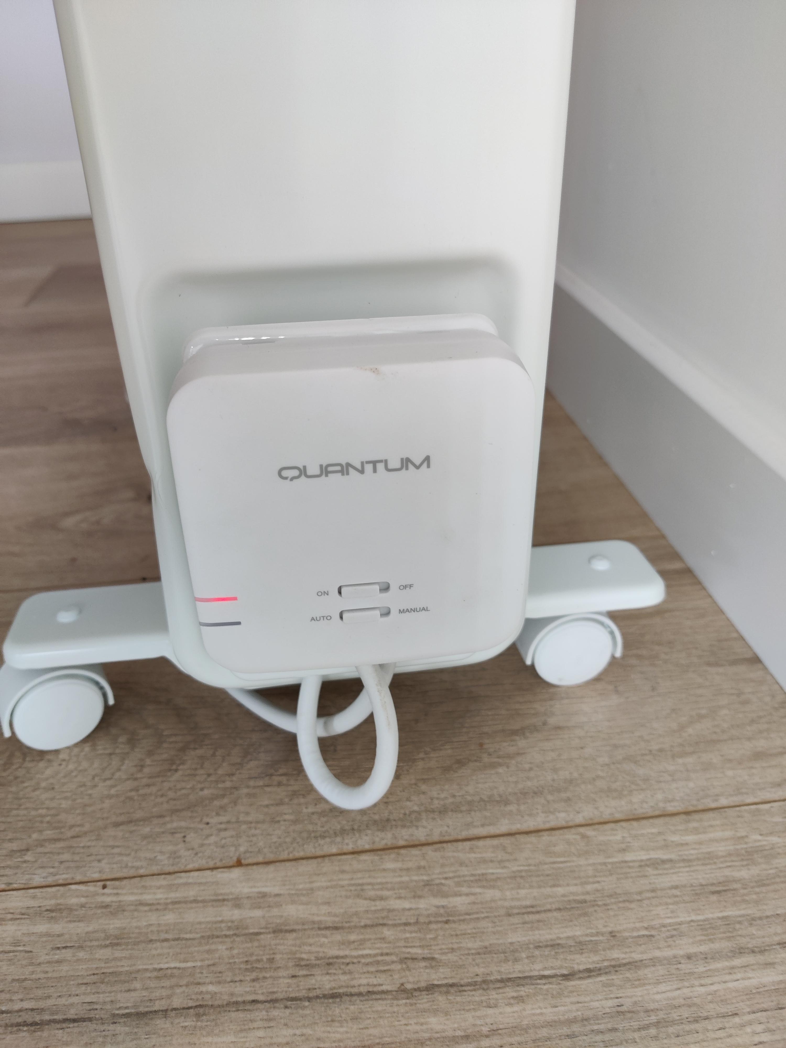

One basic issue is the thermostat is built into the unit, so is measuring the temperature local to the radiator, not the room temperature. Room heat up time seemed very long, temp variable in the room.

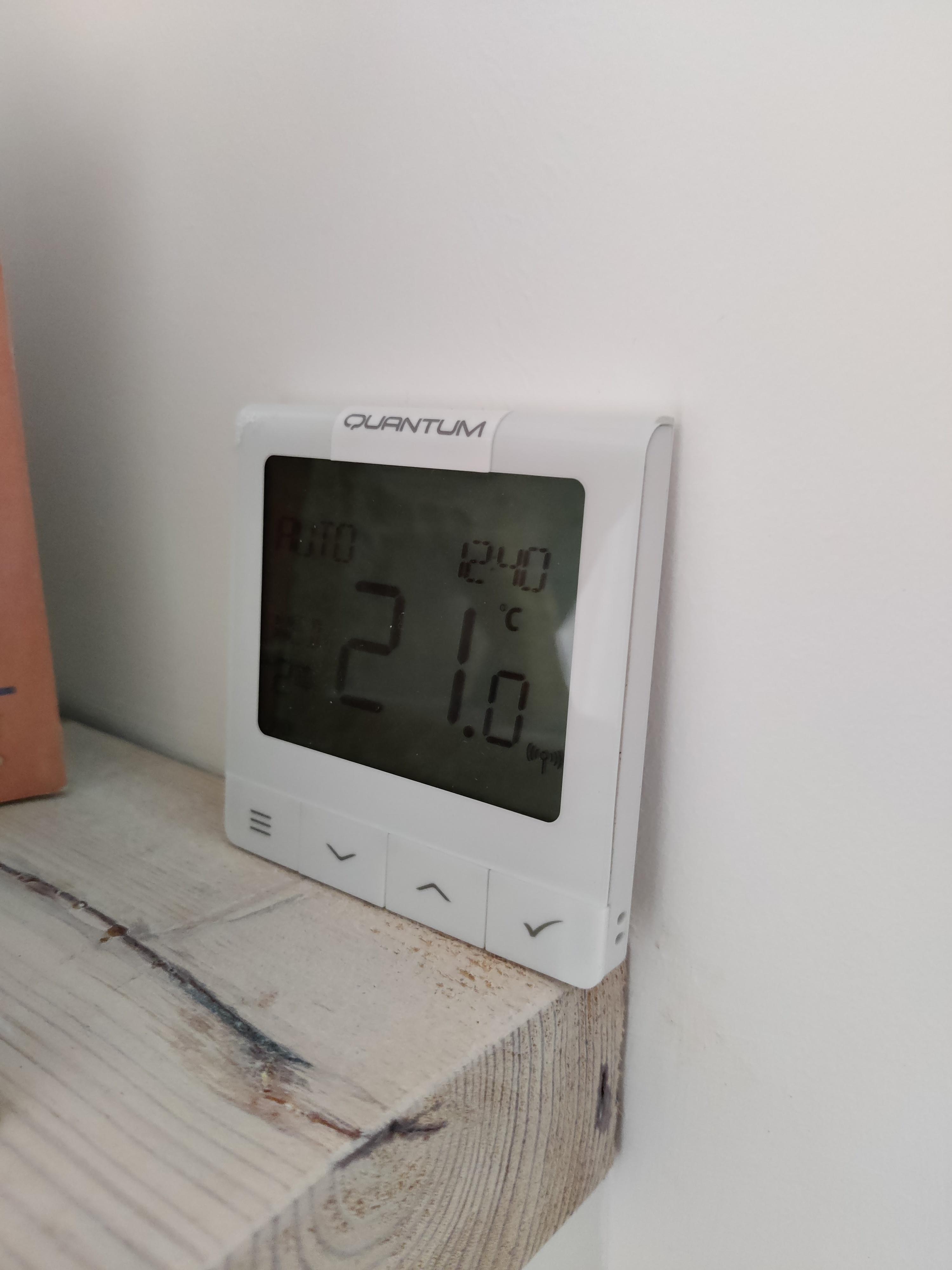

So solution was it install a wireless thermostat (has 16A switching capacity) - I had left over from the house build. A Salus WQ610RF, which comes with a self learning algorithm for electric heating and has predicted stop and start, so room learns when to start and stop heating.
So thermostat on radiator is set to maximum, and timer is disabled. All programs are run from the thermostat.

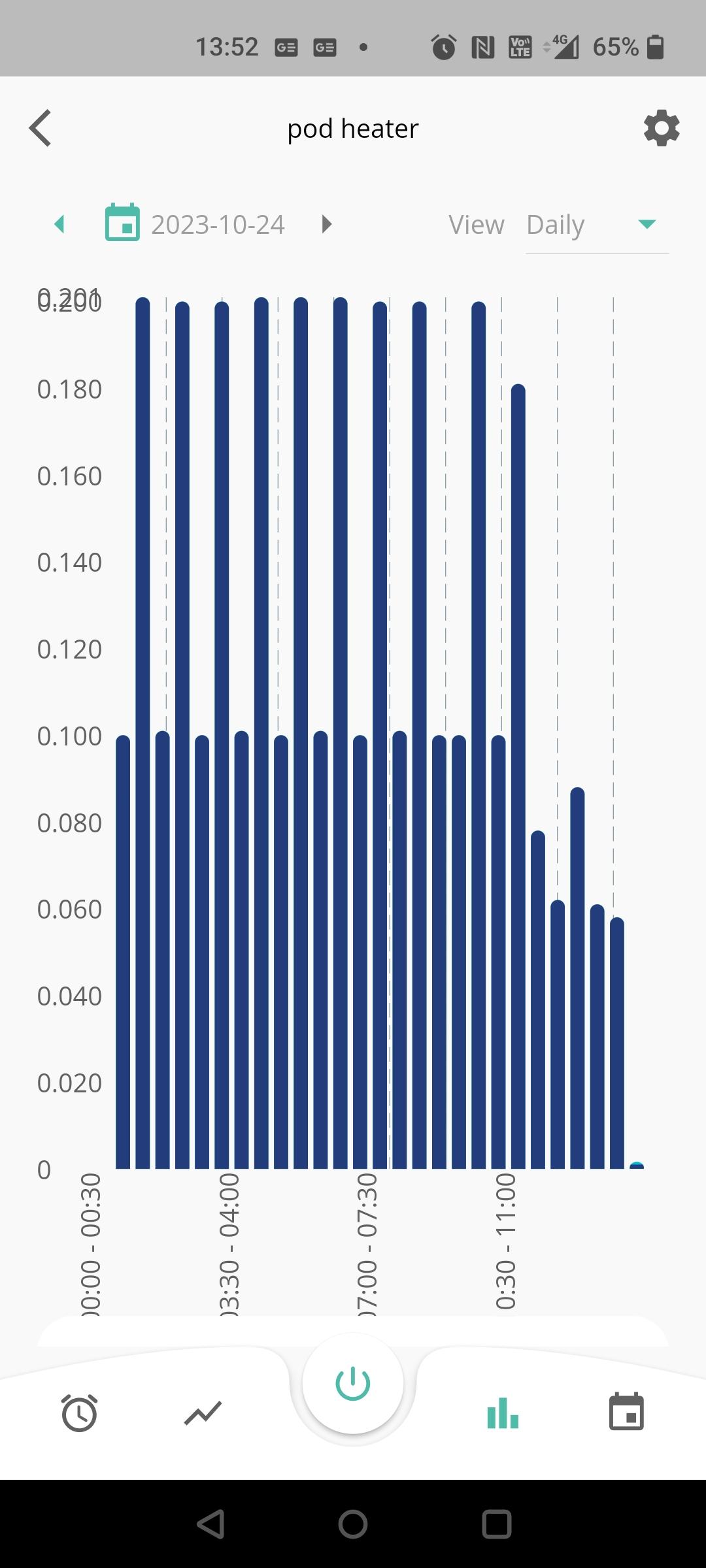

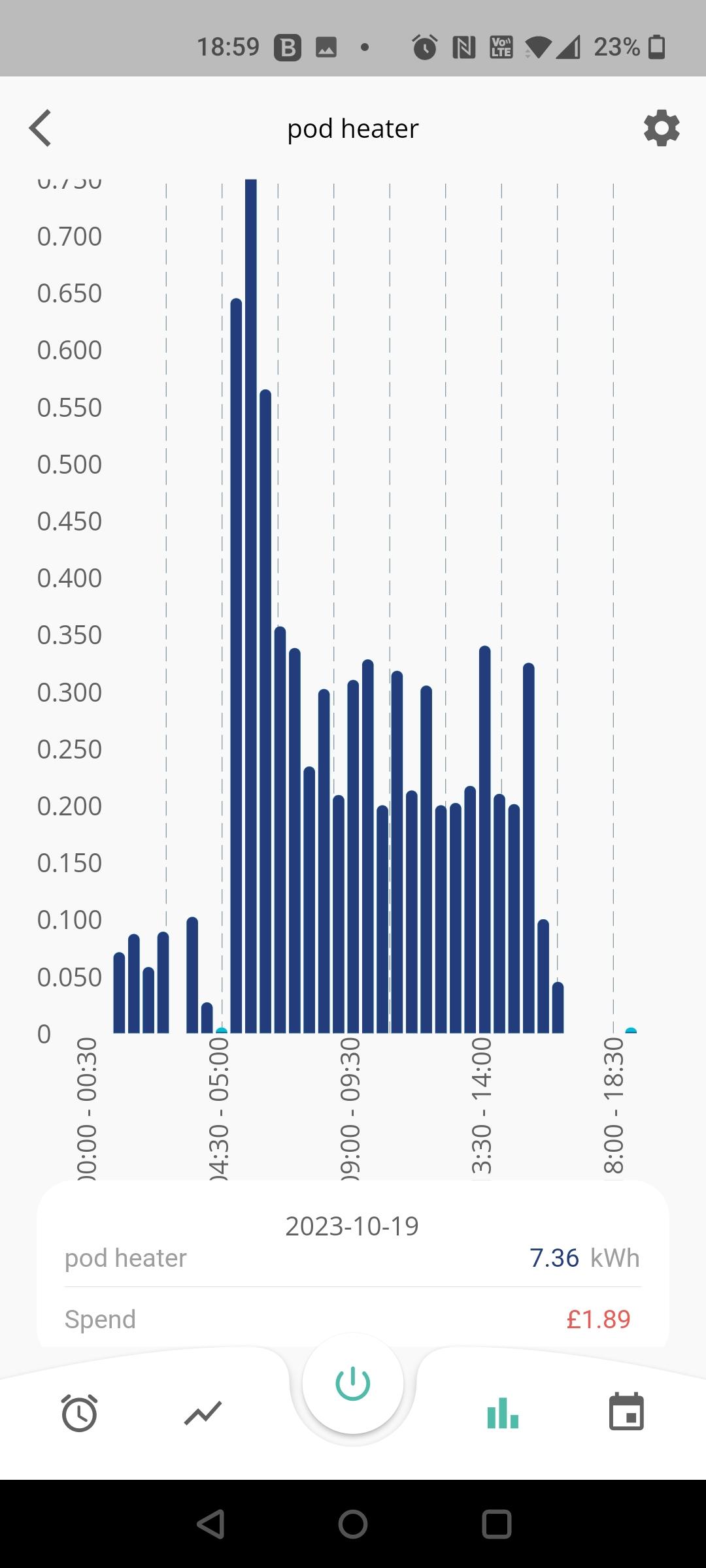

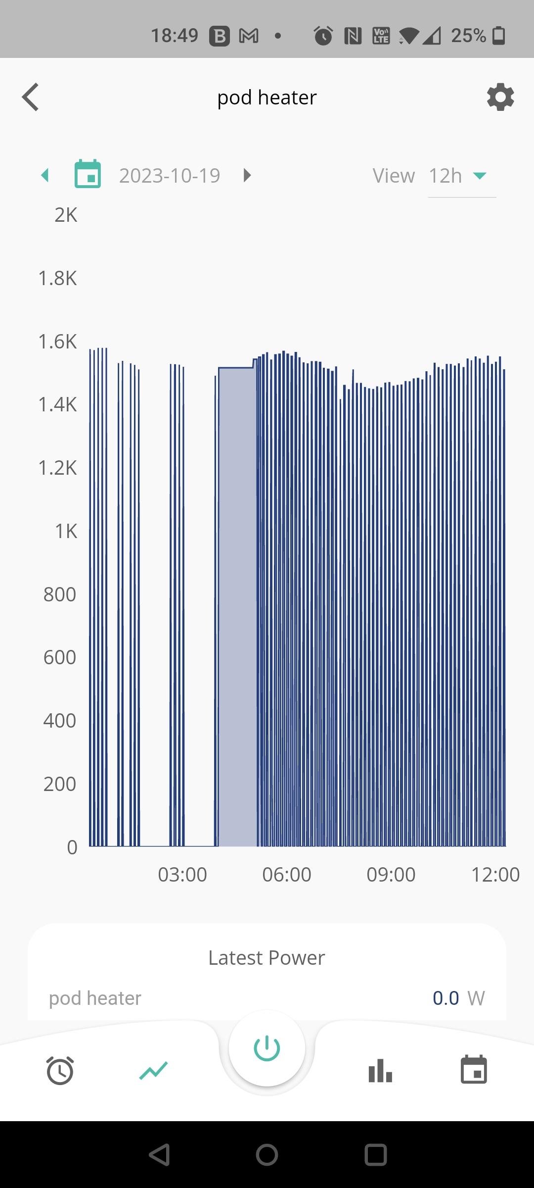

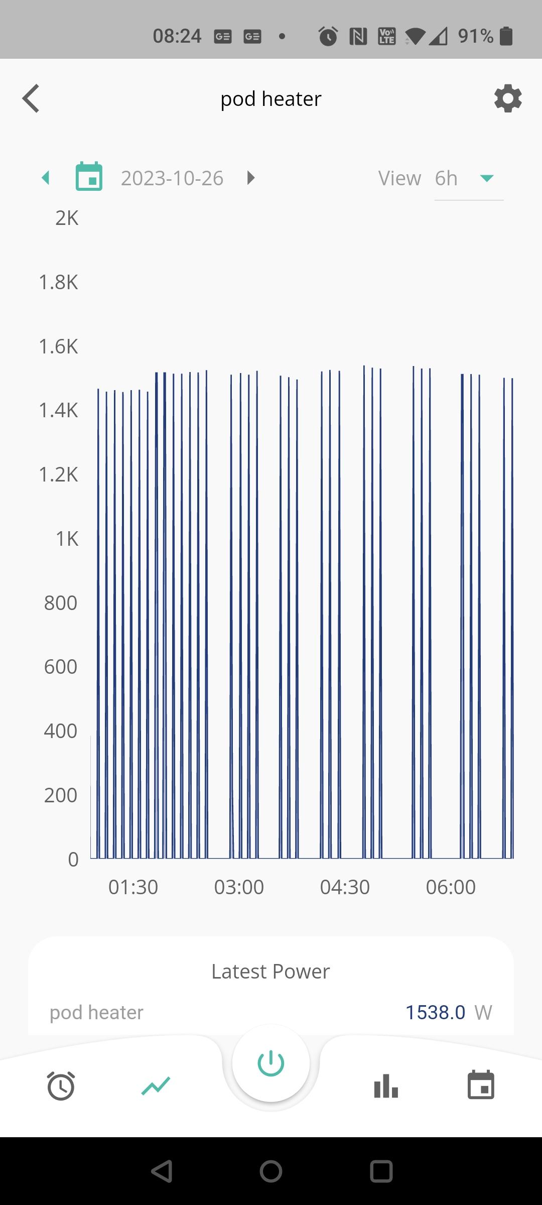

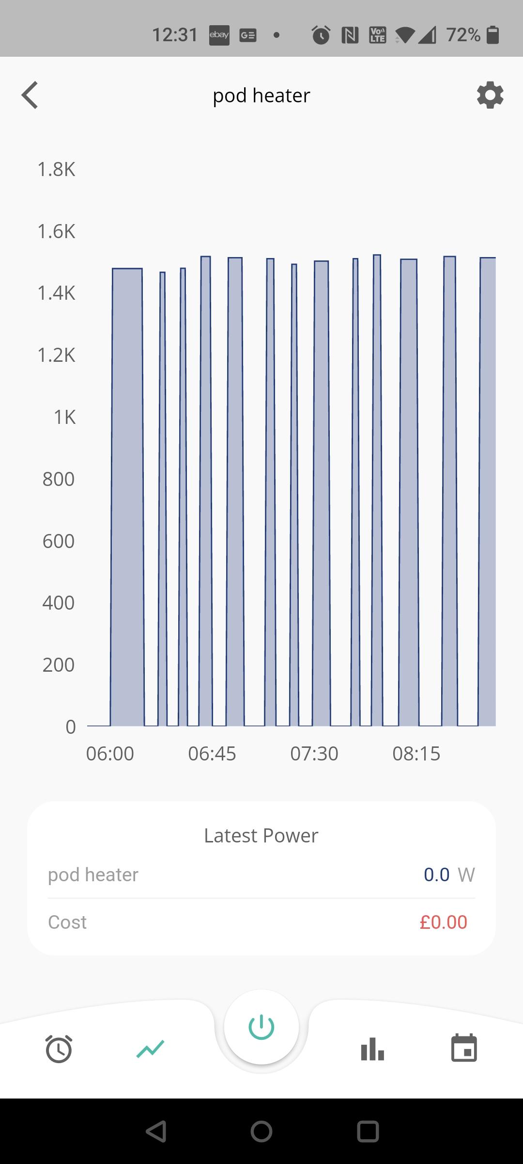

Screenshot of the heater activity (smart plug) prior to modification, lots of starts and stops of the heater, as a result heat up time was very long and room temperature varied quite a bit.Screenshot_20231018-123124.thumb.jpg.3eaed2764a8b1cb28508251f467f75fa.jpg
After modifications, nice long heater run to get room up to temp quickly. Very short on off periods to keep room temp stable. Also note the power input seems to be modulated as same power setting is used on the heater.

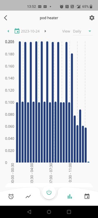

Interesting is the amount of stop starts the heater does to keep the room temperature stable.
A bigger view, based on the 1/2 hr usage in kWh. The calculation for heat loss, says I should have been using 430W and the electric input seems to back that up quite closely.

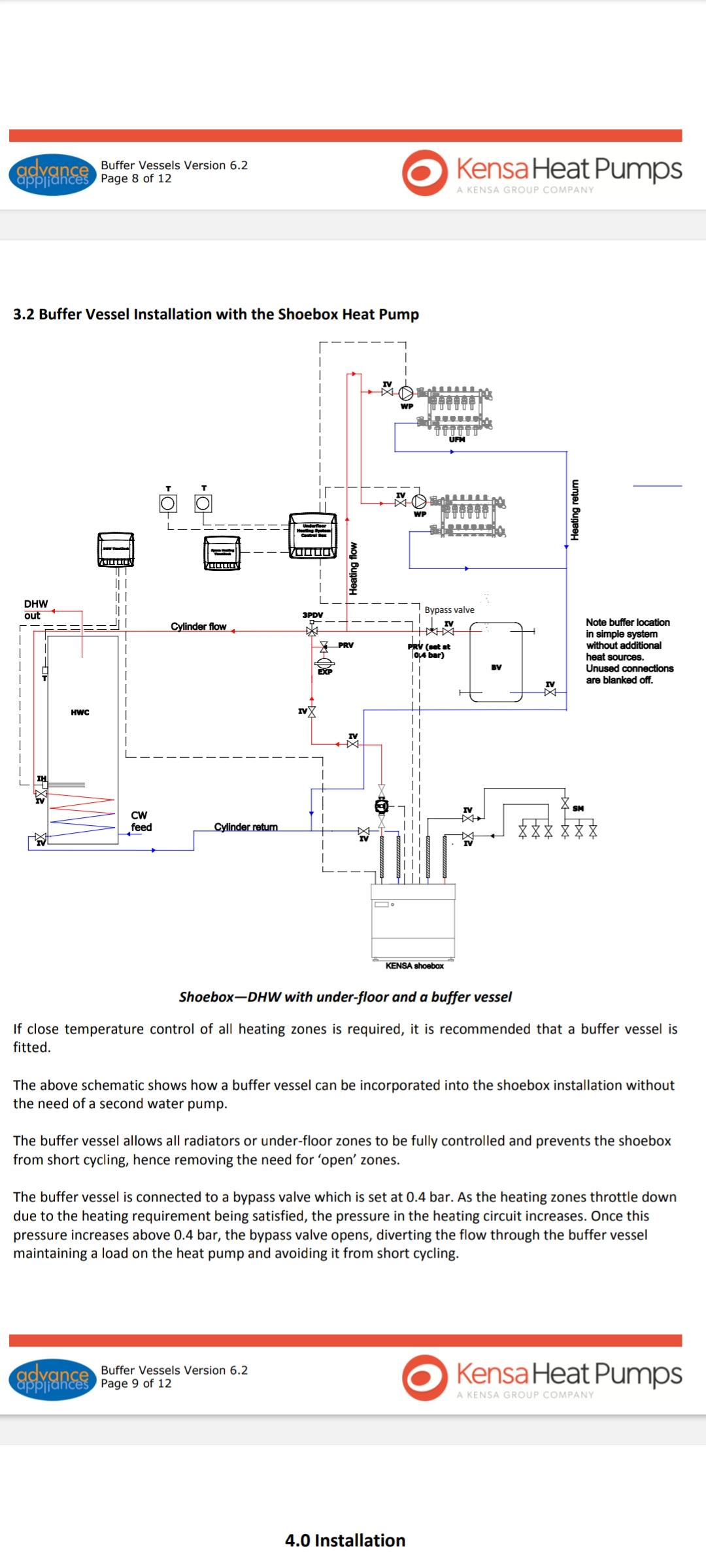

So issues are, I need two very different flow temperatures, one for summer house and a much lower one for the house, the heating season for the summer house is much longer also. So need to make two zones.
Since decommissioning the gas boiler, I have an Alpha Flowsmart 50L cylinder, so will repurpose as a buffer, plumbed as a parallel, 2 port across the supply and returns. Will follow the recommendation of Kensa heat pumps complete with PRV (by-pass valve) to engage the buffer only when needed.
Also in my parts store is an ESBE CUA100 (cheap off eBay a fair while ago). This is an electronic mixer valve, that can be operated in either of two modes, fixed flow temperature or a modulating flow temperature based on house temperature. It incorporates a timer which works in both modes and allows a second temperature to be set. So in theory you can increase the temperature (either house temperature or flow temp) during E7 and lower at other times. So will install this and a pump on the house UFH. The summer house will be run on weather compensation, direct from the ASHP.
CUA100_en_F_LR.pdf
Just waiting for a new mixer valve to arrive. Controller is installed and everything seems to work, as it should. Have put the controller in the lounge using now defunct thermostat wiring and will use this room as a reference temperature. Will run on house temp mode first to see how it goes. If it not stable, its just a setting change to switch mode.
