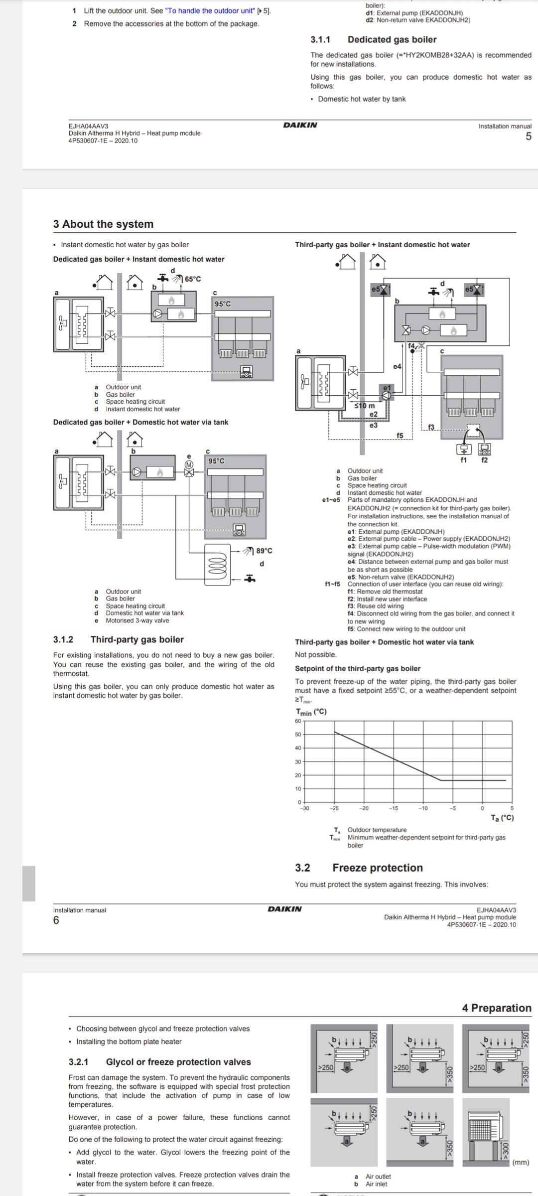

JohnMo Posted October 12, 2023 Share Posted October 12, 2023 11 minutes ago, Beelbeebub said: There is still a considerable amount of replumbing needed (low loss headers, control systems etc) and if you don't update the radiators for the lower temps your HP will be less effective. Not always true, for example Daikin hybrid, the heat pump just ties into the existing boiler. The Alpha one is just copying what Daikin have been offering for a decade. My ASHP (Maxa/Viessmann) has all the controls built in, with full control if how the circulation pump responds, so hydraulic sepereration isn't needed. It's all run weather compensated, so smaller, original radiators are fine, the really cold weather the original boiler takes over. However if you go hybrid no grants are available, which puts most off. 1 Link to comment Share on other sites More sharing options...
Beelbeebub Posted October 12, 2023 Share Posted October 12, 2023 1 hour ago, JohnMo said: Not always true, for example Daikin hybrid, the heat pump just ties into the existing boiler. The Alpha one is just copying what Daikin have been offering for a decade. My ASHP (Maxa/Viessmann) has all the controls built in, with full control if how the circulation pump responds, so hydraulic sepereration isn't needed. It's all run weather compensated, so smaller, original radiators are fine, the really cold weather the original boiler takes over. However if you go hybrid no grants are available, which puts most off. Yes, if you have a HP that can easily integrate then it's an option. As for not getting a grant, I was discussing with some installers. There is nothing in the regulations that say you have to physically remove the existing boiler, only that it cannot be part of the system if you want the grant. Equally there is nothing to stop the customer contracting a heating engineer to integrate a boiler with the existing HP, say a month after installation and after the grant process is complete..... Link to comment Share on other sites More sharing options...
JamesPa Posted October 12, 2023 Share Posted October 12, 2023 (edited) 15 minutes ago, Beelbeebub said: As for not getting a grant, I was discussing with some installers. There is nothing in the regulations that say you have to physically remove the existing boiler, only that it cannot be part of the system if you want the grant. Equally there is nothing to stop the customer contracting a heating engineer to integrate a boiler with the existing HP, say a month after installation and after the grant process is complete..... That's sailing a bit close to the wind IMHO. See regulations 17 - 24 for extensive inspection and enforcement powers and note that regulation 2 says that the heat pump is eligible if 'it replaces the heat generating components of the original heating system installed in that property (where applicable). I do grant that this does not require removal, but equally Im not sure a heat pump could be said to 'replace' existing kit if the existing kit is still used and one might even argue that replace includes physical replacement as well as functional replacement. I'm normally happy to sail close to the wind when interpreting legislation, but if I were an installer (which I'm not, I hasten to add) I would absolutely refuse to get involved in anything where I could reasonably be assumed to know that there is a likelihood of reversion. Edited October 12, 2023 by JamesPa Link to comment Share on other sites More sharing options...

Beelbeebub Posted October 12, 2023 Share Posted October 12, 2023 8 hours ago, JamesPa said: That's sailing a bit close to the wind IMHO. See regulations 17 - 24 for extensive inspection and enforcement powers and note that regulation 2 says that the heat pump is eligible if 'it replaces the heat generating components of the original heating system installed in that property (where applicable). I do grant that this does not require removal, but equally Im not sure a heat pump could be said to 'replace' existing kit if the existing kit is still used and one might even argue that replace includes physical replacement as well as functional replacement. I'm normally happy to sail close to the wind when interpreting legislation, but if I were an installer (which I'm not, I hasten to add) I would absolutely refuse to get involved in anything where I could reasonably be assumed to know that there is a likelihood of reversion. Sensible. It woukd be extremely close to the wind if the same installer reconnected the old boiler. Wouldn't be on the installer if the customer got a different heating engineer to reconnect the boiler. Of course the customer might be in hot water (ha), but there isn't a requirement that once a HP is fitted and a grant issued that property can never again have a boiler fitted. HP installs go wrong, fail, customers decide they don't like the noise etc. Link to comment Share on other sites More sharing options...
DanDee Posted October 12, 2023 Share Posted October 12, 2023 27 minutes ago, Beelbeebub said: Sensible. It woukd be extremely close to the wind if the same installer reconnected the old boiler. Wouldn't be on the installer if the customer got a different heating engineer to reconnect the boiler. Of course the customer might be in hot water (ha), but there isn't a requirement that once a HP is fitted and a grant issued that property can never again have a boiler fitted. HP installs go wrong, fail, customers decide they don't like the noise etc. https://assets.publishing.service.gov.uk/government/uploads/system/uploads/attachment_data/file/1133079/Approved_Document_L__Conservation_of_fuel_and_power__Volume_1_Dwellings__2021_edition_incorporating_2023_amendments.pdf 1 Link to comment Share on other sites More sharing options...
