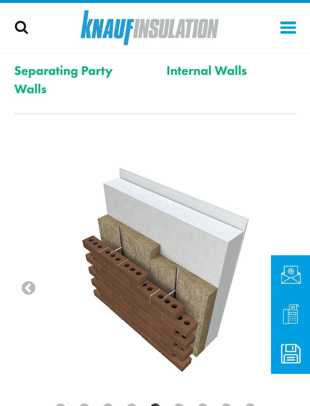

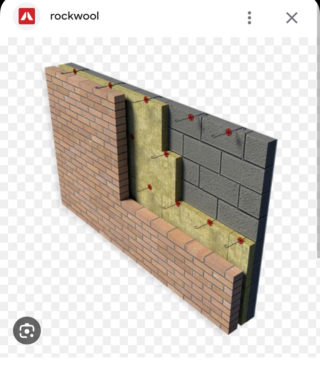

Iceverge Posted October 6, 2023 Share Posted October 6, 2023 3 hours ago, Lewis88 said: changing my plans and use another form of insulation I would stick with what you're at. Have a look at the denby dale video's for best practice. Its a very good series. We're 250mm full fill here (I would do more if I had the chance again!) with EPS beads in the SW of Ireland, so plenty driving rain. No issues so far. EPS beads are the norm here. However we're rendered (sand+cement) throughout. I would just get your plasterers to do a simple coat of render behind the stonework contigious with the rest of the render if you're bothered. Practically speaking, if your stonemason points the stonework properly you'll be fine. Overall take care of the detailing around windows ( permanently flexible sealant done well ) and use a good paint and some brick cream/waterproofer and I wager you'll have zero rainwater making it past the first mm. If you build with a half assed mason, leaving open perp joints, balled up insulation that gets wet in construction and cavity trays that are covered in mortar ( AKA mass housing estates) of course you're inviting trouble. Link to comment Share on other sites More sharing options...
joe90 Posted October 6, 2023 Share Posted October 6, 2023 34 minutes ago, Iceverge said: I would stick with what you're at. I agree but @Lewis88 problem is the HSBC won’t pass any full fill insulation for his warranty. Link to comment Share on other sites More sharing options...
Iceverge Posted October 6, 2023 Share Posted October 6, 2023 Knauf do a partial fill detail as do Rockwool. Personally I would always prefer to spend my energy making sure the job was done properly rather than spending money on a warranty that may or may not pay out later. Perhaps it's needed for the lender. 1 Link to comment Share on other sites More sharing options...

Lewis88 Posted October 7, 2023 Author Share Posted October 7, 2023 Unfortunately I warranty is a must for me, my partner is adamant. I’m not opposed to making the cavity larger with more insulation but the NHBC strictly rules out full fill with fair face masonry. @Iceverge are you saying that I should do the stone and glass gable as the following internal block, full fill insulation, external block (with render applied) then a cavity and stonework? If so that could work. I suppose that the render would mean that it is no longer considered ‘fair faced’ and just had a stone skin?? I’m really not au fait with any other form of building than brick and block, but that all any of the trades do around here. Could it be easier to do this part in timber frame? My architect tells me that build systems can be joined/interchanged. Link to comment Share on other sites More sharing options...
joe90 Posted October 7, 2023 Share Posted October 7, 2023 2 minutes ago, Lewis88 said: but the NHBC strictly rules out full fill with fair face masonry. But if memory serves from their document they don’t say how big the cavity should be? (Best to check) so make it 10mm bigger and use the methods @Iceverge suggests above (but if it were me I would still put in more insulation, you only buy it once and save heating costs forever. With my 200mm full fill cavity the heating only came on occasionally for a couple of months a year (and was only 4KW). Link to comment Share on other sites More sharing options...
