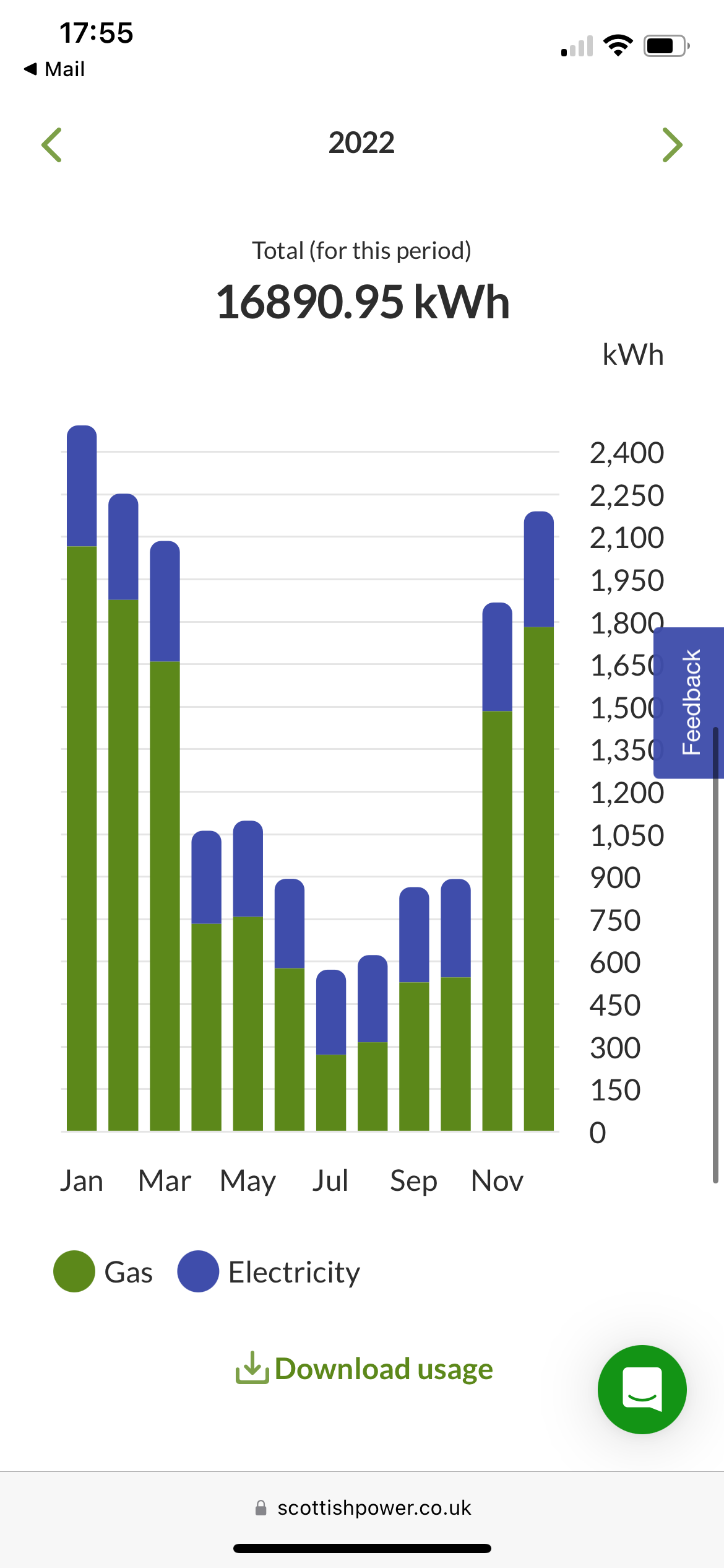

abernabei Posted October 3, 2023 Share Posted October 3, 2023 (edited) Hi everyone, we're looking at insulating the floor of our ground floor maisonette. As discussed at UFH isn't really an option for our property unfortunately, so we're looking at whether we can improve anything before installing new flooring and radiators. Ceiling height is already low-ish (235, might drop to 230cm if we have to go for a second ceiling). Does anyone have advice on low profile insulation boards that might fit our use case? I was thinking of going for 20mm XPS boards, or maybe Aerogel? then possibly adhesive and tiles? Or would laminate work better given the low floor insulation? We're also looking at infrared ceiling panels as a heating option for the ground floor, does anyone have any opinion on those? As far as walls are concerned, the current walls are 10cm concrete block, 10cm insulation (white cotton-like material, mineral wool?), then decorative bricks. The plan there is to install Kingspan K118 insulated plasterboard internally, 37.5mm (25mm 0.019W/mK plus plasterboard). Is that a sensible plan? or should we consider a different product or a thicker option? Edited October 4, 2023 by abernabei Link to comment Share on other sites More sharing options...

LiamJones Posted October 26, 2023 Share Posted October 26, 2023 8 hours ago, abernabei said: Were your bills acceptable even with the retrofit slim UFH? In my opinion, yes. It was a 3 bed 1950 semi about 90m2. Filled cavities. Double glazing. Gas combi. Annual space heating demand of approx 8kWh Link to comment Share on other sites More sharing options...
abernabei Posted November 4, 2023 Author Share Posted November 4, 2023 (edited) Thanks for that, Liam. At the moment, we are looking at adding "some" insulation on top of the screed. I did some research, it seems like we could add the following on top of the current screed: - DPM - 25mm XPS board (Polyfoam XPS?). Could we use PIR too? or is the lower compressivity a deal breaker? - 18/22mm P5 chiboard (or 18mm plywood like Wisa SpruceFloor) - 5mm laminate underlay - 12mm laminate The subfloor could also be done using StyroFloor, I suppose? Would that be preferable even to the plywood option, given the chipboard is already glue to the insulation? Edited November 4, 2023 by abernabei Link to comment Share on other sites More sharing options...
