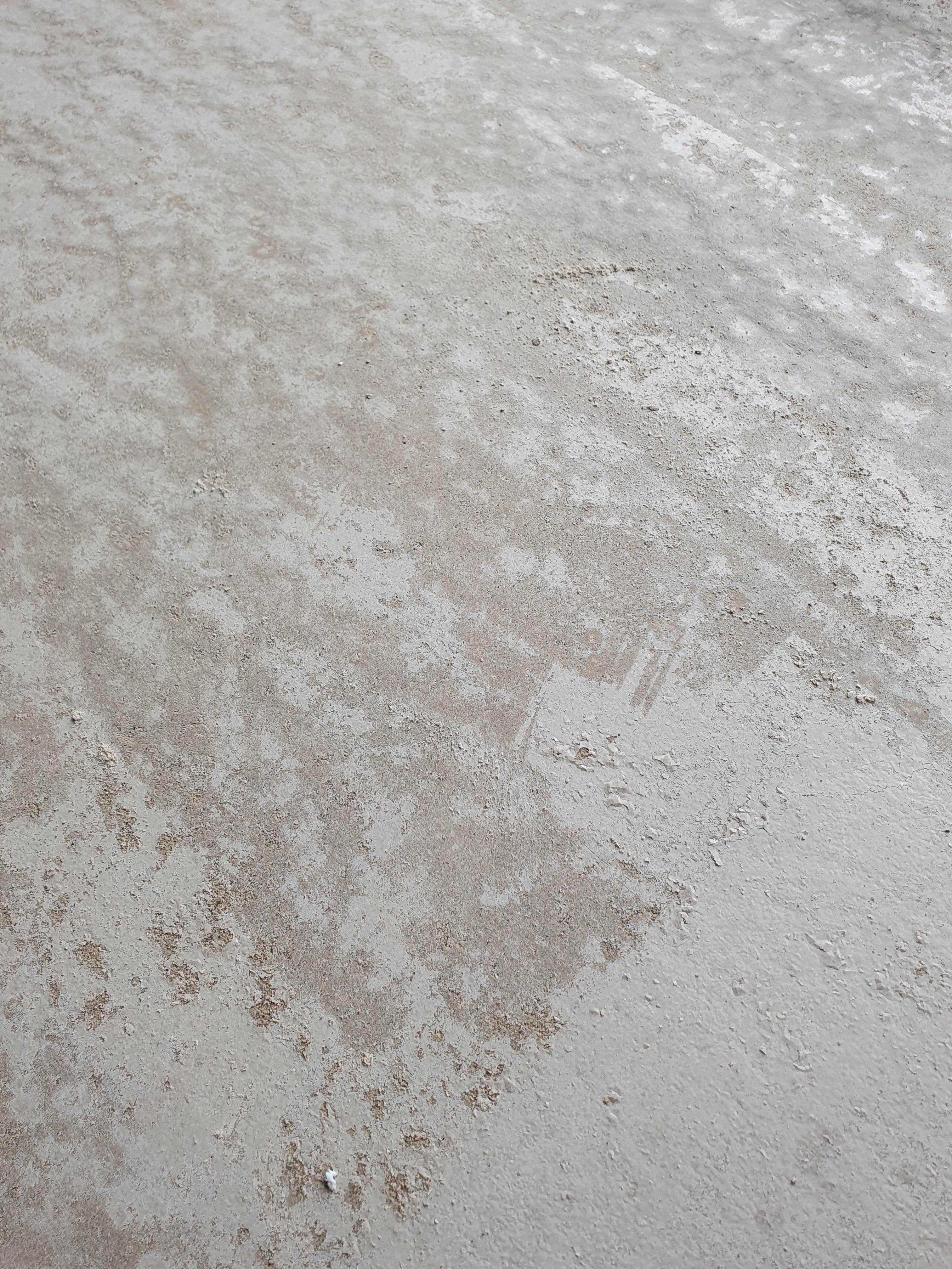

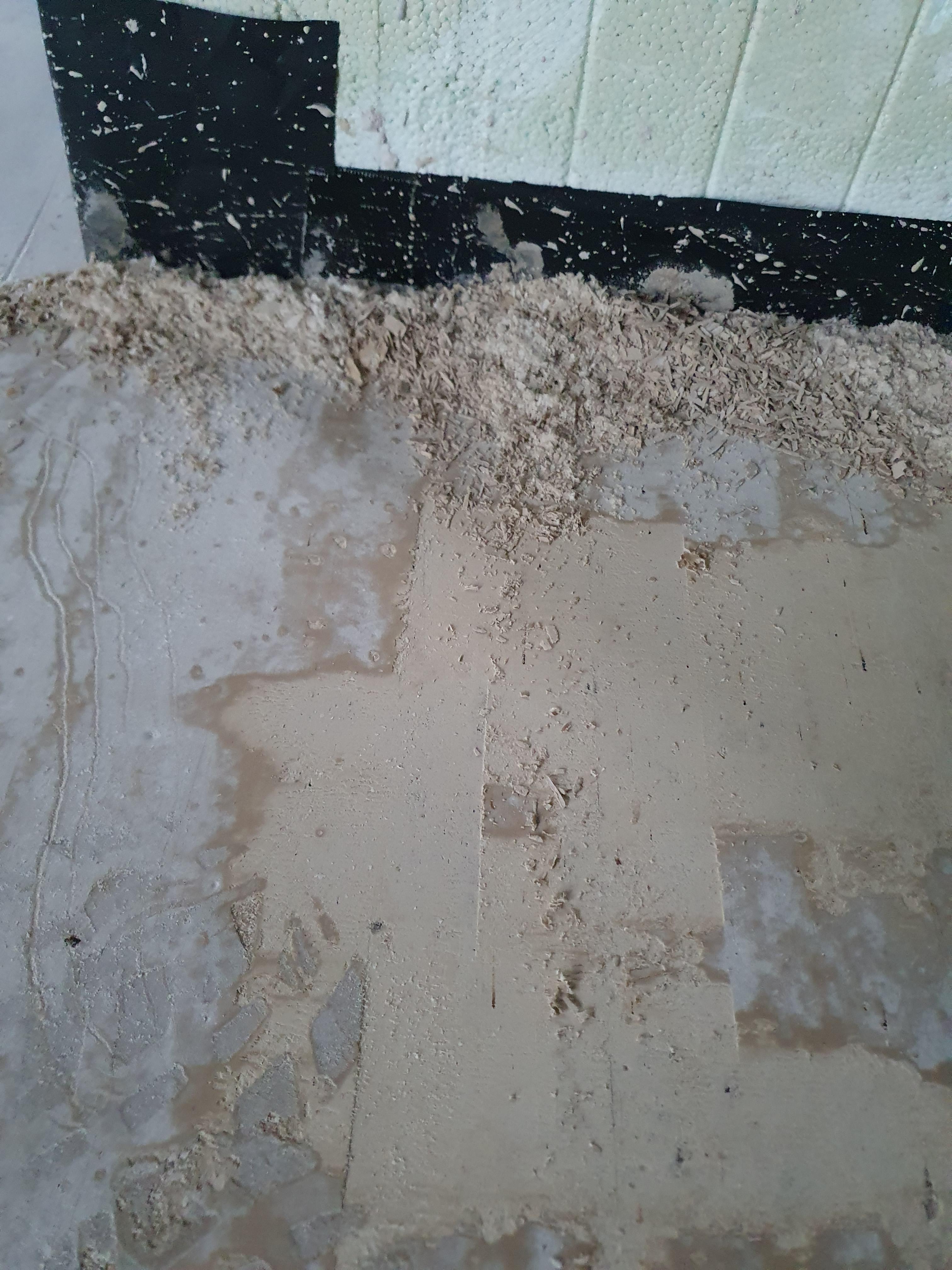

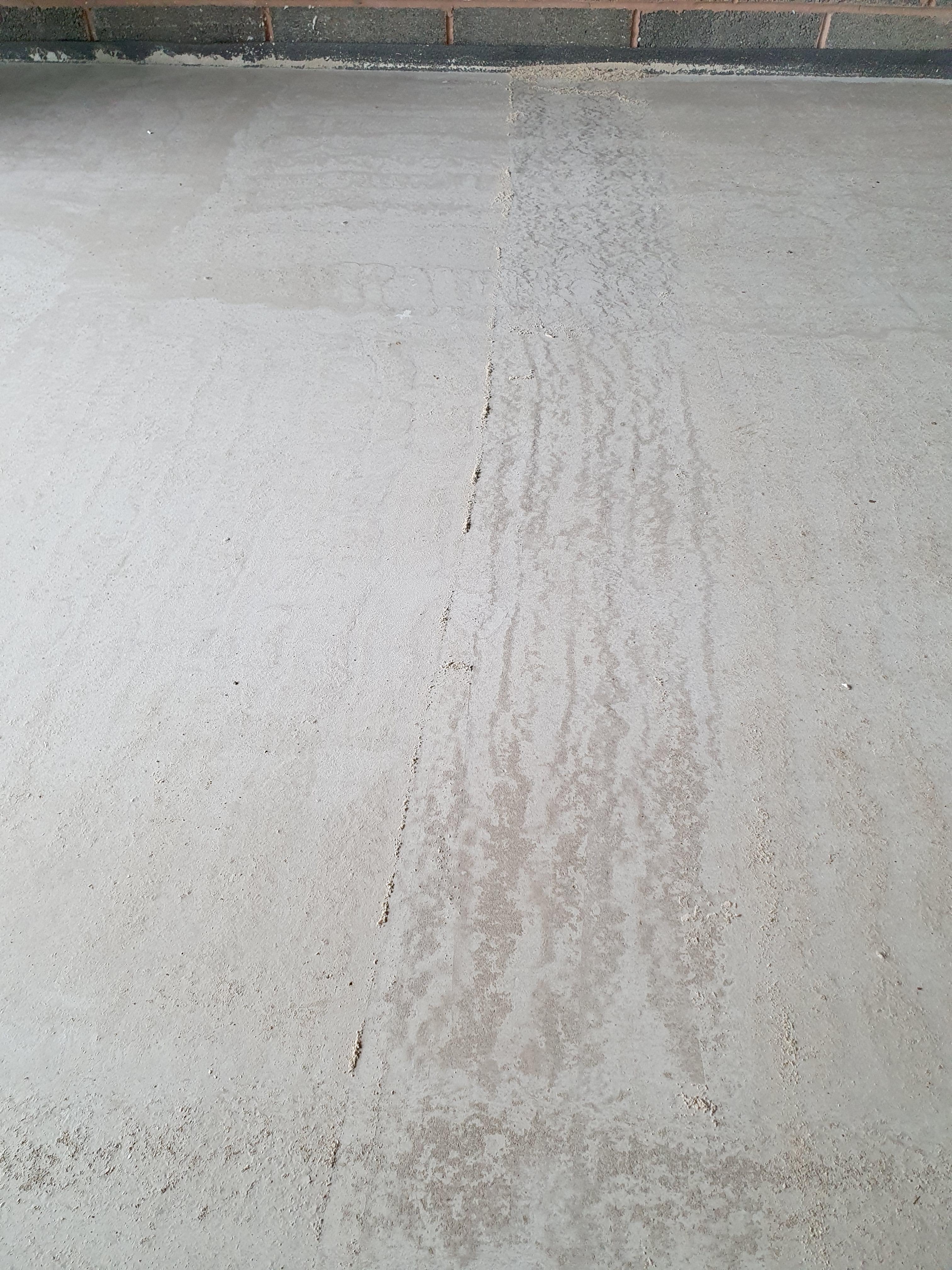

Tom Posted September 30, 2023 Posted September 30, 2023 Hi all - our anhydrite screedhas been down just over a week and I'm trying to s rape off the laitance. It's pretty hard going with a scraper, but when is enough enough? A few passes with it gets up a good load of the laitance, leaving the surface glassy smoothe but there still seems to be a bit there (see pics) , but do I need to keep going?
Kelvin Posted September 30, 2023 Posted September 30, 2023 This was why I didn’t go for this type of screed. I thought the recommended method was to use a sander to abrade the surface? When I researched it you keep going until the loose broken up surface becomes stable. The doesn’t isn’t the kind of stuff you want to be breathing in either.
Tom Posted September 30, 2023 Author Posted September 30, 2023 Hmmm, I was told a floor scraper would do it, and it's getting a good load up but there's still some left behind. I could keep going with the a scraper I guess, if I wanted the arms of Zeus. Looks like I might have to hire a sander. Is there a time limit for getting this stuff up before it gets too hard?
Kelvin Posted September 30, 2023 Posted September 30, 2023 The ideal time is between 7-14 days. A sander will be a lot less effort than scraping it off. Why make the build harder for yourself. Saying that I’ve just sealed our exposed beam using a wobbly ladder that is two rungs too short really

nod Posted September 30, 2023 Posted September 30, 2023 3 hours ago, Tom said: Sorry, don't follow you nod, an hour after what and a pass with what? As. Business we tile lots of liquid screed 3 hours ago, Tom said: Sorry, don't follow you nod, an hour after what and a pass with what? As part of my business we tile lots of these What doesn’t come off in one pass Doesn’t need scraping If it’s hard to scrape
Tom Posted September 30, 2023 Author Posted September 30, 2023 3 hours ago, nod said: As. Business we tile lots of liquid screed As part of my business we tile lots of these What doesn’t come off in one pass Doesn’t need scraping If it’s hard to scrape Thanks @nod, so my attempt at scraping in the pics above should do? Going over it again with the scraper lifts more off, but less and less each time. Are you saying one pass with the scraper then leave it?
nod Posted September 30, 2023 Posted September 30, 2023 Definitely As soon as it becomes hard going It’s time to stop
Tom Posted October 1, 2023 Author Posted October 1, 2023 Thanks @nod. I've been over the whole area now and while some areas seem easier to scrape than others, there are a few patches where the scraper digs in and the surface seems really soft, the consistency (and colour) of firm putty. Is this normal? It's been down for 10 days now.
