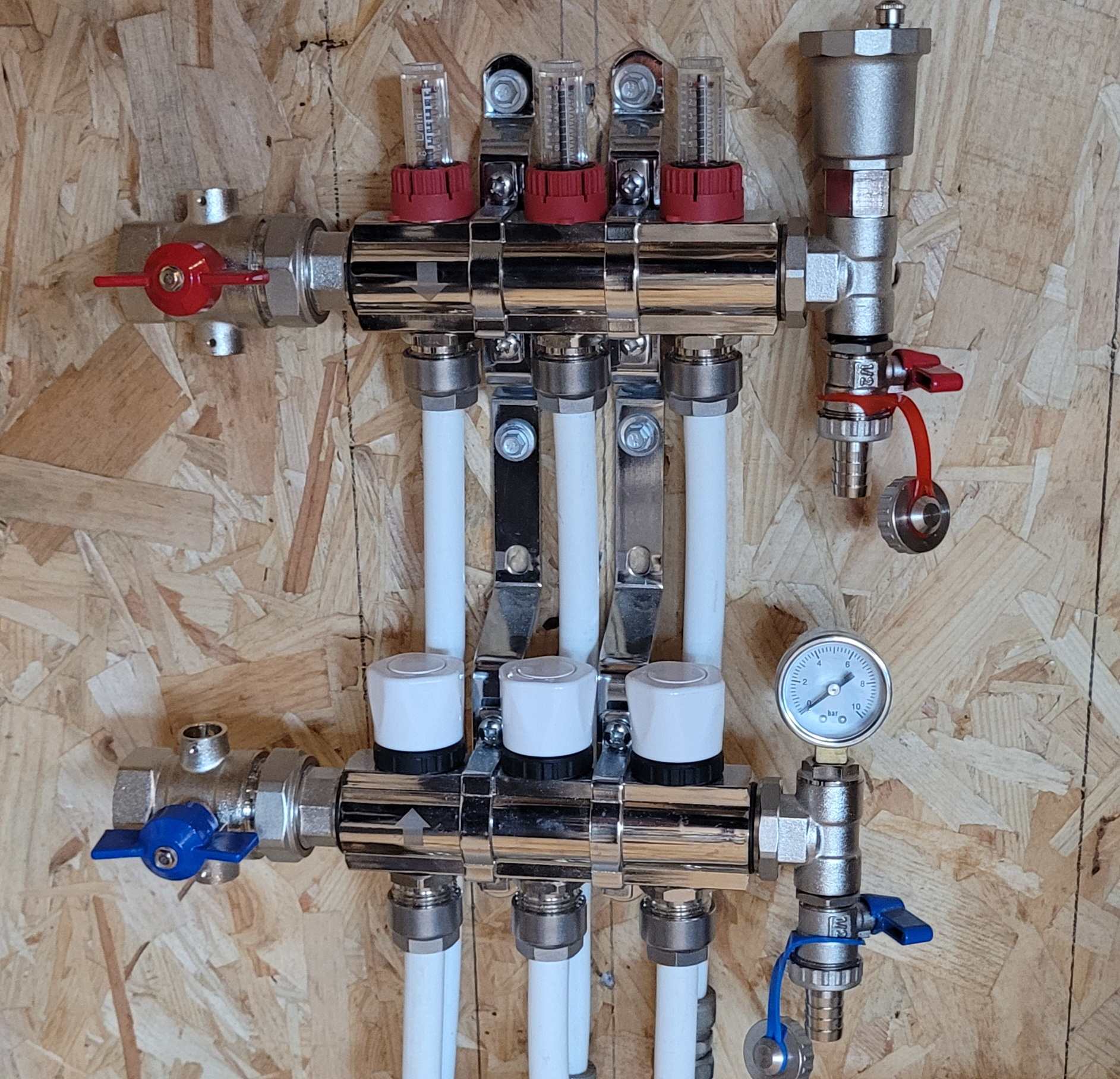

Sumo Posted September 26, 2023 Posted September 26, 2023 Hello, I am fairly convinced I have a manifold flow direction issue. I thank JohnMo and ProDave for there contributions in my introduce yourself post. I have a fifteen year old ashp-UFH, manifold system that I can not believe has been plumbed in REVERSE and thus has been costing my old parents a fortune all this time. Also confused how a Mitsubishi accredited engineer could comission it as fit, but that is not the issue. I know a manifold can be plumbed into the left side for flow and return whilst having a circulating/mixer pump on the right side, that would not be an issue. It is the fact that the FLOW is entering at the bottom and the RETURN is comming from the top, see below for the numbers, the flow should be through the top. When I disable the mixer pump I get zero flow/min through the meters(are they one-way flow meters? thus hitting the flow meters from the wrong side) dispite having two additional circulation pumps and the ashp pump working. With the mixer pump I get 1.5 to 3l/min depending on pump speed, though as you can see from the numbers below , it is not going in the right direction. It is like it is working against itself. I removed the actuators and opened up the temperature /mixer valve plus opened the manual ball valve whilst trying to fathom this, the mixing pump runs on wall stat demand? The infra red heat gun figures are the key. Any clarity to say yes you are right, swap the flow and return around , would be helpfull.

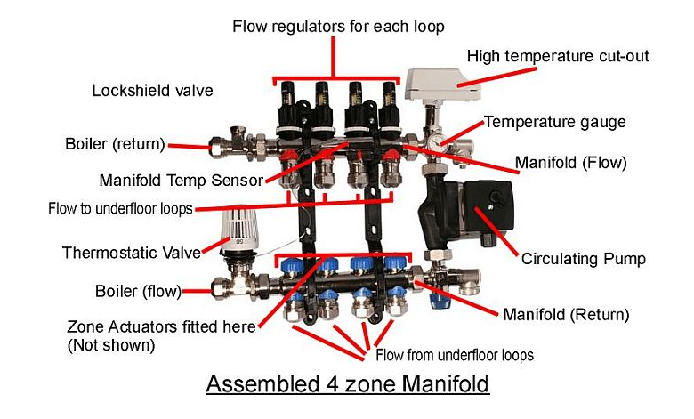

ProDave Posted September 26, 2023 Posted September 26, 2023 I repeat the diagram from the other post. Everything is working fine. Boiler flow 48c into bottom left boiler return 36c out from top left. UFH loop flows out from the floe meters on the top manifold 36c UFH loop returns back into the bottom manifold 26c What is the actual fault you are trying to correct?
Sumo Posted September 26, 2023 Author Posted September 26, 2023 Sorry, I still do not understand. If my flow temp in is 48 but my flow through the loop is 36, where has the 12 degrees c gone? And if my return flow into the manifold is 26, how does the return flow out of the manifold reach 36 suddenly? Also, not wanting to be difficult but how can we trust your picture when it is clearly labled in a contradictory manor. If you look at your picture, on the right hand side, it says "manifold(flow) and on the left it says "flow to underfloor loops" pointing to the top section. With "manifold(return)" on the right and "flow from underfloor loops" written underneath, pointing at the bottom section of the manifold. Then, if you look at the detail you are relying on, which is written to the left, it states "boiler return" from the top section (already twice discribed as the flow) and for the bottom section it is "boiler flow"(already twice discribed as the return) So the picture makes no sense. Sorry John, I have two heating engineers look over the system and neither has picked up on this as a fault, so I have to look closley for the solution.
ProDave Posted September 26, 2023 Posted September 26, 2023 You don't need to understand the inner workings in detail. UFH manifolds work by taking the incoming water from the boiler (or other heat source) and blending it with colder return water to give a controlled flow temperature into the UFH heating loops. If you just wanted to pipe raw hot flow water from the boiler into the heating pipes you would not want the blending system incorporated in this manifold. Most of them have the boiler flow and return on the pump / blending valve end so intuitively make more sense. I had not see your type before to I searched and found that diagram that seems to indicate it is connected correctly. Whether you or I understand what is going on inside does not matter. Yes the annotation on that drawing is poor, but it seems to be doing what it is supposed to.
JohnMo Posted September 26, 2023 Posted September 26, 2023 Certainly looking at the annotated photo, you have hot water going through the flow meters and return water at the bottom. How the mixing occurs doesn't matter as @ProDave says. It looks to be doing what it should be. With all UFH mixers there will be a higher temp going into the mixer than out to the UFH loops, 10 to 15 degs is pretty normal and that's what you have. The mixer takes some hot water from the boiler, adds some return water. So if you have 10l/min around the loops, you may take 6 to 8l/min from the boiler supply, the rest is reused return water. If you want to remove the pump and mixer and direct couple, you would put the flow in at the top and flow out at the bottom. Switching the pump of will give you zero flow, as the pump pulls the water through the mixer, the mixer acts as hydraulic sepereration. 1
Temp Posted September 26, 2023 Posted September 26, 2023 20 minutes ago, Sumo said: Sorry, I still do not understand. If my flow temp in is 48 but my flow through the loop is 36, where has the 12 degrees c gone? And if my return flow into the manifold is 26, how does the return flow out of the manifold reach 36 suddenly? The boiler flow (48) is mixed with the UFH return (26) to produce the UFH flow (36). We can even work out what fraction of each the mixing is using to make the UFH flow.. 48X + 26Y = 36(X + Y) X + Y = 100% Solving these simultaneous equations gives.. X = 45.5% Y = 54.5% So the 36C UFH flow is made up of 45.5% Boiler flow at 48C and 54.5% UFH return at 26C. 1 1
Sumo Posted September 26, 2023 Author Posted September 26, 2023 I think I know how and why mixers work, they seperate and mix flow and return dependant on target to protect the floor when you are running a system at a higher target temp to feed the rads than the ufh needs. My Thermostatic valve is set wide open above 60 degrees, so with a flow in of 48 and return of 36, no mixing is needed or should be happening? I checked the TV is opening and closing by listening to the flow changes/feeling resistance and also the pump tone changes. I plan on maybe removing the tv blender and just having the pump or a new grunfos model3, on pressure setting, at the flow entry. I just want to block heat my slab on economy 7, with no restrictions. How can you say it is working efficentley when actual flow temperature through the underfloor is a max of 36 with a delta 10 for a 26 return, yet the ashp is heating at a target of 48 and is prone to cycling off every seven minutes when it overshoots its target. If I set the ashp to a target of 37, I get 25 in to the loops, so it is not as though the blender is specificaly targeting the 36 I have now. I think I should be getting say 46.5 in through the loop with the ashp at 48, with a delta between 5 and 7 across the floor, so returning to the ashp with a delta 10 max.
JohnMo Posted September 26, 2023 Posted September 26, 2023 7 minutes ago, Sumo said: so with a flow in of 48 and return of 36, no mixing is needed or should be happening The way they are made there is alway flow mixing you cannot stop it. I tried two different makes before I realised. I have no mixer and no pump, just use circulation via the ASHP circulation pump.
Sumo Posted September 26, 2023 Author Posted September 26, 2023 Hello Temp, thanks for joining in. Yes, I had spotted the equation with in the numbers and I can see the theory. However I cant understand why any blending is needed. It is a bit like a false positive signal. Surely with the pump to the right , it is pulling water from the manifold in flow point, and the assumed lower return plastic pipes, this is then sent up towards the return flow and the assumed in flow floor loop. My question is, would all the water not take the path of least resistance, through the big copper return pipe, that has two additional pumps pulling on it, rather than through the loops. It is as though the water through the loop is only there as it is been dragged away from the return by the mixing pump, as opposed to being sent and circulated through the system.

Sumo Posted October 2, 2023 Author Posted October 2, 2023 Hello John, the pump arrow is pointing Upwards. So, the flow is entering via the lower "return manifold" where it is being "mixed" with the return's from the ufh loops. Then up through the pump, over the flow valves and out through the upper "flow manifold". Complete nightmare. Also the TMV is not a direct mixer valve, it is a single bored piece, with no direct mixing facility. The mixing being permenant, via the suction on the ufh return loops as mentioned, mixing the 48 celsius input with the 26 degree uf loop return's.

JohnMo Posted October 2, 2023 Posted October 2, 2023 On 26/09/2023 at 14:16, Sumo said: I am fairly convinced I have a manifold flow direction issue So how it works Water comes in to the system as noted in @ProDave drawing, via a temperature regulating valve. It comes in via a regulating valve which is sensing the water temperature of the upper manifold - the hot water (from boiler is mixed the return water in the manifold. The pump pushes water from the lower to upper manifold, around the loops and back to the boiler. On the upper manifold water is restricted from going back to boiler by the lockshield valve. The lockshield valve balances what goes back to the boiler and what gets pushed through the UFH loops. Your manifold is installed as it should be.
John Carroll Posted October 3, 2023 Posted October 3, 2023 14 hours ago, Sumo said: Hello John, the pump arrow is pointing Upwards. So, the flow is entering via the lower "return manifold" where it is being "mixed" with the return's from the ufh loops. Then up through the pump, over the flow valves and out through the upper "flow manifold". Complete nightmare. Also the TMV is not a direct mixer valve, it is a single bored piece, with no direct mixing facility. The mixing being permenant, via the suction on the ufh return loops as mentioned, mixing the 48 celsius input with the 26 degree uf loop return's. Yes, but achieves exactly the same objective, to give you the required hot manifold UFH temperate, I know these controllers as tapstats. There is no loss of heat, you have a lower flowrate with a higher dT on the heat pump side and vice versa on the UFH side, both balance. The HP will run with reduced efficiency if its required temp of 48C is required elsewhere like for HW production but your floor covering dictates a max water temp of 36C.

Sumo Posted October 8, 2023 Author Posted October 8, 2023 On 02/10/2023 at 19:29, JohnMo said: So how it works Water comes in to the system as noted in @ProDave drawing, via a temperature regulating valve. It comes in via a regulating valve which is sensing the water temperature of the upper manifold - the hot water (from boiler is mixed the return water in the manifold. The pump pushes water from the lower to upper manifold, around the loops and back to the boiler. On the upper manifold water is restricted from going back to boiler by the lockshield valve. The lockshield valve balances what goes back to the boiler and what gets pushed through the UFH loops. Your manifold is installed as it should be. Thank you for your patience JohnMo. I get it now. Once I got my head around the fact that it was actually meant to be this way. Uponor have recently been selling them, see below.
Sumo Posted October 8, 2023 Author Posted October 8, 2023 On 03/10/2023 at 09:27, John Carroll said: Yes, but achieves exactly the same objective, to give you the required hot manifold UFH temperate, I know these controllers as tapstats. There is no loss of heat, you have a lower flowrate with a higher dT on the heat pump side and vice versa on the UFH side, both balance. The HP will run with reduced efficiency if its required temp of 48C is required elsewhere like for HW production but your floor covering dictates a max water temp of 36C. Thank you John Carroll. I now understand a lot more and it is good to put a name to the tapstat. So my primary-ashp circuit is flowing across the manifold with a delta T of a) at x) flow rate but my secondary ufh circuit has a smaller delta T of b) and faster flow y) through the manifold. It is like the heat is being taken from one circuit to the other, as opposed to being given to the circuit. When pople have mentioned a figure of eight I could not conceptualize the flow's but if I see it as two slightly overlaping circles, with one trying to feed from the other it makes sense. On the floor covering/flow temp debate, we have stone tiles and carpet on concrete, would I be right in thinking they could take a 48 degree flow if I could achieve it? If so, I am wondering if a different manifold setup with more control on the minimisation of the mixing could be more efficient. I am wanting to avoid short cycling, which we often have, as when combined with the defrost cycles it means we are not using much of the economy 7 power for heating. It is more cost effective to run with a higher flow temp for a short period than a lower rate for longer when the electric is 3 times cheaper.
JohnMo Posted October 8, 2023 Posted October 8, 2023 3 minutes ago, Sumo said: different manifold setup with more control on the minimisation of the mixing could be more efficient Simple answer is they all mix flow and I tried a few before I dumped them all and now don't have a mixer. Flow out of ASHP equals flow to and through manifold.

MikeSharp01 Posted November 6, 2025 Posted November 6, 2025 On 26/09/2023 at 14:23, ProDave said: UFH loop flows out from the floe meters on the top manifold 36c UFH loop returns back into the bottom manifold 26c Just poking this thread as it came up in a GPT chat today as a reference. I think the flow and returns are mixed up here. Should the flow go in at the top and out at the bottom - well at least that is how the arrows point on ours and judging by the annotated photo same as for the OP. I guess my question is does it matter given the image above does it the other way around. I would have thought the flow meters would be single direction or is the image wrong?
JohnMo Posted November 6, 2025 Posted November 6, 2025 8 minutes ago, MikeSharp01 said: I think the flow and returns are mixed up here The marked up drawing makes sense. There is no mixing valve in the normal sense. The manifold allows hot water from boiler to mix with return water and the proportion is determined by taking a reference temperature from the upper manifold. The lock shield valve on the upper manifold acts as a gagging point to ensure flow goes through the loops and not just all take the easy route to the boiler. You need the over temp protection as if the inlet temperature regulator fails you send boiler water temp to the floor. Allowing boiler flow to top manifold, doesn't give any mixing down of boiler flow temperature, so wouldn't work.
MikeSharp01 Posted November 6, 2025 Posted November 6, 2025 So in a no mixing ASHP install that I am putting together the flow does go in the top and out the bottom which makes perfect heat flow sense to me? 35 minutes ago, JohnMo said: e is no mixing valve in the normal sense. The manifold allows hot water from boiler to mix with return water and the proportion is determined by taking a reference temperature from the upper manifold. The lock shield valve on the upper manifold acts as a gagging point to ensure flow goes through the loops and not just all take the easy route to the boiler. You need the over temp protection as if the inlet temperature regulator fails you send boiler water temp to the floor. This how it is set up here based on the manufacturers details, but I feel the air trap and pressure gauge are mixed up surely any air will get pushed to the outlet and you might want to know what the input pressure is - although not sure it matters.
