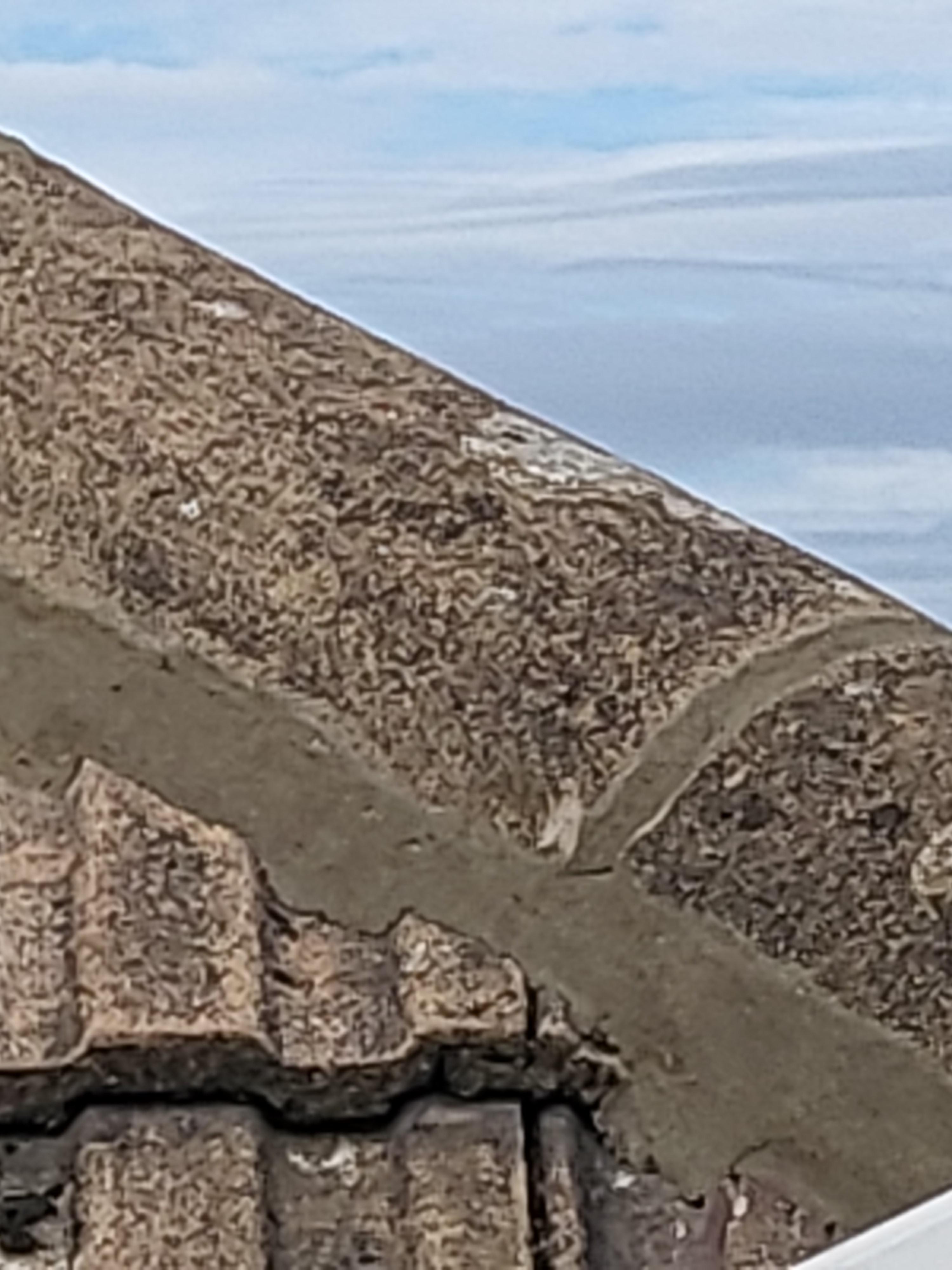

Gremlinz85 Posted September 24, 2023 Posted September 24, 2023 Hi Probably in the wrong forum. But I've had my roof ridge and hip tiles ground out and pointed with roofing mortar. The total bill of £2k. Now the roof is leaking like mad. The front looks like its bowed from where they have been walking up and down it. Is this normal practice for roofers/builders to grind out and butter up the ridges hips? Is this the right price to pay? The builder is refusing to rectify issues but wants to remove the valley reinstalling a new one to sort a new bedroom leak, yet this was not an issue until they ground it out. I went on their advice suggesting this would end condensation issues. But just getting on the step ladder can see there's cracks between a few ridge tiles. Thankyou for any help or advice

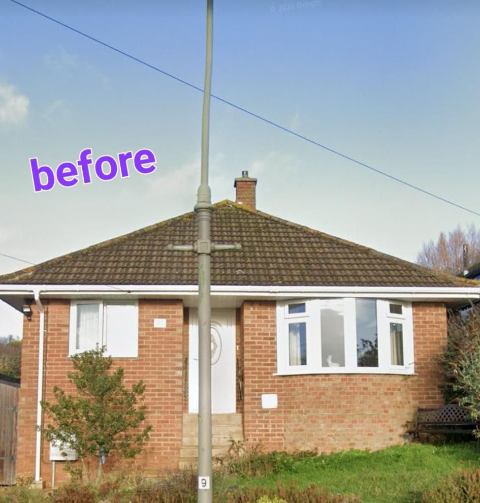

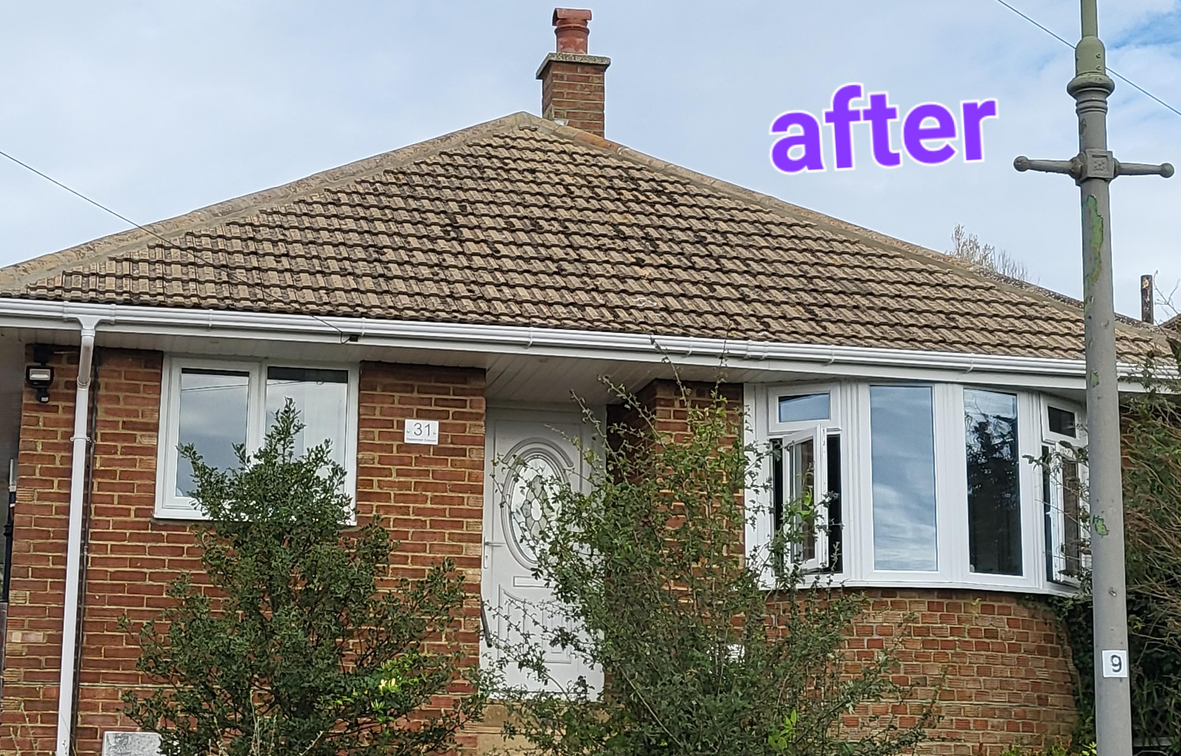

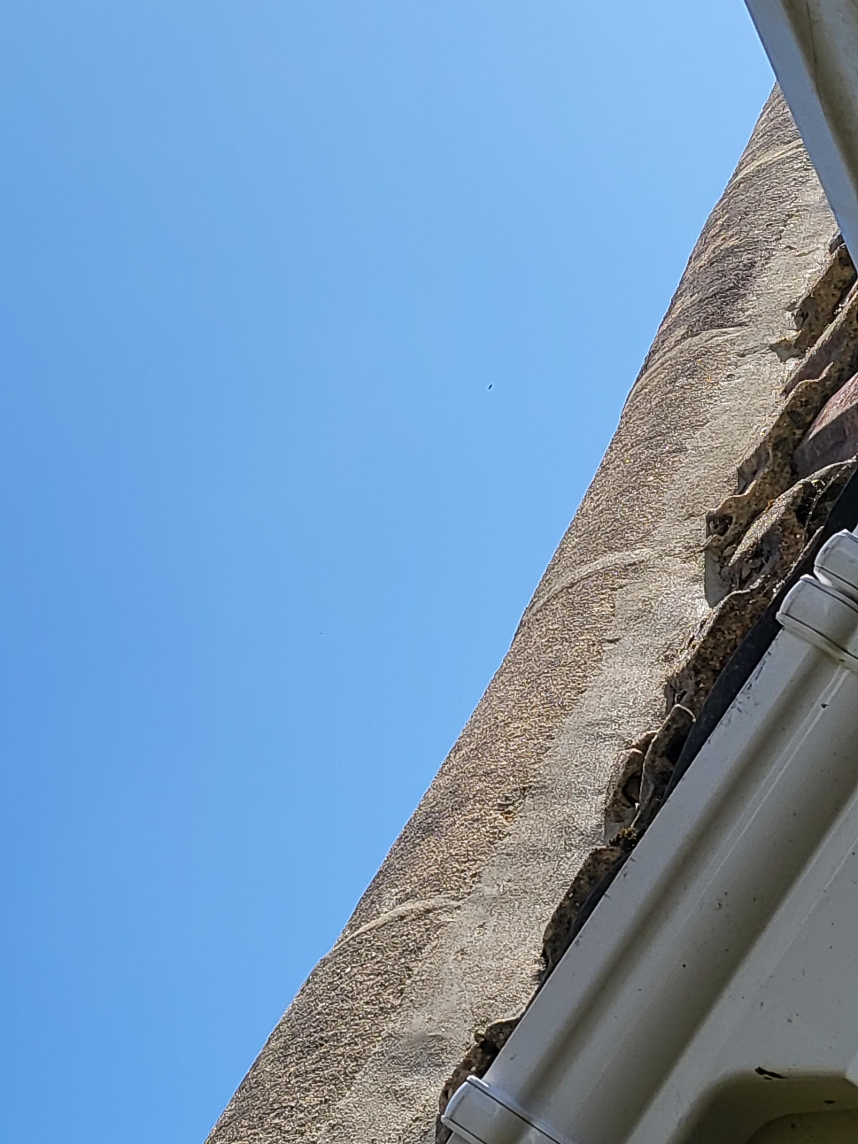

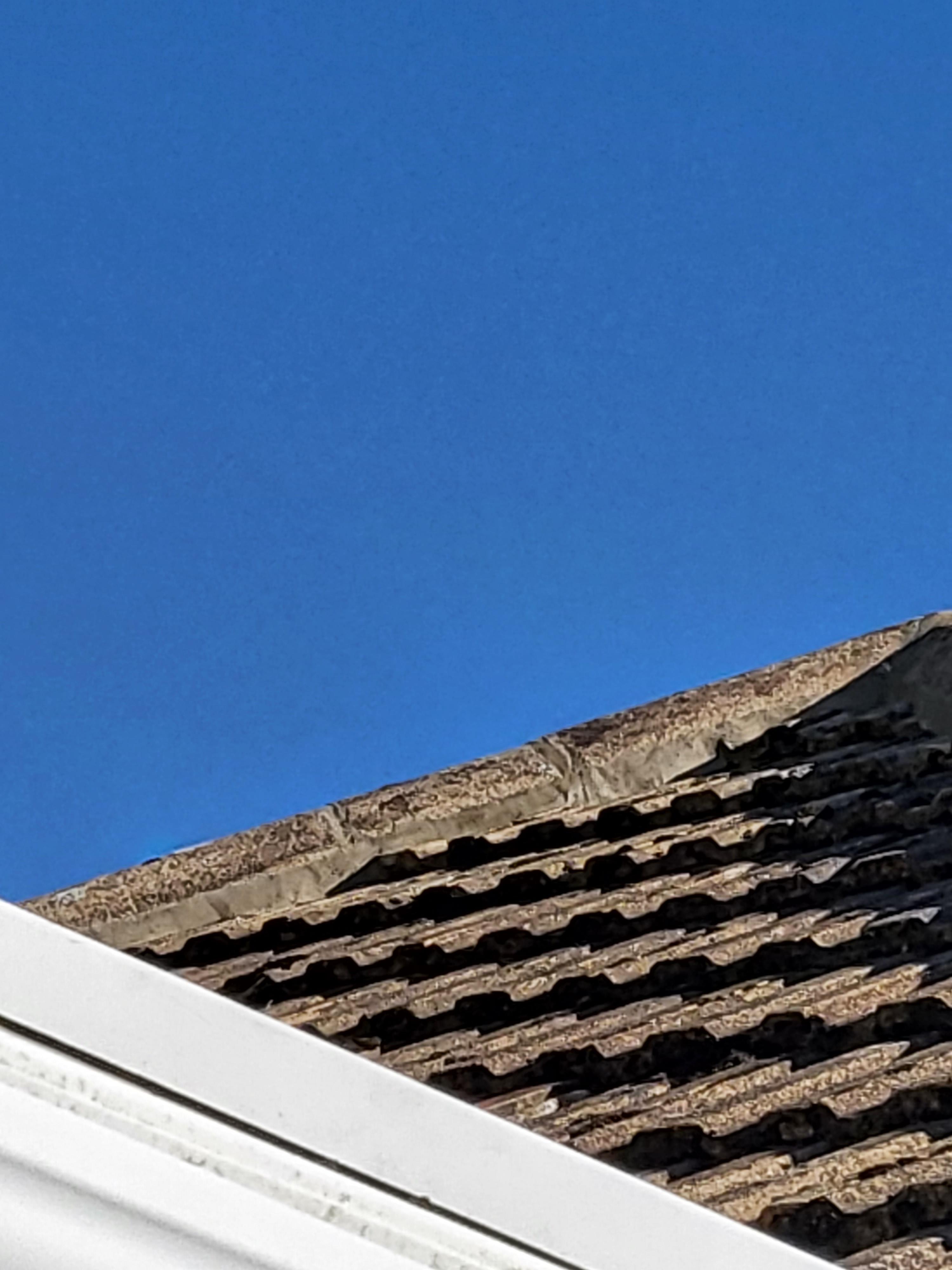

Gremlinz85 Posted September 24, 2023 Author Posted September 24, 2023 Thankyou both for your reply. My camera is terrible or i am trying to use it haha. But here is a before and after shot of roof. Doesn't look like much of a difference but the front tiles look flatter then they were. No scaffolding was used. They pushed a ladder against the front guttering and walked up and down the roof. The quote was grinding out ridge and hips also the valley and repointing them.
Gremlinz85 Posted September 24, 2023 Author Posted September 24, 2023 It's leaking in various spots in every room. But weirdly by the front door down the hallway. I can see a puddle in a cupboard further down and another patch roughly a meter away from the front door. But yeah every room seems to have at least one leak.
Mr Punter Posted September 24, 2023 Posted September 24, 2023 It should be fine to walk on. A dry ridge / hip setup may have been better as it does not rely on mortar joins. Maybe the battens and / or rafters are rotting? Can you see it from the inside? Any daylight? 1

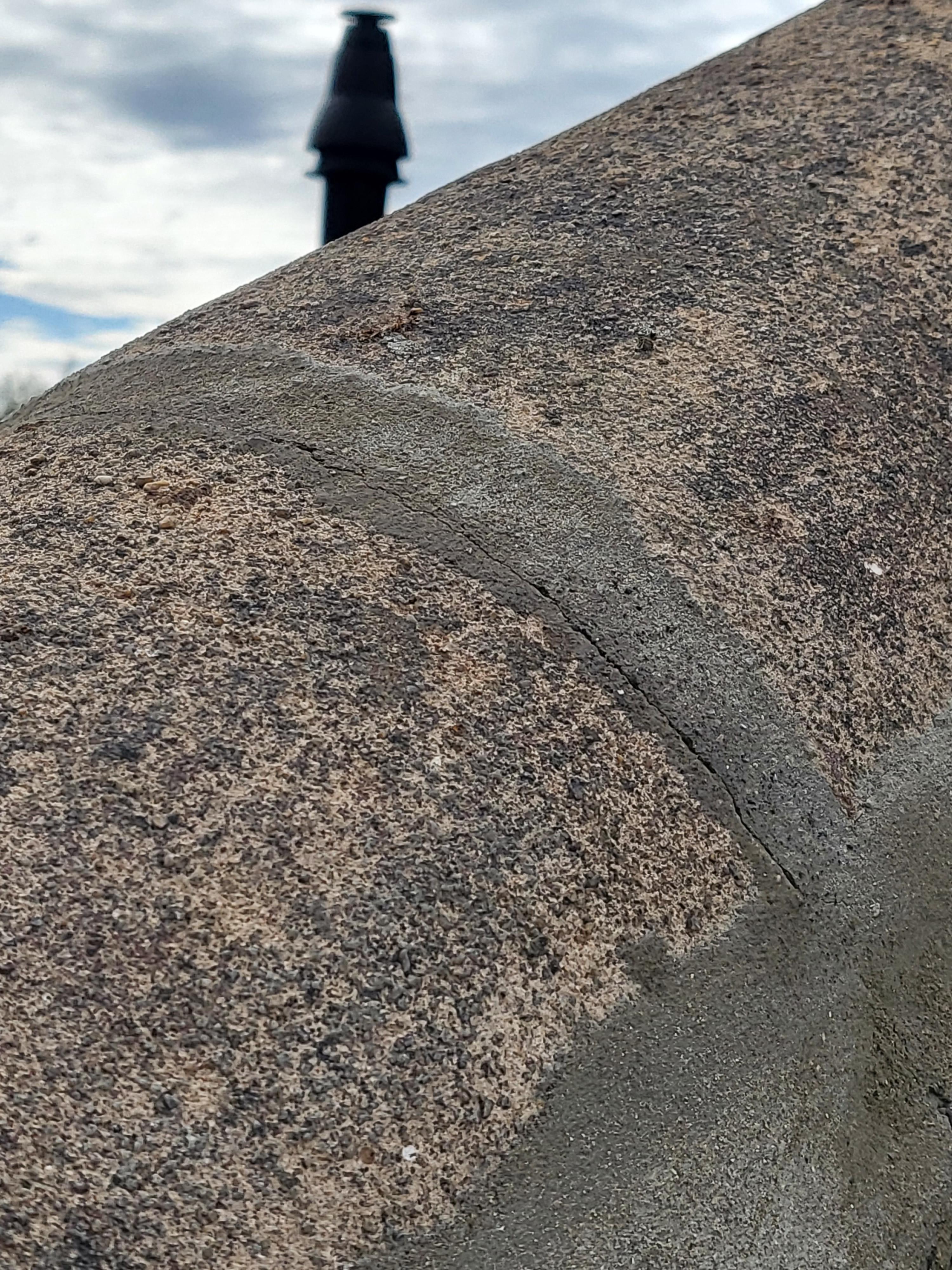

joe90 Posted September 24, 2023 Posted September 24, 2023 Walking on a roof is perfectly acceptable and I have done a great number. If your roof is leaking then the felt is knackered. The mortaring they have done is crap (in my opinion) the ridge and hip tiles should have been lifted, cleaned then re bedded on new motor, not buttered as they have done. If I had quoted for this I would have looked inside your loft to assess the felt condition and possibly recommended strip and re felt and batten using the same tiles if they were ok. I have done this on numerous houses. Best of luck getting a cowboy to give you’re money back I am afraid 1
ProDave Posted September 24, 2023 Posted September 24, 2023 the trouble with a roof leak, is where the water appears through the ceiling is usually a long way from where the actual leak in the roof is, and even with water appearing from multiple places it could all be a single leak in the roof. The only way to find it is a good look around inside the loft space with a torch when it is raining heavily and persistently. Only when you locate the leak can you move forwards and deal with it. It may or may not be related to the recent work. 1

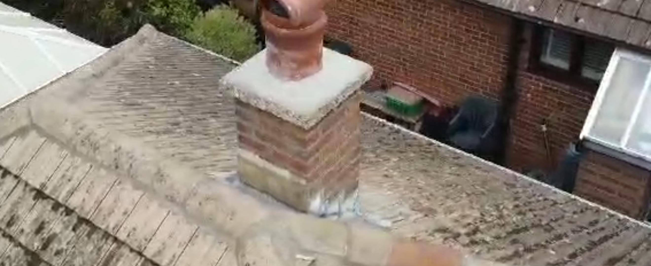

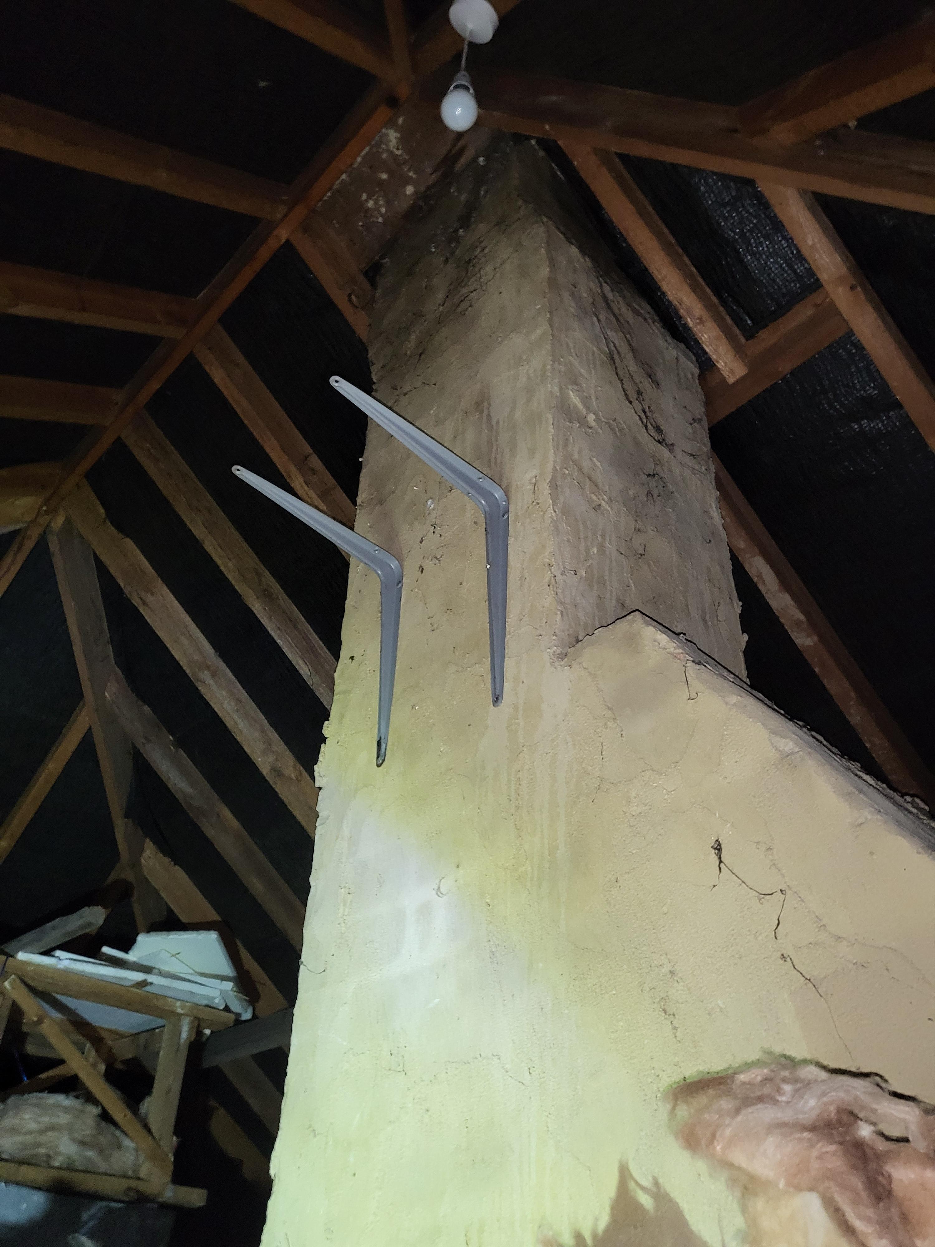

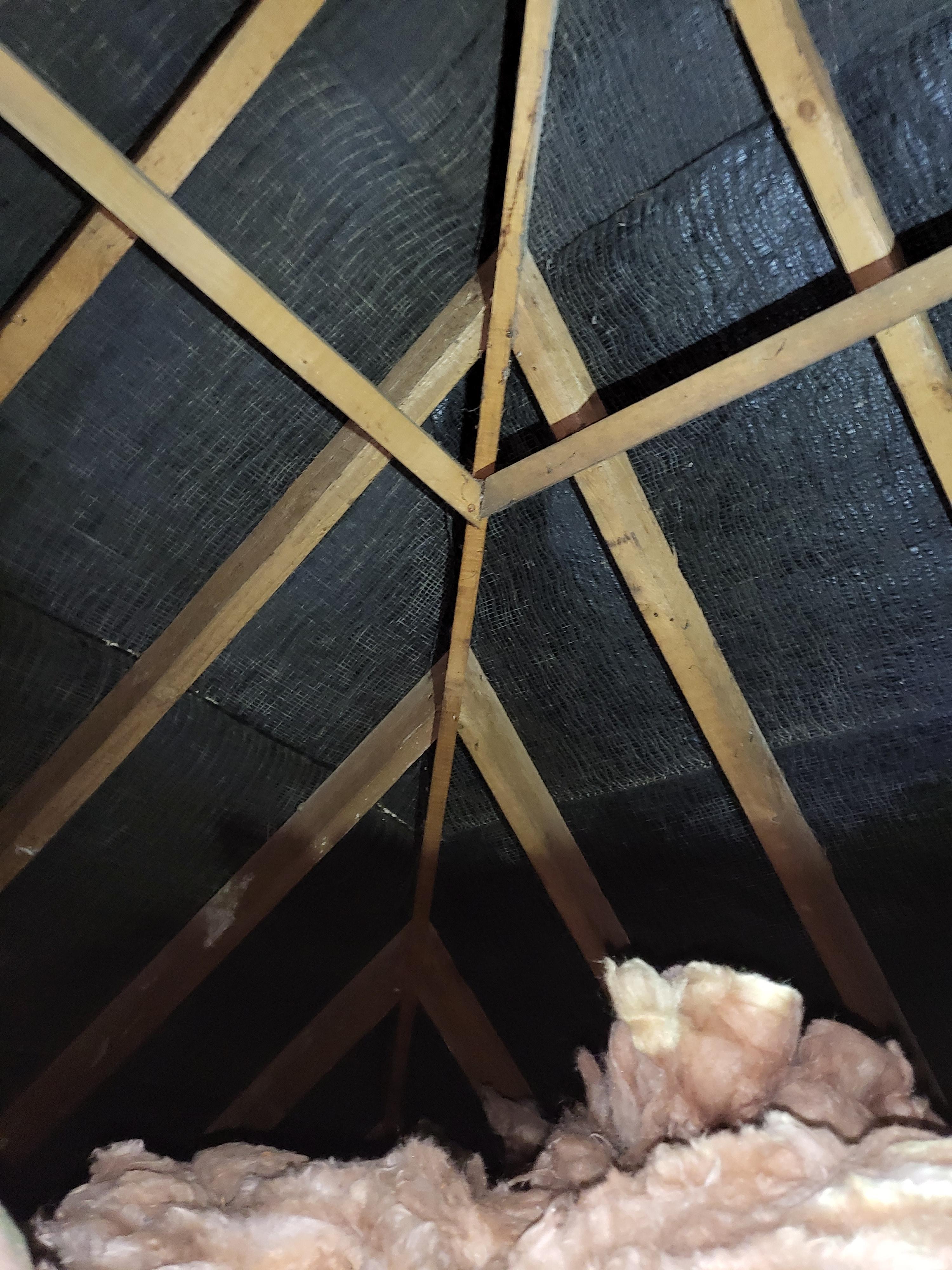

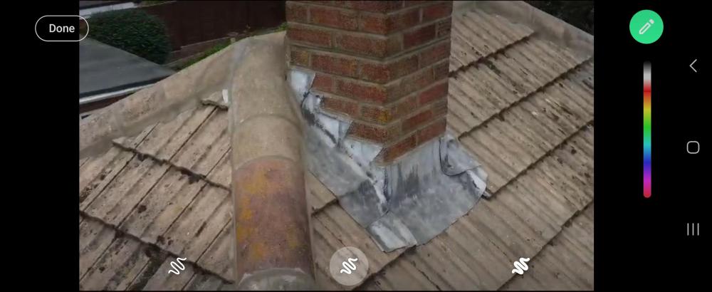

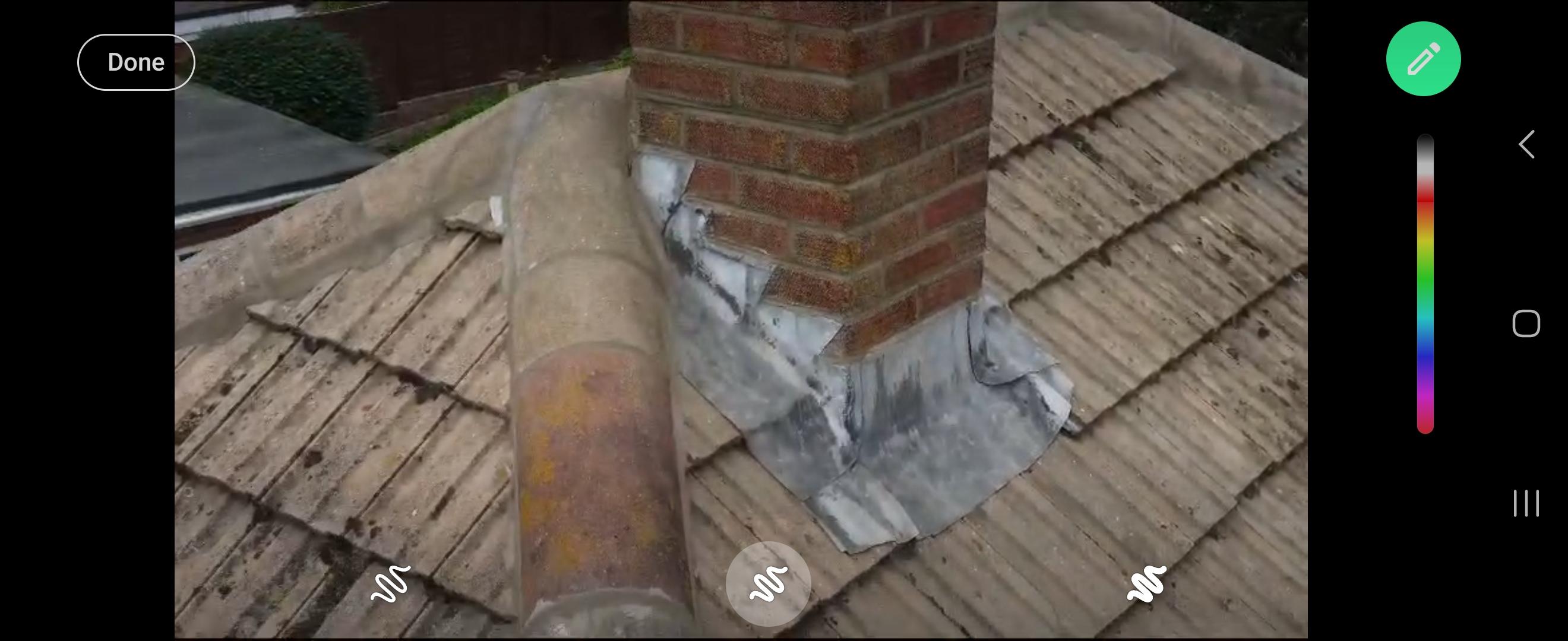

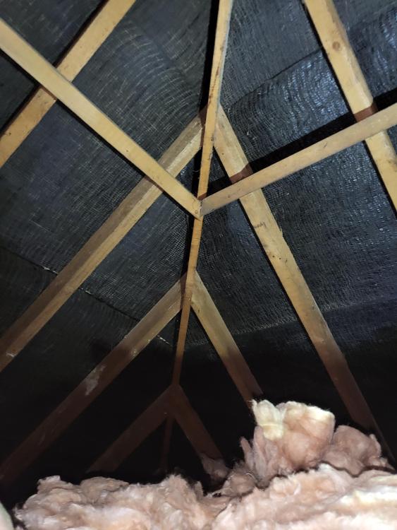

Gremlinz85 Posted September 28, 2023 Author Posted September 28, 2023 Thankyou all so much for your response. I've gathered my evidence for them so they cannot argue. My roof has dipped and also the chimney may be the reason for the other leaks as well as the other shoddy bits. Not sure what is occuring with the lead flashing around the chimney. The repointing looks also interesting. In the loft is where them beam across is no longer attached.
Gremlinz85 Posted September 28, 2023 Author Posted September 28, 2023 Chimney and loft photos are after 3 days of dry. Rains on the way tonight, so will see later if there are other leaks are causing my issues also. I have written to them again. So hopefully will get somewhere or at least an weird and wonderful excuse. 😄 🤣 😂 I was told he primed the valley and is yet to seal it. But surprisingly heard nothing on that again either. The builder stated my 87yr old neighbour previously took a seagull nest off my roof. I don't think builder realises we continually natter. 87yr old has a fear of heights/ladders and his near on 90yr old wife would definitely not be holding the ladder for him. I thought it was odd he never told me.
