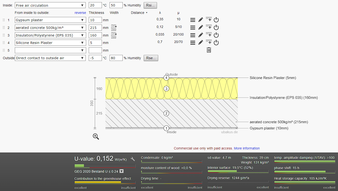

LiamJones Posted September 23, 2023 Posted September 23, 2023 The logic behind some choices; - the 70mm cavity, this is to allow the extension to match the existing cavity and avoid a tricky detail/thermal bridge between new and existing. - the external wall insulation, this will be being added to the existing walls, so it makes sense to run it through flush on the extension. N.b, plasterboard to be dot and dabbed to aerated concrete block, struggled to model it. I've also not included weep vents, i don't think i need them?

MikeGrahamT21 Posted September 24, 2023 Posted September 24, 2023 Another method, you could go 215mm block and 150/160mm EPS on the outside. you risk interstitial condensation with that build up, and would need some kind of check on the inside to avoid, I think you must have specified some wrong values on u-wert for it to not show.

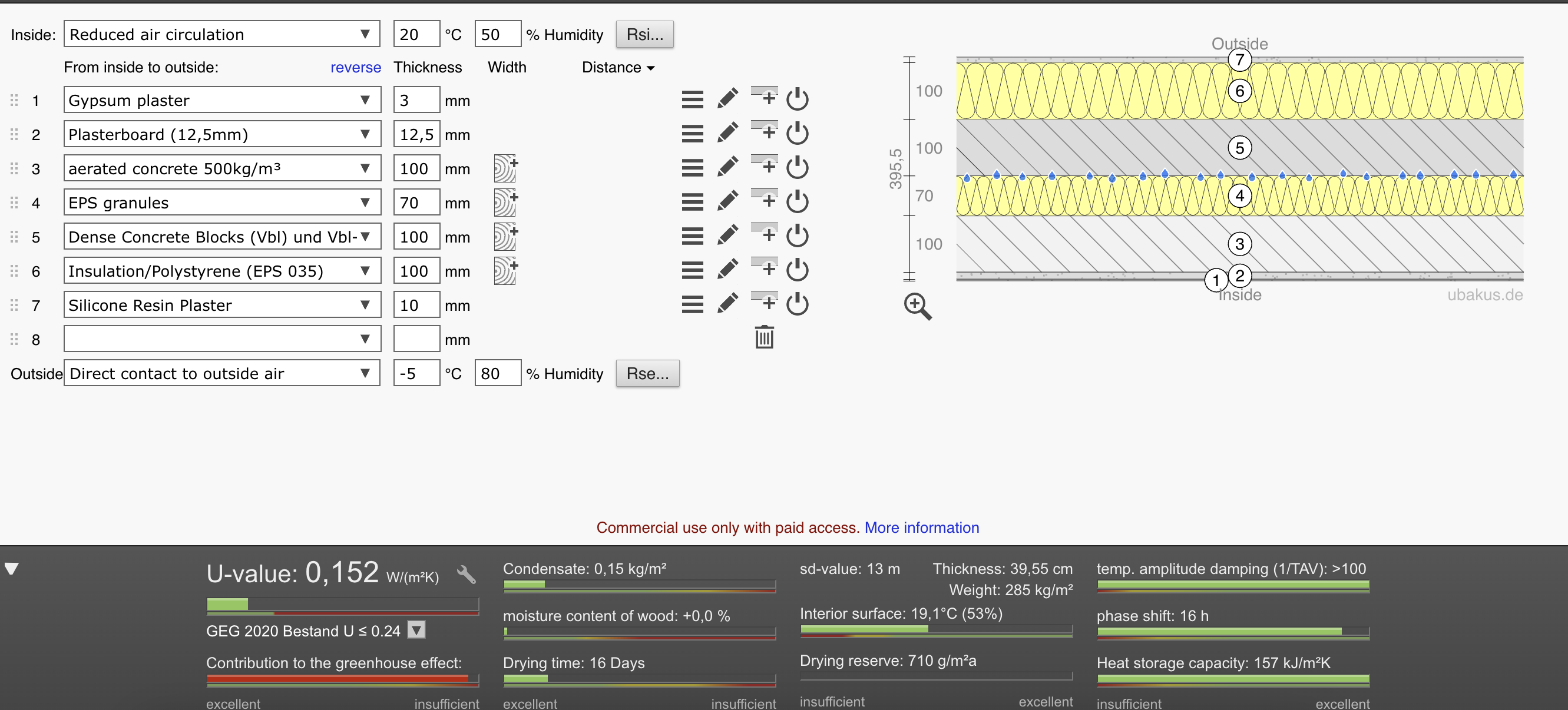

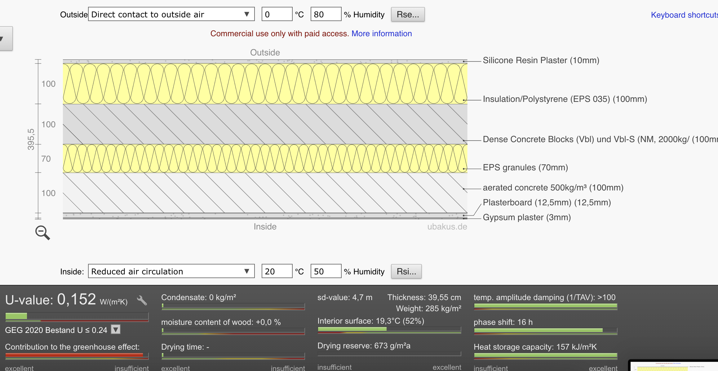

LiamJones Posted September 24, 2023 Author Posted September 24, 2023 Thanks for your comments @Russell griffiths @Conor @MikeGrahamT21 I want to use the same build up for the whole building, putting ICF on the end of a block cavity bungalow complicates things. It's only a small extension and i;ve got brick layers lined up to start in a week. I originally posted this more to check block choices and the dpc/weep vent requirements. To me, it just seems simpler to keep it all the same. Especially given i need to solve this problem on the existing bungalow. Regarding interstatial condensation, i modelled it using 0c/20c with no condensation. -5c/20c does have some condensation, but appears to be significantly less than the existing and within acceptable ranges, fully evaparorating in the drying season. If i swap the aerated blocks on the inner leaf to solid blocks, i can further reduce the condensate, and move the condesation point to outside the cavity. This reduces the uvalue by 0.02, but within regs (0.18 for new elements on exisitng dwellings) I'm no expert on interstatial condesation, but it all looks okay and within range. what am i missing? Thanks, Liam.

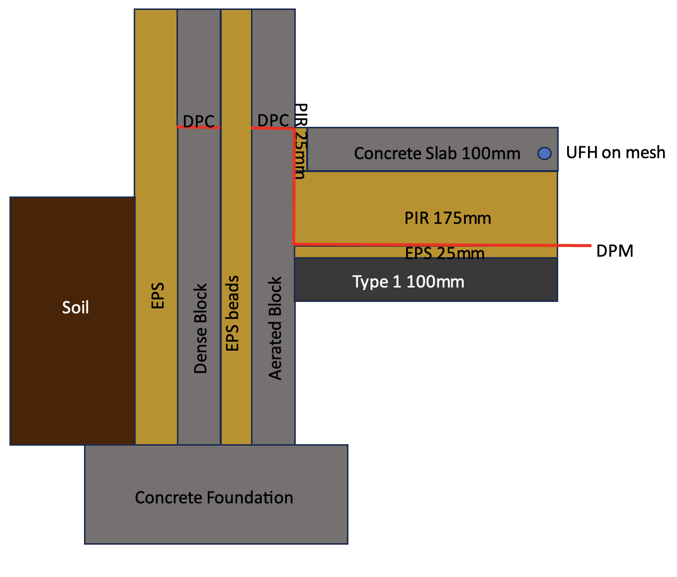

Russell griffiths Posted September 25, 2023 Posted September 25, 2023 Ok ditch the celcons, should you have a tray dpc to shed any water to the outside???
LiamJones Posted September 25, 2023 Author Posted September 25, 2023 On 25/09/2023 at 08:25, Russell griffiths said: Ok ditch the celcons, should you have a tray dpc to shed any water to the outside??? Expand I’m not sure? In theory, the bottom of the cavity is way below damp, so it doesn’t really matter which way it goes?

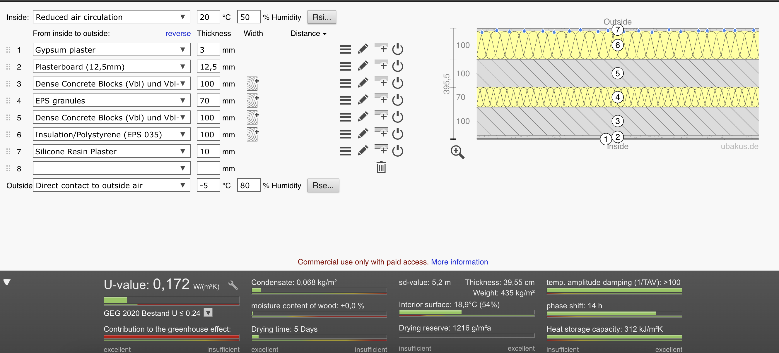

MikeGrahamT21 Posted September 25, 2023 Posted September 25, 2023 If you swap out the aerated blocks for dense blocks on both leaves, then you won't have any risk of condensation at all. Or the alternative method, with 215 blocks:

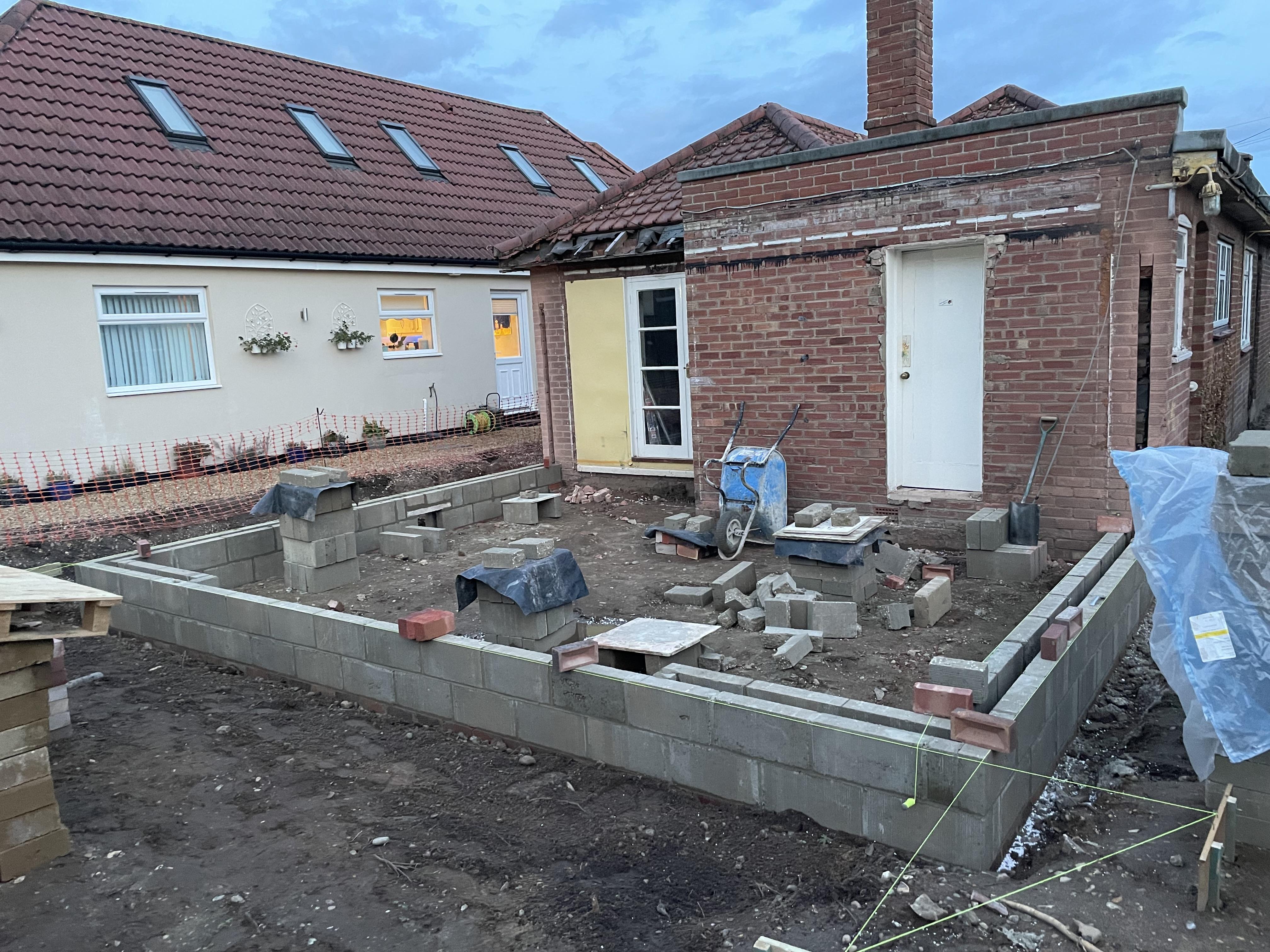

LiamJones Posted October 4, 2023 Author Posted October 4, 2023 Hi, thanks for all your opinions and advice! I’ve decided to go with medium density blocks to both skins. Combined with the EPS bead cavity and EWI gives me a very small condensate point way out in the render and a u value of 0.16. Here it is going up 1
LiamJones Posted October 4, 2023 Author Posted October 4, 2023 Oh, and BC advised happy with full full cavity to the foundations with no tray or weep vents, given I was EWI and render to prevent driving rain.
LiamJones Posted October 4, 2023 Author Posted October 4, 2023 (edited) I landed on the medium density blocks as a happy middle ground lightweight/aerated Low thermal conductivity Low sound attenuation lightweight for the bricklayers, less labour more expensive material more fragile, less ability to fix things to. less airtight heavy density High thermal conductivity high sound attenuation heavier for bricklayers, more labour less expensive material High ‘thermal mass’ Better airtightness medium density’s sat in the middle for all of these properties and are a good balance in my opinion. Edited October 4, 2023 by LiamJones Formatting
