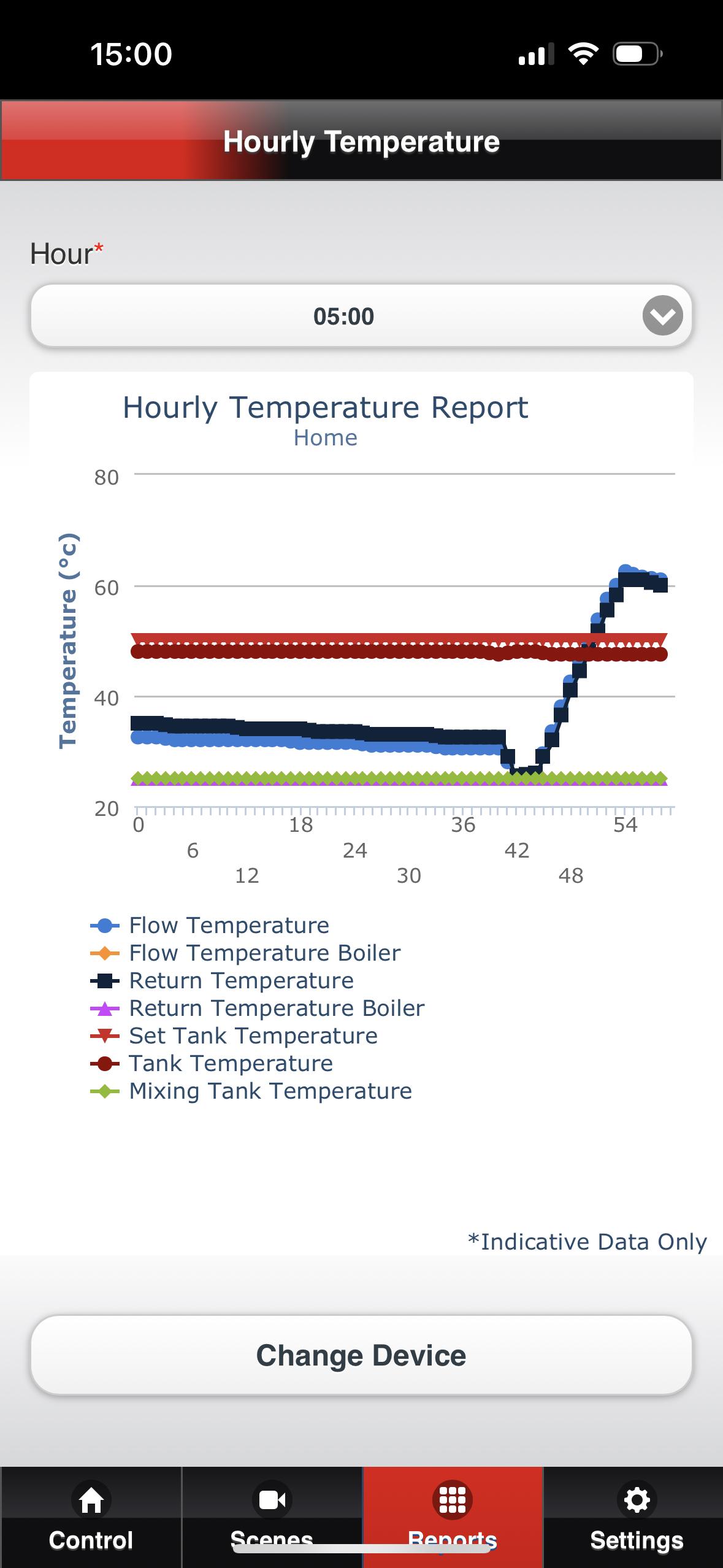

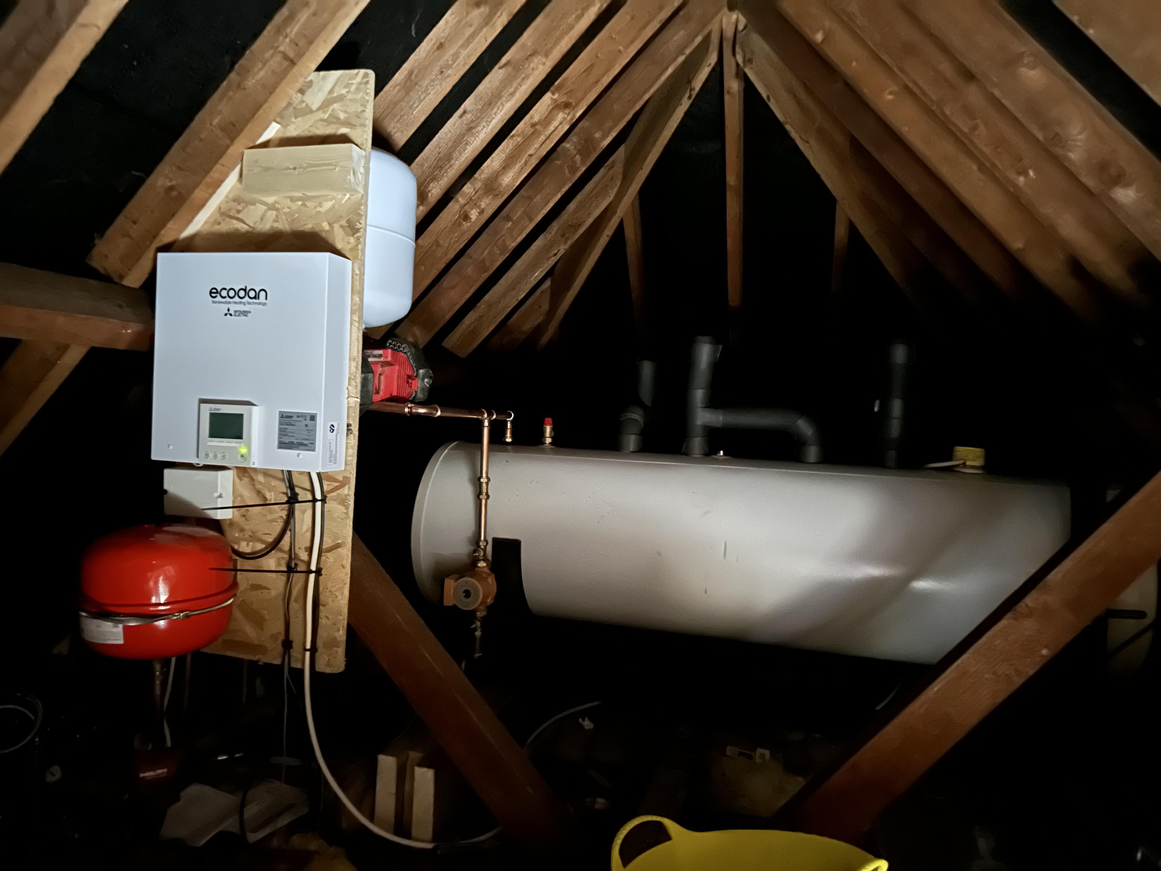

Crustydoodle Posted September 21, 2023 Share Posted September 21, 2023 Hi all, I am new here so hopefully posting in the right place and this is OK to ask. We have recently had the following installed: Mistubishi Ecodan R32 11.2kW Mitsubishi FTC6 controller Underfloor heating throughout (Heatmiser controlled) The Mitsubishi cylinder is horizontally mounted in the loft as shown in the picture. We are seeing a behaviour which our installer said should not happen and yet Mitsubishi claim is 'normal'. Every 2-4 hours, the ASHP will activate when there is no call for hot water or heating (and no legionella cycle). The Hot water calls appear to be normal and happen as expected. We were told that the ASHP should only really come on at the moment when the hot water needs bringing back up to temp. This is clearly not the case and now the installer is backtracking following a call to Mitsubishi. I've complied a full day of hourly traces into one image (attached) that shows these spikes in the form of flow and return temperatures spiking, then gradually dropping and then triggering to spike again when it hits around 25degC. On this trace you can also see a hot water call and the cylinder temp rising to the correct level. We also tested the heating last night so you can see some activity around that. We can also hear that water is being pumped through the services in the wall on the internal side of the setup - not sure if it is requesting water or wasting water or both, but it is coming from where the mains connects into the ASHP setup and where the ASHP connects down to the UFH manifolds. As a side note, we did have an L9 error as well but this has not returned and so we think it is not related. The main issue is that the pumps and water movement in the loft is noisy enough to wake us in the night. We are very tired! I am not convinced this is normal behaviour - if it is, then we have a major issue with constant noise through the night. The 2 other Ecodan users I know do not see this happening. Any ideas or seen this behaviour before? Thanks in advance Link to comment Share on other sites More sharing options...

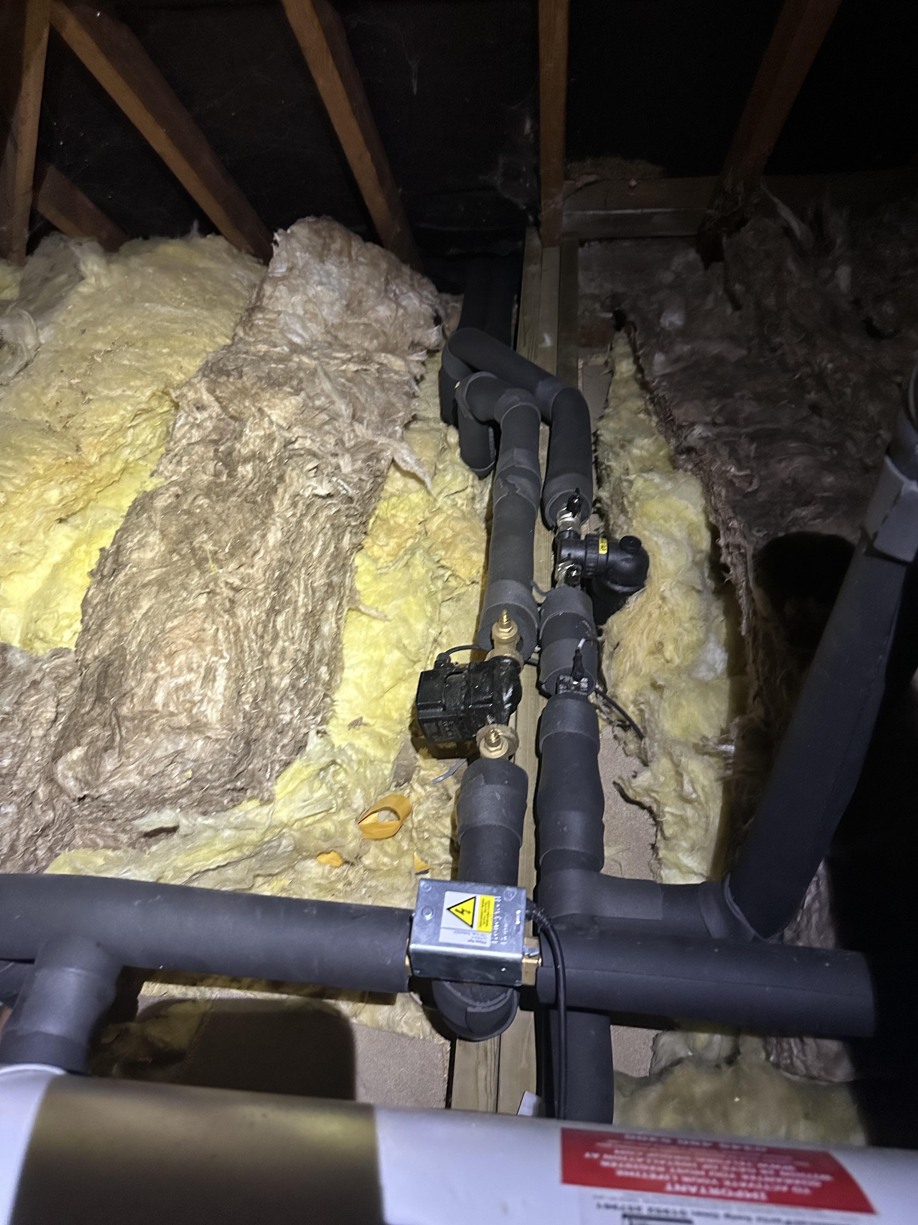

HughF Posted September 22, 2023 Share Posted September 22, 2023 Is that a grundfos selectric bronze secondary return circulator? It looks very similar to one I have on the floor at the moment. If so, I expect that it's the call for heat from the cylinder temp sensor, as the secondary return is draining the cylinder heat away. Link to comment Share on other sites More sharing options...
Crustydoodle Posted September 22, 2023 Author Share Posted September 22, 2023 1 hour ago, HughF said: Is that a grundfos selectric bronze secondary return circulator? It looks very similar to one I have on the floor at the moment. If so, I expect that it's the call for heat from the cylinder temp sensor, as the secondary return is draining the cylinder heat away. I believe it is. That pump comes on when there is a call for hot water and circulates the tank (I think). When the random ASHP activations happen every couple of hours, it does not come on - the one that activates is the black one in this picture which is on either the in flow or return from the ASHP (although I am struggling to get to it to confirm that!). Link to comment Share on other sites More sharing options...

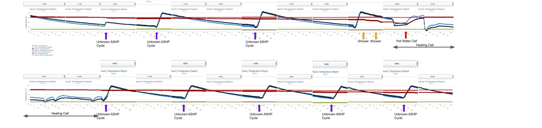

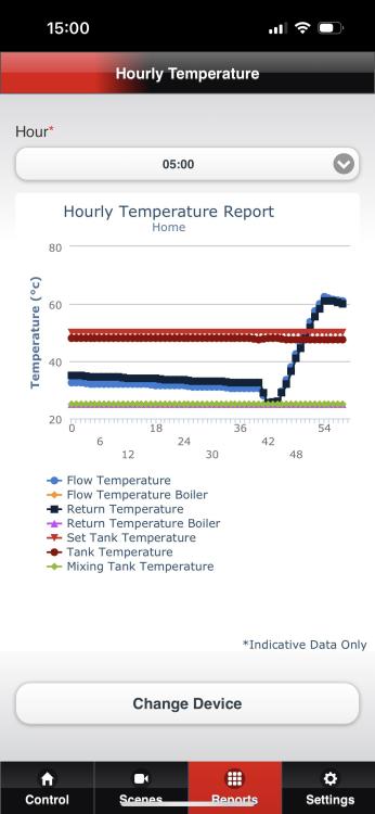

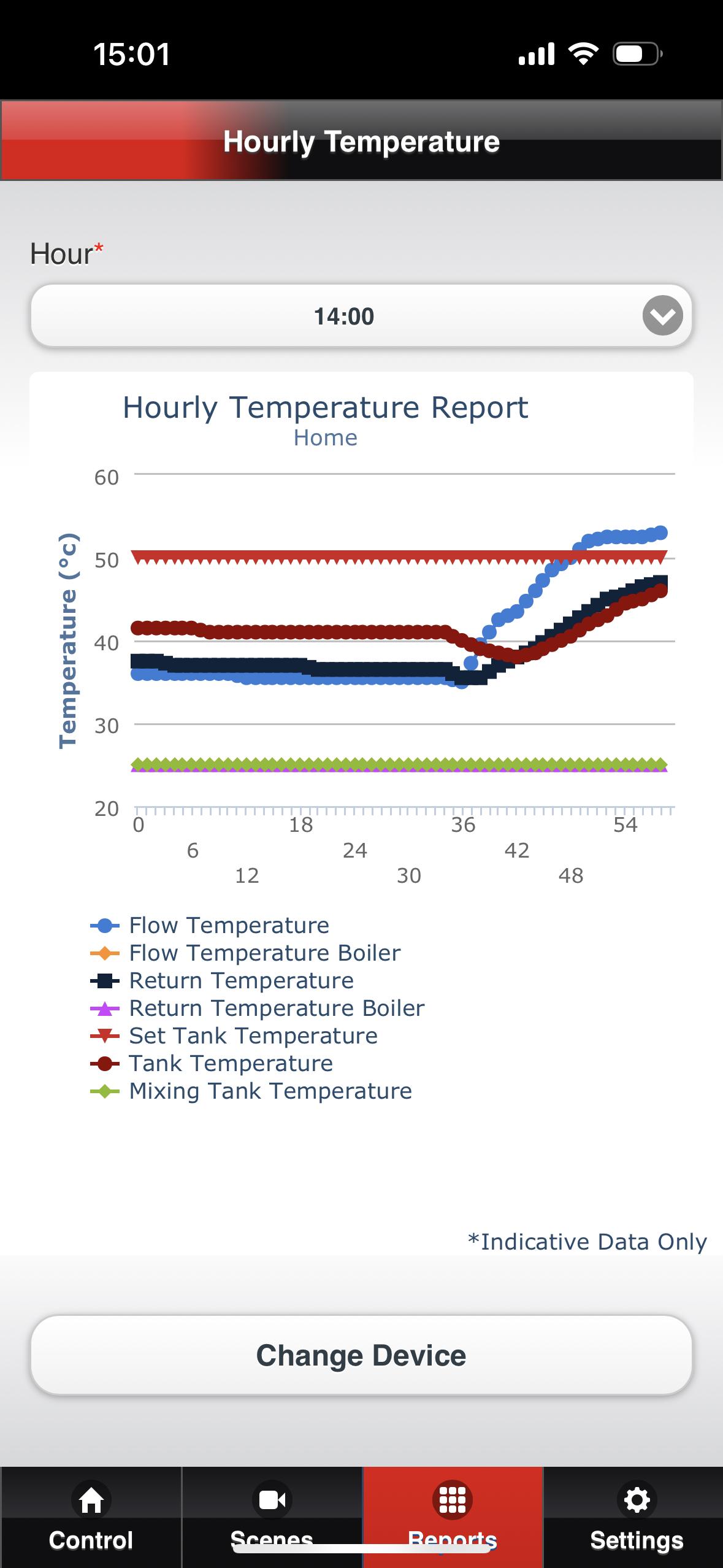

Crustydoodle Posted September 22, 2023 Author Share Posted September 22, 2023 (edited) Nope, when the heat pump is running on those activations hat happen every 2-3 hours, it is not trying to heat anything as far as we can tell. The flow and return temps rise up, but this is not affecting the DHW and the heating is off. This happens around 8 times per day. When there is a call to heat up the DHW, this also activates the ASHP and the cylinder temp rises back to 50degC - this happens around once per day. The reheat threshold is 10 degC below the 50 and that seems to be working fine. Traces of the two types of activation we see are attached - First image is a normal hot water call and you can see the red trace for the hot water temp rise. Second image is one of the random activations where the overlapping flow and return temps drop to ~30degC, then dip and rise together to ~60degC - no call for heating or DHW. Edited September 22, 2023 by Crustydoodle Link to comment Share on other sites More sharing options...
Gary68 Posted September 22, 2023 Share Posted September 22, 2023 In the random activations the temperature is getting to 60°C very quickly suggesting its heating a very small volume of water, what temperature do you have the heating flow set to does that align with the 60°C? If so then the ashp is getting a call for heat from somewhere but none of the pumps are activating hence the rapid increase in flow temp. You said the UFH is controlled by heatmiser maybe there is an issue with how that's been wired to the ecodan controller. Link to comment Share on other sites More sharing options...
Crustydoodle Posted September 22, 2023 Author Share Posted September 22, 2023 Yeah - my gut feel is that it is just heating whatever is in the loop to the ASHP, possibly something in the UFH loop, but I am very far from an expert. The legionella cycle is set to 60°C but that is on a 7 day cycle, was at 5am but now at 2pm Other temp settings from the summary: Hroom1 30°C HFlow1 55°C Croom1 20°C Cflow1 15°C HWtemp 50°C HWDRop 10°C Link to comment Share on other sites More sharing options...
