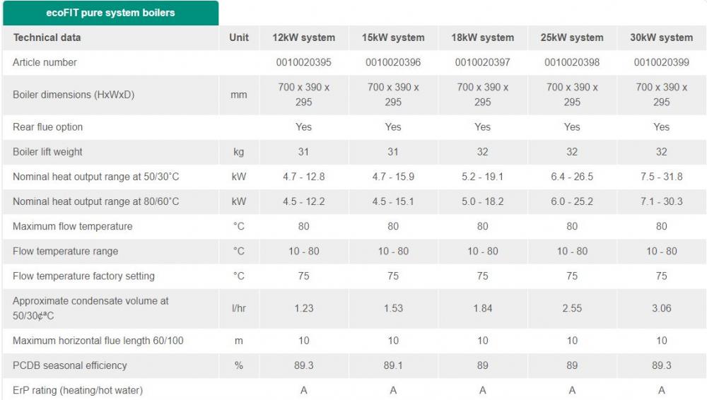

s2sap Posted September 3, 2017 Author Posted September 3, 2017 8 minutes ago, Nickfromwales said: For my curiosity, why LPG when you could have an ASHP ? I have done this decision to death and resurrected it many times There are several reasons why we are going LPG mainly initial capital outlay and potential length of stay in new property but not that reason alone - and we now need to make the LPG system as efficient as possible. We may change to ASHP in the future but as things stand right now its going to be LPG boiler so I need to figure out the right setup 13 minutes ago, Nickfromwales said: You need to calculate your delta flow temp and then work out your ventilation and fabric heat losses. From there you will know your 'idle' kw requirement How do I do this - will a SAP calc be sufficient - if so I can upload one - if not where do I start?
