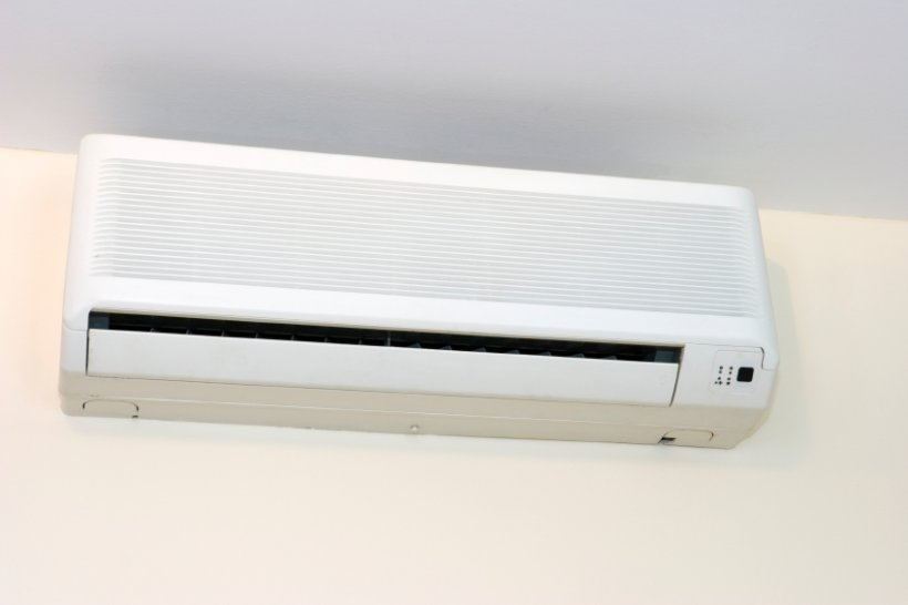

Beelbeebub Posted September 16, 2023 Share Posted September 16, 2023 OK, another random thought. Currently there is general anxiety about the size, visual and acoustic footprint of the external parts of heat pumps. Usually they are a big white box sat outside the building (cough octopus cosy cough) Air to Air systems are a little smaller as they don't need the air to water heatexchanger etc and split A2W are essentially a a2a outside unit with an internal heat exchanger. But the inside units of a2a units (the boxes on the wall) are small and quiet, because of their location. They tend to use crossflow fans and are very compact. It occurred to me the heat exchange capability of the inside unit must be similar to the outside unit. Usually 2-3kw per head unit. What if (in essence) used the form factor of an inside unit as the external heat exchangers and what is effectively the outdoor unit was inside? As we would be going to water, the inside unit woukd replace the bulky fan and coil with a PHX and circulation pump. So inside we woukd have a boiler sized (and probably sited) unit with a compressor, PHX and pump. Outside you would have a wall mounted head units, say 2 for a 6kw system. Coloured to blend in. So in essence my pitch is: why not use crossflow fans and compact coils for the outside unit? Link to comment Share on other sites More sharing options...
Beelbeebub Posted September 16, 2023 Author Share Posted September 16, 2023 If you really wanted to be radical, whay if each "head unit" was entirely self contained with a small compressor and the inside unjt purely held the controller, a PHX and pump, maybe a booster heater. Then each external unit woukd be capable of producing (say) 3kw, and you just double, triple, quadruple up for 3,6,9 and 12 kW demands This woukd proably add some cost through duplication, but that might be offset by economies of scale as the same outside unit is being produced in larger numbers. The really bug advantage thought would be that your modulation woukd be genuinely huge. In shoulder months you could run a single unit at low power (say sub 1kw for a 3kw peak unit) and then just spin up extra units as the demand increased up to however many you needed, say 12kw. Link to comment Share on other sites More sharing options...
SteamyTea Posted September 16, 2023 Share Posted September 16, 2023 Have you not just described a split A2WHP system, but with a smaller external fan unit. I think the problem is physics, you would need a large airflow externally, which may generate more noise, and not be very efficient. Link to comment Share on other sites More sharing options...
JohnMo Posted September 16, 2023 Share Posted September 16, 2023 Cannot see why that would not work, also if you use the refrigerant to heat the cylinder, (divert it before the plate exchanger) that is around 80 degs. Cascade control schemes are nothing new, my ASHP is already pre-programmed for it. Link to comment Share on other sites More sharing options...
DanDee Posted September 16, 2023 Share Posted September 16, 2023 The internal 3kW a/a runs the refrigerant at 35-40C vs 20C indoor air, so dT of 15-20C, the outdoor 3kW unit has a dT of 3-7C, thus the air flow difference between the two would make the indoor unable to harvest the heat. So we a need a split with everything inside with just the evaporator coil+fan outside, but the same coil and fan size like now just in a more compact case(without the compressor and HEX+bits). The GSHP already sits everything inside. https://www.ochsner.com/en/ochsner-products/air-source-heat-pump/ Link to comment Share on other sites More sharing options...

Beelbeebub Posted September 16, 2023 Author Share Posted September 16, 2023 2 hours ago, SteamyTea said: Have you not just described a split A2WHP system, but with a smaller external fan unit. Yes I have. 😁 2 hours ago, SteamyTea said: I think the problem is physics, you would need a large airflow externally, which may generate more noise, and not be very efficient. The main point is the airflow/coil size for an indoor unit must be similar to the outdoor unit (given they are both transferring similar amounts of heat with similar DTs) and the indoor units are much quieter and more compact than the outdoor units. Inside units use crossflow fans which are very quiet and would lend themselves to a flatter device. If a HP could be fairly slender (say 200mm thick) and could be set against a wall because it is sucking top to bottom or side to side or bottom to top rather then front to back then the size in other directions isn't so much of an issue. You could probably stick a 2000x1000x250 box on a wall fairly easily but a 1400x800x400 unit that needs to be 300 off the wall is a bit trickier. Link to comment Share on other sites More sharing options...
Beelbeebub Posted September 16, 2023 Author Share Posted September 16, 2023 1 hour ago, DanDee said: The internal 3kW a/a runs the refrigerant at 35-40C vs 20C indoor air, so dT of 15-20C, the outdoor 3kW unit has a dT of 3-7C, thus the air flow difference between the two would make the indoor unable to harvest the heat. So we a need a split with everything inside with just the evaporator coil+fan outside, but the same coil and fan size like now just in a more compact case(without the compressor and HEX+bits). The GSHP already sits everything inside. https://www.ochsner.com/en/ochsner-products/air-source-heat-pump/ Pretty much, but with an outdoor unit that was more like a wall mounted air con internal unit than some sorry of picnic table/korean BBQ 😁 Link to comment Share on other sites More sharing options...
