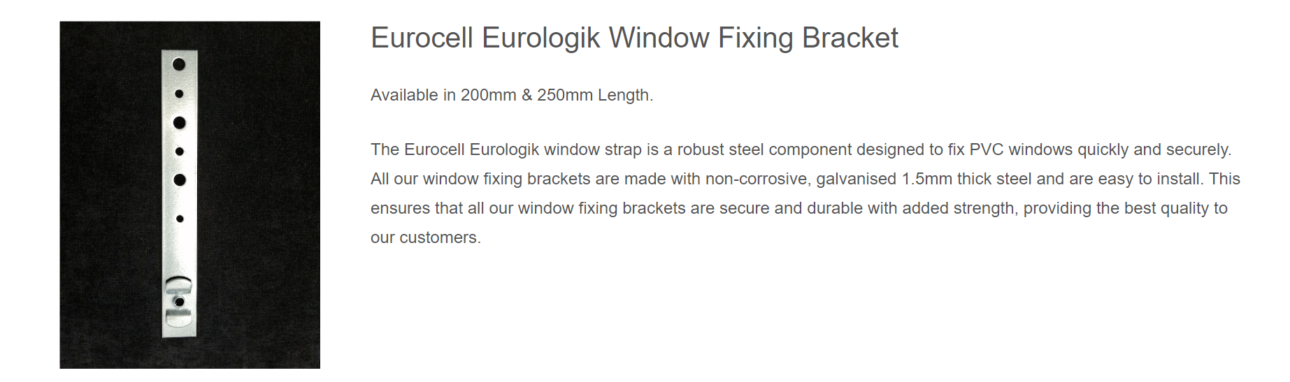

Dave Jones Posted September 12, 2023 Share Posted September 12, 2023 On 11/09/2023 at 21:40, Big Jimbo said: No problem. Don't take any flannel from them. The fitting is not right. Does not meet the part L regs, and is a huge thermal bridge. Warn them that they don't want to have to have a face to face chat with your mate Big Jimbo. If there are any bodies they are members of "Chas, Trusted trader " etc i would report them. How many other windows and doors have this company fitted incorrectly in the local area. Expand exactly this. The way they have been fitted wastes all that time an effort of having a 150 cavity. It's if you have no cavity at all. It's not a massive job to fit them correctly on straps and has already been said get 70% of the frame sitting in the cavity leaving just enough extending into the blockwork so that the frame can be weather sealed to the blockwork. Do tape the insides to make sure they are airtight. I'm going to take a wild guess here but the architect drawing didn't specify this detail right ? Link to comment Share on other sites More sharing options...
HughF Posted September 12, 2023 Share Posted September 12, 2023 (edited) Good luck finding straps that work with a 150 cavity and fit your profile, I couldn't... Ended up sitting them 20mm over the cavity as compromise. Better than the 30mm back from the face that the regs used to allow, but not technically compliant. BCO inspected and didn't even comment... The other issue, as highlighted by my builder is the poor quality of the cavity closers you get these days. Wobbly plastic things with a small flange... Good luck putting packers onto those... Edited September 12, 2023 by HughF Link to comment Share on other sites More sharing options...
Dave Jones Posted September 12, 2023 Share Posted September 12, 2023 window manufacturer supplies the straps. Use built in (tied into the brick courses) closers that are ready made and braced square. have zero issues and no 'wobbles'. Link to comment Share on other sites More sharing options...
HughF Posted September 13, 2023 Share Posted September 13, 2023 On 12/09/2023 at 13:01, Dave Jones said: window manufacturer supplies the straps. Use built in (tied into the brick courses) closers that are ready made and braced square. have zero issues and no 'wobbles'. Expand Longest strap I can get for the profile from my supplier is 150mm, doesn’t span the cavity. agree on the closers though, got to be built in as you go. Link to comment Share on other sites More sharing options...
Dave Jones Posted September 13, 2023 Share Posted September 13, 2023 1 Link to comment Share on other sites More sharing options...
HughF Posted September 13, 2023 Share Posted September 13, 2023 On 13/09/2023 at 06:50, Dave Jones said: Expand Nice, the longest I can find for Deceuninck 2800 is 150mm Link to comment Share on other sites More sharing options...
