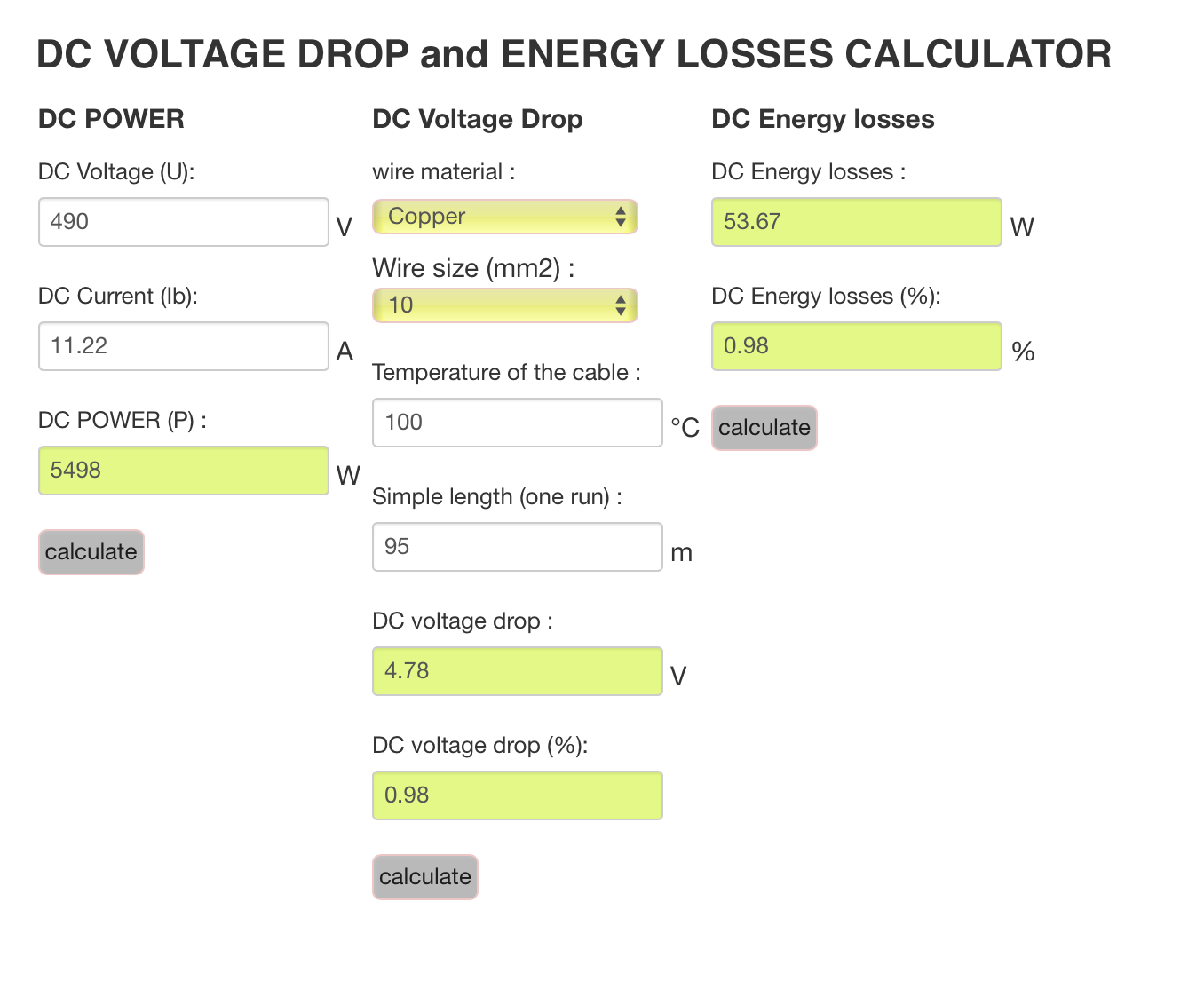

jayc89 Posted September 6, 2023 Author Share Posted September 6, 2023 Trying to come up with a sane design for these runs. All will be in serial strings, as parallel will result in too high amperage (I think). "shed" - 10x 550w panels @ 49v each. garage - 5x 550w panels @ 49v each. house roof - 6x 550w panels @ 49v each. AFAIK, when running serial strings, voltage is accumulative (volts x panels) but the wattage remains constant (550w in my case). That being the case, to stay within a voltage drop of 1%, the cable runs required seem to be; "shed" - 10x 49v = 490v @ 550w = 1.12a over 95m distance, requires 0.8917mm2 cable (1.5mm2) garage - 5x 49v = 245v @ 550w = 2.24a over a 30m distance, requires 1.1264mm2 cable (1.5mm2) house = 6x 49v = 294v @ 550w = 1.87a over 25m distance, requires 0.653mm2 cable (1.5mm2) tl;dr all runs could be done in 1.5mm2 cable which seems far too low, especially as everything I've seen online suggests between 4 and 6mm2 SWA (but that is generally when talking about AC). Am I mis-calculating something? Link to comment Share on other sites More sharing options...

jayc89 Posted September 6, 2023 Author Share Posted September 6, 2023 Ah ok, I thought only voltage increased in serial strings, whereas current increased in parallel strings... I'm still at a bit of a loss though as I've used a couple of online calcs using 490v, 11amps over 95m and they're suggesting a cable size of 10mm2, which would be doable. How are you getting 50mm2? If, the shed run is going to be problematic, what about an inverter in the garage. So a 65m DC run from the shed, then a 30m run of 25mm SWA (AC) from the inverter in the garage to the meter box, which, again if my calcs are right this time, be good for up to 9kw (shed + garage arrays)? Link to comment Share on other sites More sharing options...
JohnMo Posted September 6, 2023 Share Posted September 6, 2023 I used the online calculator in the previously linked threads. 1 Link to comment Share on other sites More sharing options...
jayc89 Posted September 6, 2023 Author Share Posted September 6, 2023 4 minutes ago, JohnMo said: I used the online calculator in the previously linked threads. That was one of the ones I used, I must be doing something wrong (appreciate the cable temp is, hopefully, wrong, but reducing that only reduced the losses anyway); Link to comment Share on other sites More sharing options...
JohnMo Posted September 6, 2023 Share Posted September 6, 2023 Just went through it again, I was looking at volts drop instead of volts % drop. 10mm2. 1 Link to comment Share on other sites More sharing options...
jayc89 Posted September 6, 2023 Author Share Posted September 6, 2023 So a 10mm2 SWA would be suitable for the longest route ("shed"), which runs past the garage. Can I use a 3-way joint connector to tee into the "shed" feed and save running a 2nd cable back to the meter box from the garage? Link to comment Share on other sites More sharing options...
