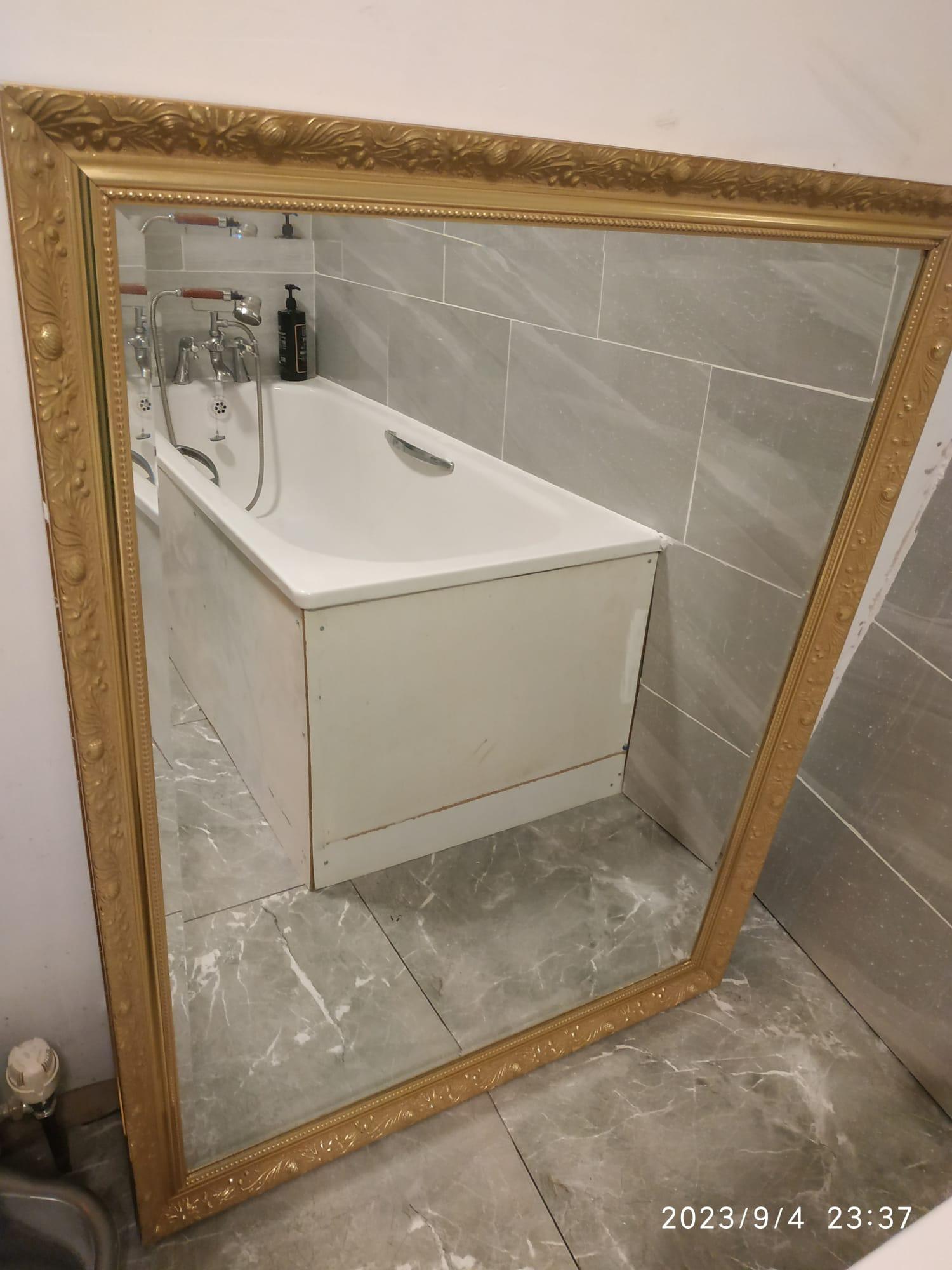

JohnBishop Posted September 4, 2023 Posted September 4, 2023 Hi All, I hope you are well. I have a big framed mirror I want to hang on the wall but this is a plasterboard. The mirror is about 44" x 34". What should I use so it has enough support? Thank you

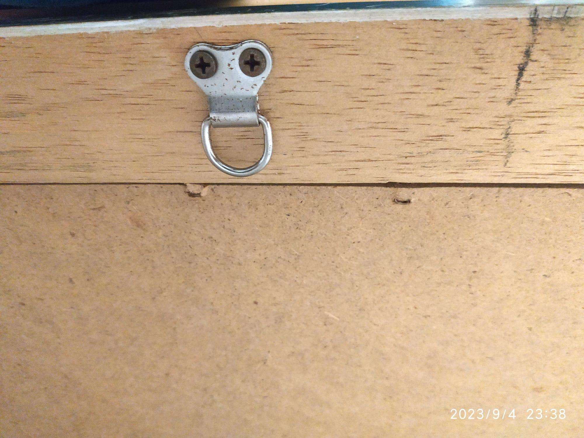

JohnBishop Posted September 4, 2023 Author Posted September 4, 2023 This is the mirror. I don't know the exact weight but I think it's around 10kg? It has these string hangers on both sides, nothing more.
JohnMo Posted September 5, 2023 Posted September 5, 2023 Those fittings are used for string. All you need 2 x 2 pin picture hooks and the string. B&Q or your local picture framer sell both.
JohnBishop Posted September 6, 2023 Author Posted September 6, 2023 (edited) I found this video. These picture hooks make the most sense as it keeps the load away from the screw itself. Edited September 6, 2023 by JohnBishop
