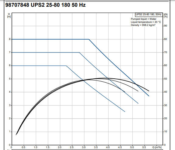

JohnMo Posted September 15, 2023 Share Posted September 15, 2023 (edited) @SimonDThere are no actuators. At the start of the thread there is a photo of the manifold. Still don't understand how a pump that size (25-80) is expected to cope with only two circuits of UFH pipe, with a demand flow rate of 5l/min, without causing a bucket load of flow related issues. Edited September 15, 2023 by JohnMo Link to comment Share on other sites More sharing options...
SimonD Posted September 15, 2023 Share Posted September 15, 2023 12 minutes ago, JohnMo said: @SimonDThere are no actuators. At the start of the thread there is a photo of the manifold. Still don't understand how a pump that size (25-80) is expected to cope with only two circuits of UFH pipe, with a demand flow rate of 5l/min, without causing a bucket load of flow related issues. Well, with the actuators at least that's one potential issue out of the way! Regarding the pump, as I've learned, it's unfortunately a pretty standard 'answer' lots of heating engineers use to 'resolve' or 'overcome' flow issues in heating systems! "Oh, your radiators aren't getting hot, you need a bigger pump"....Makes you wonder, doesn't it 😊 Link to comment Share on other sites More sharing options...
JohnMo Posted September 15, 2023 Share Posted September 15, 2023 2 minutes ago, SimonD said: Makes you wonder, doesn't it 😊 Just looked at my boiler pump (32kW) and it max head is half and flow at max head is half the one installed. Link to comment Share on other sites More sharing options...
