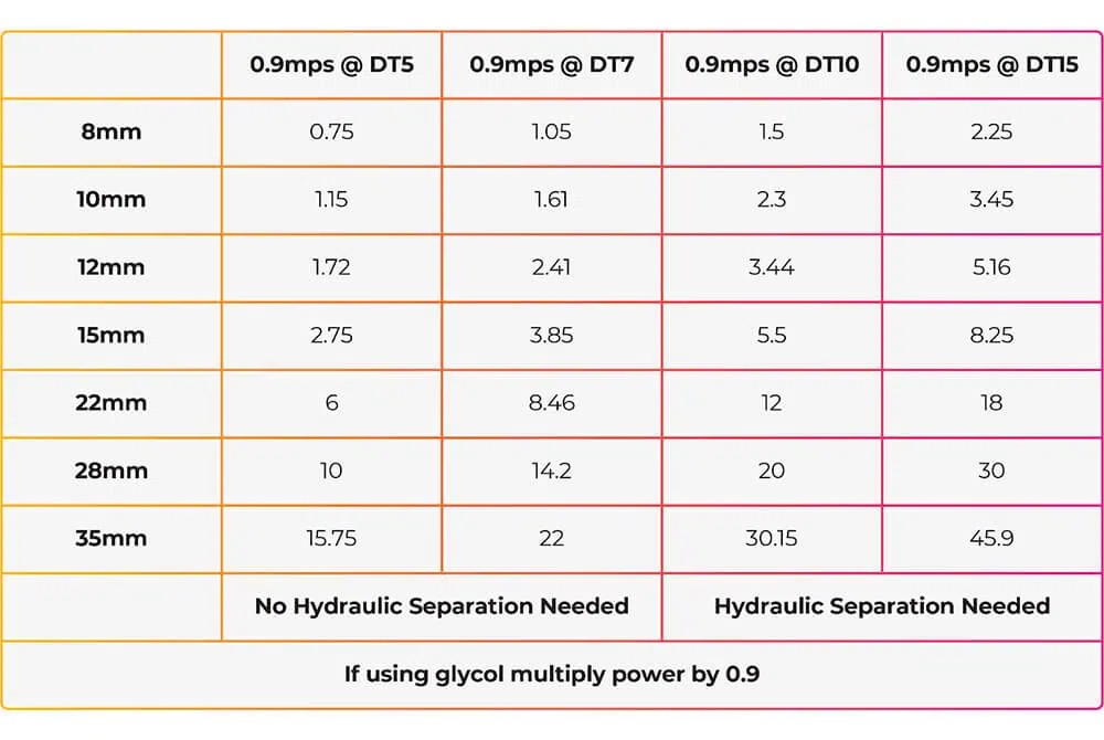

JohnMo Posted August 30, 2023 Posted August 30, 2023 What you need is a strap on ultrasonic flow meter. Or you could just use a look up table, like on heat geek. From the heat loss calculations you will know what each section of the heating system needs to supply in kW. Use the look up table to manipulate the flow rates and dT if required. Maybe small sections of a header will need up sizing.

Beelbeebub Posted August 30, 2023 Author Posted August 30, 2023 Just now, JohnMo said: What you need is a strap on ultrasonic flow meter. Or you could just use a look up table, like on heat geek. From the heat loss calculations you will know what each section of the heating system needs to supply in kW. Use the look up table to manipulate the flow rates and dT if required. Maybe small sections of a header will need up sizing. Yes that's exactly what I'm talking about. You could use the table but that only gives you a rough estimate. You might have 28mm pipes heading out of the boiler, but they drop down to 15mm in some boxing before meandering about all over the place. Or, as has happened to me on a boiler system, you think the issue is the pipes are 15mm but it turns out it's actaukky 22 all the way to just before it pops up above the floor and you're fine. Measuring the actual flow has to be the gold standard. 1

JohnMo Posted August 30, 2023 Posted August 30, 2023 Your ok with 15mm in a lot of cases, I have a 2 port UFH manifold fed from the main header in 15mm Hep2O, approximately 6m each way. Zero issues with flow rate. 1
Beelbeebub Posted August 30, 2023 Author Posted August 30, 2023 6 minutes ago, JohnMo said: Your ok with 15mm in a lot of cases, I have a 2 port UFH manifold fed from the main header in 15mm Hep2O, approximately 6m each way. Zero issues with flow rate. I'm sure it is in a lot of cases. But there is the persistent assumption that you need at least 28mm thought your 1 bed flat to go with a couple of 2000x800 triple fin rads per room (not to mention a 150l buffer to go with your 18kw heatpump). Being able to stick a gizmo on the flow pipe of your booker and go "yup plenty of flow, no need to rip UK the floor or repwmce any pipes" would be a big time saver and eliminate a potential cause of poor performance.
JohnMo Posted August 30, 2023 Posted August 30, 2023 As posted by yourself 15mm fine for a 2 to 3 of kW. I am also stuffing 6kW (0.96m3/h) through about 10-12m of 22mm Hep2O, but that needs the assistance of a second pump in the return line. So various ways around an issue. 8 minutes ago, Beelbeebub said: But there is the persistent assumption that you need at least 28mm thought your 1 bed flat to go with a couple of 2000x800 triple fin rads per room We all know that mentality will continue, given a magic bullet or not. 10 minutes ago, Beelbeebub said: not to mention a 150l buffer to go with your 18kw heatpump That may be required the way most people seem to want a zillion zones all over the house. Sticking a gismo on a random pipe is sh**e in sh**e out. It doesn't tell you much about how the water is being distributed, is it just opening a bypass valve, funnelling through a big section of pipe and then short cutting past most the system.
