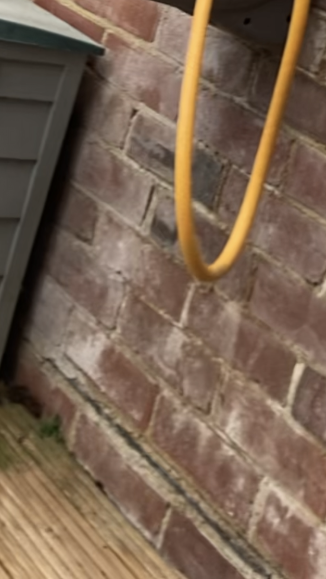

Guest 36 Posted August 30, 2023 Share Posted August 30, 2023 Hi, does anyone know if this could be an Historic damp proof course from when the house was built in the 1950,s or so. Or is there a chance it could be more recent, say last 15-20 years? Thinking of buying a house and the home owner says no damp since been living there for last 10 years. thanks Link to comment Share on other sites More sharing options...
Big Jimbo Posted August 30, 2023 Share Posted August 30, 2023 One brick up looks like a damp proof course. Could be slate. That decking is One brick to high however. Link to comment Share on other sites More sharing options...
Guest 36 Posted August 30, 2023 Author Share Posted August 30, 2023 Thanks for the advice Big Jimbo. Do you think it could be Historical when the house was built in the 50’s as slate was used back then? Link to comment Share on other sites More sharing options...
Big Jimbo Posted August 30, 2023 Share Posted August 30, 2023 Whatever it is made from, it defo looks like a DPC. Just try and make sure that the ground around the property is kept 2 bricks below that DPC. That was fitted when built. 1 Link to comment Share on other sites More sharing options...
ProDave Posted August 30, 2023 Share Posted August 30, 2023 6 hours ago, Johnny T said: Thanks for the advice Big Jimbo. Do you think it could be Historical when the house was built in the 50’s as slate was used back then? My previous 1930's house had a slate DPC. Link to comment Share on other sites More sharing options...
Brickie Posted August 30, 2023 Share Posted August 30, 2023 Doubt it’s slate from the 50’s. Link to comment Share on other sites More sharing options...
