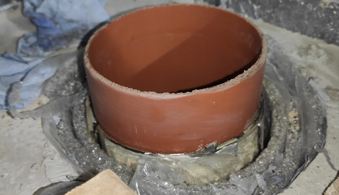

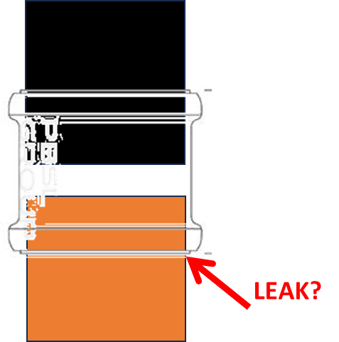

MortarThePoint Posted August 29, 2023 Posted August 29, 2023 I have about 30mm of 110mm soil pipe to connect my stack to. It passes through the screed and a membrane and that's what I am left to work with. There's a photo below. Once I have cleaned the gaffer tape residue off, I figure I have 3 options: Pushfit double socket: Floplast SP105 the stub of 110mm pipe wouldn't push all the way home but would be at least 15mm past the rubber seal. I could creep under the weight of the stack above and so move down over time. I wouldn't want the rubber seal to contact the membrane that us taped to the side of the stub. Solvent weld / pushfit coupler: Floplast SP124 The sub wouldn't push all the way to the end stop, but would have ~30mm worth of solvent joint which is similar to what they have on their short 3-boss. It's pretty committed though as if I make a hash of the solvent weld I am stuffed. Universal Pipe Connector: Floplast SP140 this would push into the stub and so have no limitations as they are external. It restricts the interior diameter though. Is there no issue with using a ring seal onto a lower pipe? Are they more likely to leak that way? The black is from when I pushed a ring seal over before during testing.

Crunchynut Posted August 29, 2023 Posted August 29, 2023 Looking at how scuffed the pipe appears to be I would be nervous that a push fit might not form an effective seal.
Dave Jones Posted August 29, 2023 Posted August 29, 2023 pull it out the restbend and use a longer length ?
crispy_wafer Posted August 29, 2023 Posted August 29, 2023 agree with @Dave Jones pull it out if you can. I'd replace with a piece with a socket on the end. However, since it's screeded and taped up it probably won't want to come out without a fight, you could core round the pipe and remove some screed, or chip away (probably safer) to expose a bit more pipe, use a coupler and if you are concerned about the seal, plenty of CT1 round the inside?
MortarThePoint Posted August 29, 2023 Author Posted August 29, 2023 31 minutes ago, Dave Jones said: pull it out the restbend and use a longer length ? 3 minutes ago, crispy_wafer said: agree with @Dave Jones pull it out if you can. I'd replace with a piece with a socket on the end. However, since it's screeded and taped up it probably won't want to come out without a fight, you could core round the pipe and remove some screed, or chip away (probably safer) to expose a bit more pipe, use a coupler and if you are concerned about the seal, plenty of CT1 round the inside? I won't be able to remove it due to the membrane, so it's a matter of working with what I've got. I share the concern about a ring seal. Solvent weld feels like the most robust solution. There's an amount of clear pipe available that is comparable to the insertion depth of a short boss. It won't hit and end stop which is a bore, but the solvent bond should be strong enough to support the stack shouldn't it?

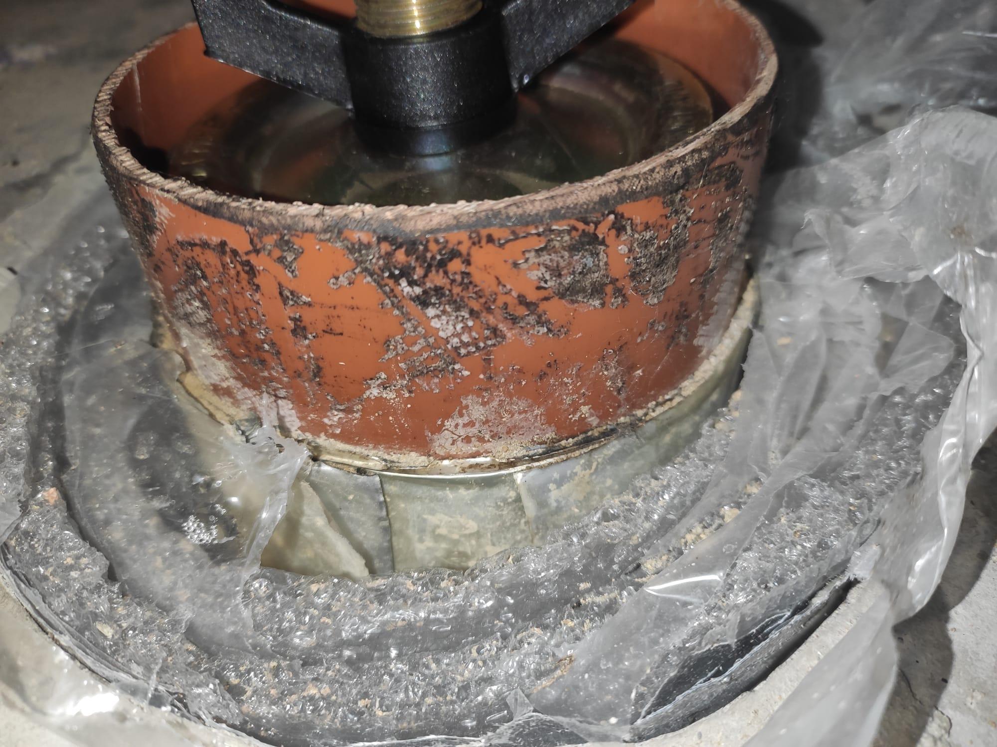

MortarThePoint Posted August 29, 2023 Author Posted August 29, 2023 43 minutes ago, Crunchynut said: Looking at how scuffed the pipe appears to be I would be nervous that a push fit might not form an effective seal. I am hoping I can clean it up well enough for the solvent bond.

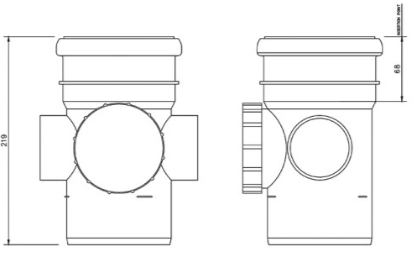

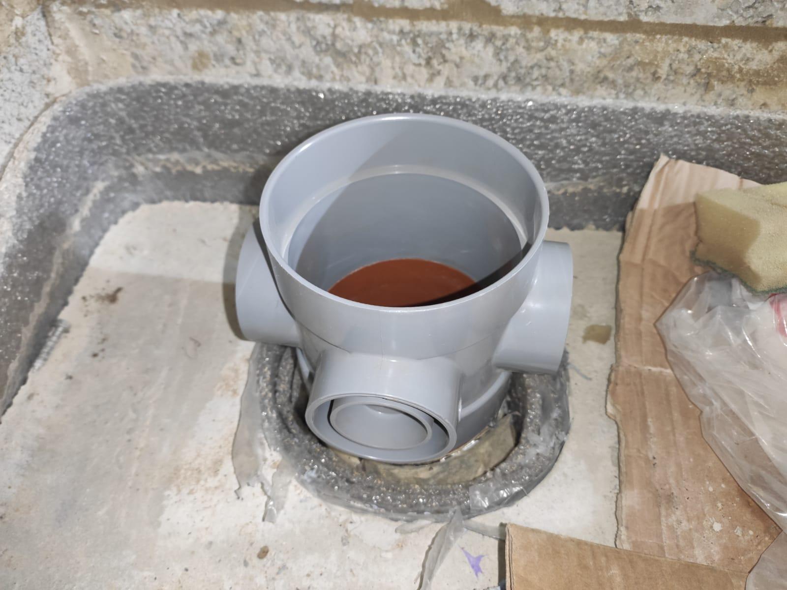

MortarThePoint Posted August 30, 2023 Author Posted August 30, 2023 50 minutes ago, Crunchynut said: Solvent weld should work but I’d be worried about the state of the pipe. Alternatively maybe you could use one of those thick rubber couplers that have a jubilee clip either end. A bit unconventional but it would work. It's actually cleaned up pretty well. I think I am going to use an OSMASoil short boss (3 port) as it has the short insertion length and all the ports are sealed so it ends up being a short insertion solvent welded coupler. 1
MortarThePoint Posted August 30, 2023 Author Posted August 30, 2023 Typical that I put on some duct tape to protect the end of the pipe and stop stuff falling in and it's then the duct tape residue that's hard to deal with.

MortarThePoint Posted August 30, 2023 Author Posted August 30, 2023 I'll air test the joint later, but certainly stiffened up when I was rotating to spread the solvent. I like this approach as it gives a last chance pipe attachment centred 80mm above the screed. Never know, that might come in handy. I didn't level it off, just pushed it all the way home so the next section(s) will correct the error in plumbness, which is about 3 in 100. I went out to do the air test and it was still smelling so I am going to wait a few hours. I always end up testing in the dark 🙂 1

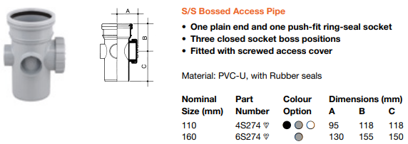

Mr Punter Posted August 30, 2023 Posted August 30, 2023 Should you have an access fitting at the base of the stack for rodding?
MortarThePoint Posted August 30, 2023 Author Posted August 30, 2023 38 minutes ago, Mr Punter said: Should you have an access fitting at the base of the stack for rodding? Is that a requirement as it will end up behind kitchen cabinets. I can always install one into this if need be.
MortarThePoint Posted August 30, 2023 Author Posted August 30, 2023 @Mr Punter Are you think of one of these. I could use one of these immediately above the 3-port boss if need be. OsmaSoil S/S Bossed Access Pipe: Floplast SP274:
MortarThePoint Posted August 31, 2023 Author Posted August 31, 2023 14 hours ago, Mr Punter said: Should you have an access fitting at the base of the stack for rodding? NHBC says: "Rodding access in locations such as kitchen cupboards is unlikely to be acceptable as it may be below the spillage level of appliances and also would obstruct access for rodding apparatus/equipment." this stack is going to go straight up to a double branch, the top port of which may well be unused and so could be access. That would be below the basin spillover levels though so still not ideal.
Dave Jones Posted August 31, 2023 Posted August 31, 2023 14 hours ago, MortarThePoint said: Is that a requirement as it will end up behind kitchen cabinets. I can always install one into this if need be. no, unless its 3 stories or if the bend can be reached from any other part of the run, i.e. a chamber. 1

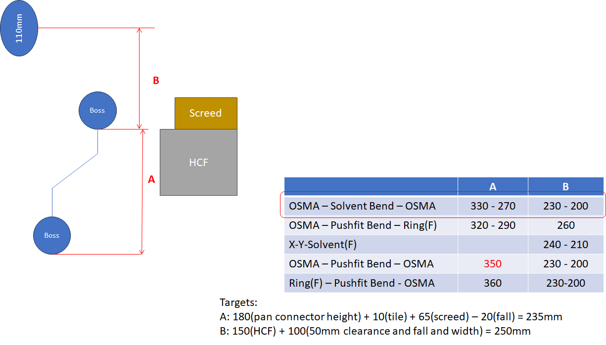

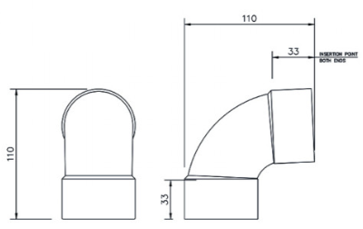

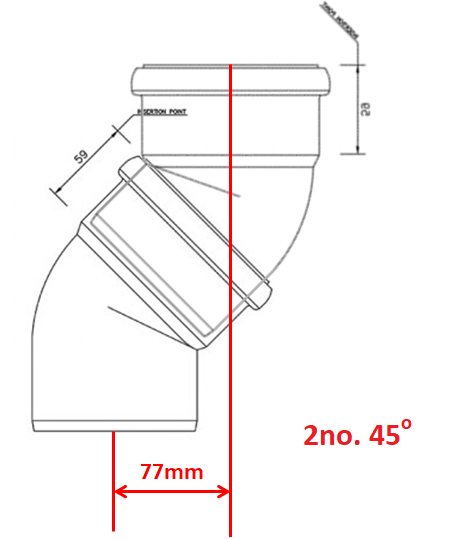

MortarThePoint Posted September 6, 2023 Author Posted September 6, 2023 This is ending up as a pretty busy stack: OSMA 3-boss as shown in photo at floor level OSMA 3-boss at ~500mm as an emergency connection point for the utility sink if there is a problem with its independent underfloor drainage OSMA 3-boss at near ceiling level (GF) for shower(50mm) Floplast 45 solvent bend for offset Floplast 45 solvent bend for offset OSMA 3-boss at screed level (FF) for bath&basin(40mm), shower&basin(40mm) Floplast Double Branch for connection to two toilets and one toilet_macerator_pipe(32mm) AAV in top port of double branch All the 110mm up to the Double Branch is ending up as solvent weld since the OSMA 3-boss is solvent weld and I need the offset done in solvent weld to accommodate the necessary verticals. The horizontal offset is only about 80mm, but moves the stack further from the corner allowing an OSMA Tight Bend (4S160) to fit in one side of the Double Branch. Rodding should be possible by removing the AAV and will hopefully pass easily through the offset. I'm a bit nervous having solvent weld all the way up to and including the bottom joint of the the Double Branch. I could move the offset below the ceiling boss and do it in pushfit, but that would increase the size of the box-in in GF (300mm x 220mm -> 380mm x 220mm). Alternatively, I could add an otherwise unnecessary pushfit joint just below the ceiling OSMA 3-boss. What would you do. Not worry about it, add an extra pushfit joint below the ceiling OSMA 3-boss of add a pushfit joint between the offset and the floor level 3-boss? The code in the table is (lower 3-boss) - (bend) - (upper 3-boss) and Ring(F) is a Floplast ring seal 3-boss and Solvent(F) is a Floplast solvent weld one.

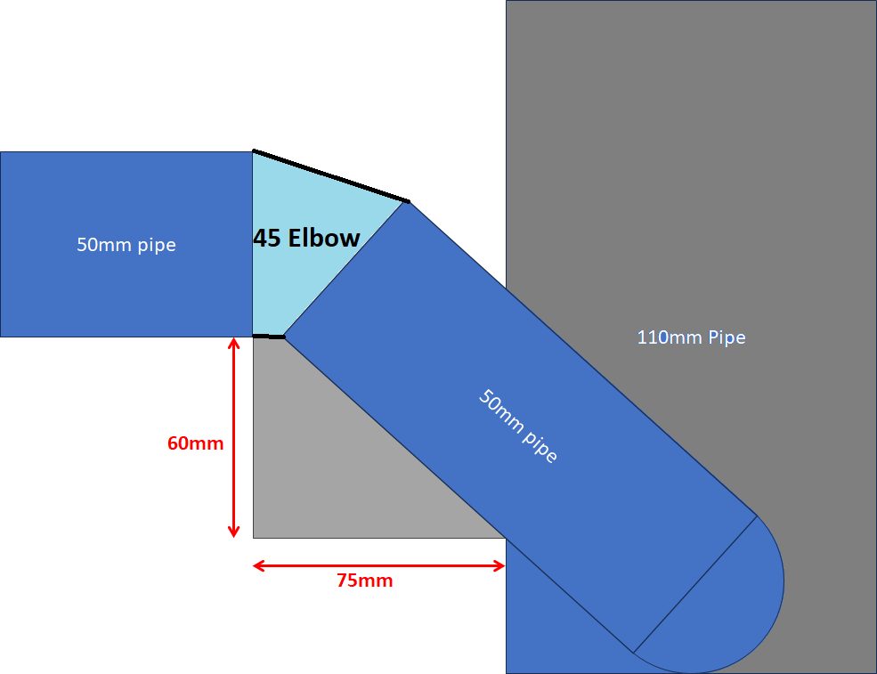

MortarThePoint Posted September 6, 2023 Author Posted September 6, 2023 (edited) Another wildcard option is to use a ring-seal 3-boss below the offset, but that lowers the shower's connection point by about 100mm. That could be OK by using two 90 bends. That might be a bit brutal for the shower flow. An alternative would be a 90 elbow out of the boss to a 45 elbow, but that increases the box-in locally Maybe 3no. 45 elbows? Edited September 6, 2023 by MortarThePoint
MortarThePoint Posted September 7, 2023 Author Posted September 7, 2023 (edited) Hmm, screed is actually 52mm and pan connector is 180mm. Also A and B are the wrong way round in targets Edited September 7, 2023 by MortarThePoint
