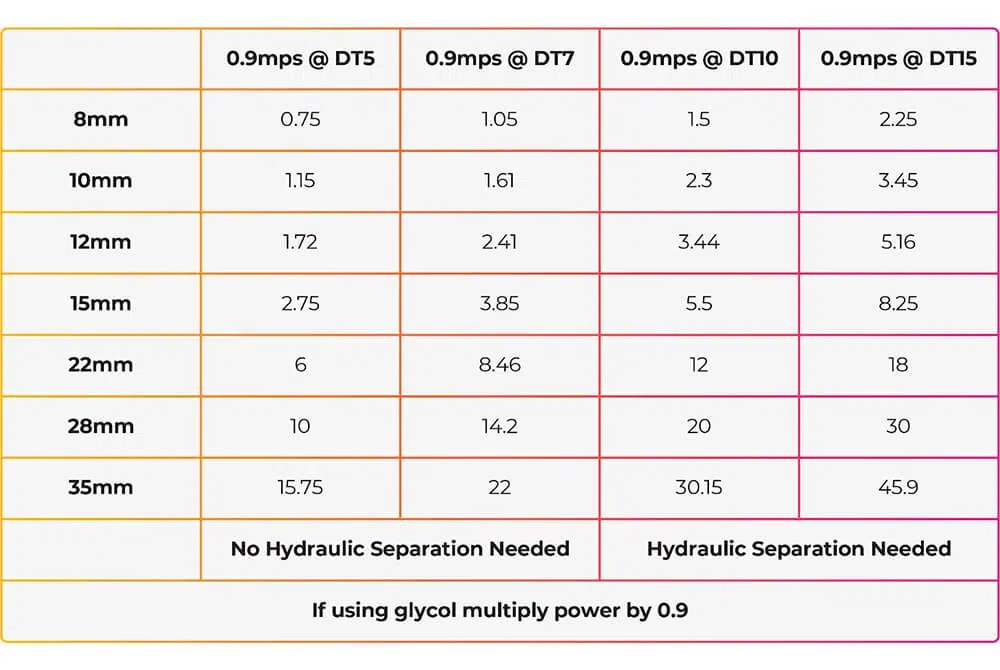

HughF Posted August 29, 2023 Share Posted August 29, 2023 A simple question: 15m run of underground twin pipe, 9kW unit on the end... Should I step up to 40mm or would it be ok to stick with 32mm? I'd prefer to stick with 32 as I have press jaws for that size and can go straight onto 28mm adapters. Link to comment Share on other sites More sharing options...
Beelbeebub Posted August 29, 2023 Share Posted August 29, 2023 (edited) Here's the heatgeek cheat sheet for pipe sizes. 32mm should be good for 15kw, so plenty of margin as long as your pipe run doesn't look like a kids balloon animal.... Edited August 29, 2023 by Beelbeebub Link to comment Share on other sites More sharing options...
HughF Posted August 29, 2023 Author Share Posted August 29, 2023 Spot on, cheers.... Link to comment Share on other sites More sharing options...
Dreadnaught Posted August 30, 2023 Share Posted August 30, 2023 To help any others reading his table above … "Here you have the external pipe diameter on the left, and how many kW/s of power the pipe can carry in the centre" … from the Heat Geek website. 2 Link to comment Share on other sites More sharing options...
Beelbeebub Posted August 30, 2023 Share Posted August 30, 2023 37 minutes ago, Dreadnaught said: To help any others reading his table above … "Here you have the external pipe diameter on the left, and how many kW/s of power the pipe can carry in the centre" … from the Heat Geek website. External copper pipe diameter. Plastic pipe has a smaller bore and more pressure drop for fittings. I think you nearly halve the capacity for plastic pipes. 2 Link to comment Share on other sites More sharing options...

HughF Posted August 30, 2023 Author Share Posted August 30, 2023 5 hours ago, Beelbeebub said: External copper pipe diameter. Plastic pipe has a smaller bore and more pressure drop for fittings. I think you nearly halve the capacity for plastic pipes. 32mm HiLine E-Flex PEX-a (the stuff you can get from Ingoodnic as a kit) has a 26.2mm bore, the same as 28mm copper. Link to comment Share on other sites More sharing options...
HughF Posted August 30, 2023 Author Share Posted August 30, 2023 9 minutes ago, sharpener said: Pressure drop is indeed an important consideration, see this link. This seems to suggest that at 1.8m head (from my HP to my airing cupboard), and given 35m round trip length (for flow and return), I can get close to 2000ltrs/hr through 32mm. Link to comment Share on other sites More sharing options...
