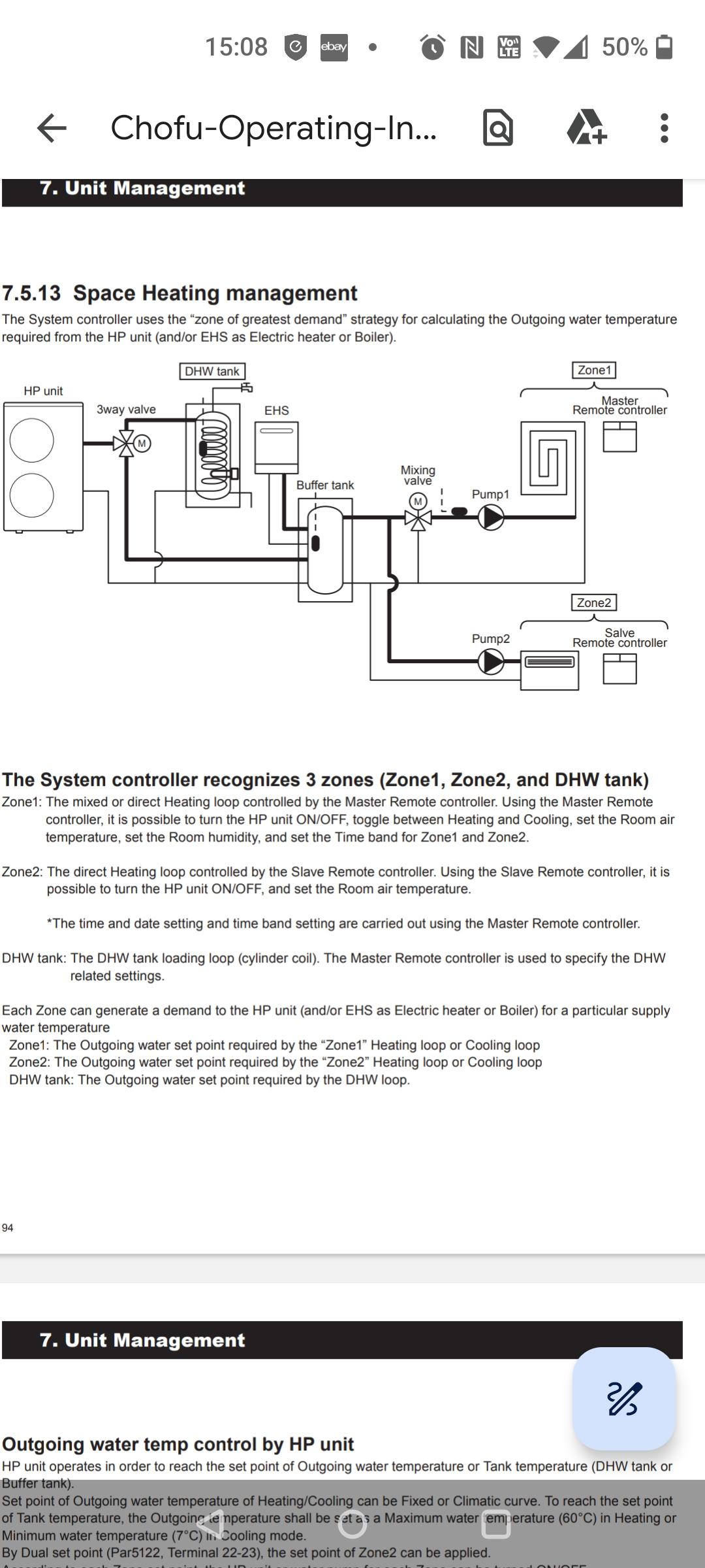

Beelbeebub Posted November 11, 2023 Share Posted November 11, 2023 5 hours ago, ReedRichards said: I think most HP controllers probably cannot do different WC curves for different zones. I have an LG Therma V; it can do different zones but not with different WC curves. Nor can it do a programmed set-back, although you can do this manually very easily. And you only benefit from different WC curves for different zones when one of the zones is off, not demanding heat. You might be right. I think the Grant/Chofu units so have that function, though as an undocumented (from Grant's perspective) feature. They seem very capable units. Grant have made them as simple as possible for existing boiler installers to use which ignores a lot of functionality. I'm really intested in what the next gen r290 units will do. Link to comment Share on other sites More sharing options...
JohnMo Posted November 11, 2023 Share Posted November 11, 2023 1 hour ago, Beelbeebub said: think the Grant/Chofu units so have that function They do, but is only by the zone of highest demand that controls the temp output, the other zone is just a mixer valve. and Link to comment Share on other sites More sharing options...
