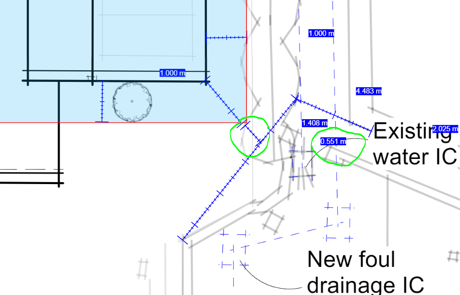

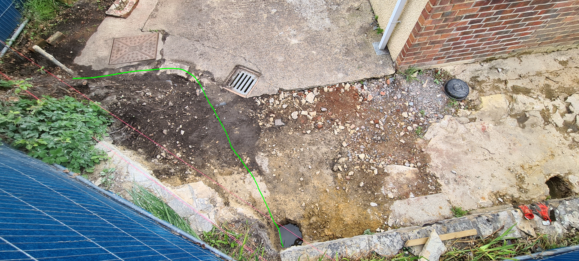

deancatherine09 Posted August 22, 2023 Share Posted August 22, 2023 All So we are 75% through the build of our house (MBC twinwall with passive raft). Doing exterior cladding & first fix at the moment. Relations with neighbours were great until planning went in and then they immediately stopped talking to us and started creating problems. They have now, I feel, come to the realisation that no matter what they try to do to us, we ignore and carry on so they have started trying to separate themselves from us (great as they are nutcases!). As part of that, they started to erect a fence on the boundary line, however in doing their preparations for such fence, have removed a retaining wall on their property and excavated 1-2m of earth (retaining wall on their property, so obviously they want to erect the fence at the lower level & at the boundary). The retaining wall was about 0.8m high, ish and retained the soil on our property. Problem is, where they have excavated is within 0.5m of our compacted hardcore under the EPS base, and 1.8m from said EPS base. It's lower down than the founds. I don't believe they are planning on replacing the retaining wall further back as they have dug fence post holes right next to boundary line. I think their intention was to just put up the fence and tell us the soil retention was our issue? When we realised we immediately sent them a cease & desist letter requesting that they stop the work and follow the Party Wall Act. No response (although they have seemingly stopped work on that area). This happened on Tues 15th and we delivered letter Weds 16th by hand, with another copy send via post. We are also following up with a surveyor. My quandry now is, should we tell insurance company (Protek)? Technically there is no visible slippage of the soil etc, no visible structural damage to the frame / foundations and thus no actual damage to claim YET but I am sure they would be interested? Link to comment Share on other sites More sharing options...
deancatherine09 Posted August 22, 2023 Author Share Posted August 22, 2023 (edited) Diagram below shows house, red line is hardcore. Second pic is aerial view of what they have dug, green line original retaining wall. Edited August 22, 2023 by deancatherine09 Link to comment Share on other sites More sharing options...
joe90 Posted August 22, 2023 Share Posted August 22, 2023 (edited) I think the 45’ rule would apply (45’ down from your foundations which I would consider the hardcore to include) but I think your original SE would need to know this and give his opinion. Neighbours eh! Some people just hate to see others getting on. Edited August 22, 2023 by joe90 Link to comment Share on other sites More sharing options...
ProDave Posted August 22, 2023 Share Posted August 22, 2023 And a sketch of a section through the ground, and foundations to see how the 45 degrees from the foundations compares to the excavated ex retaining wall. 1 Link to comment Share on other sites More sharing options...
