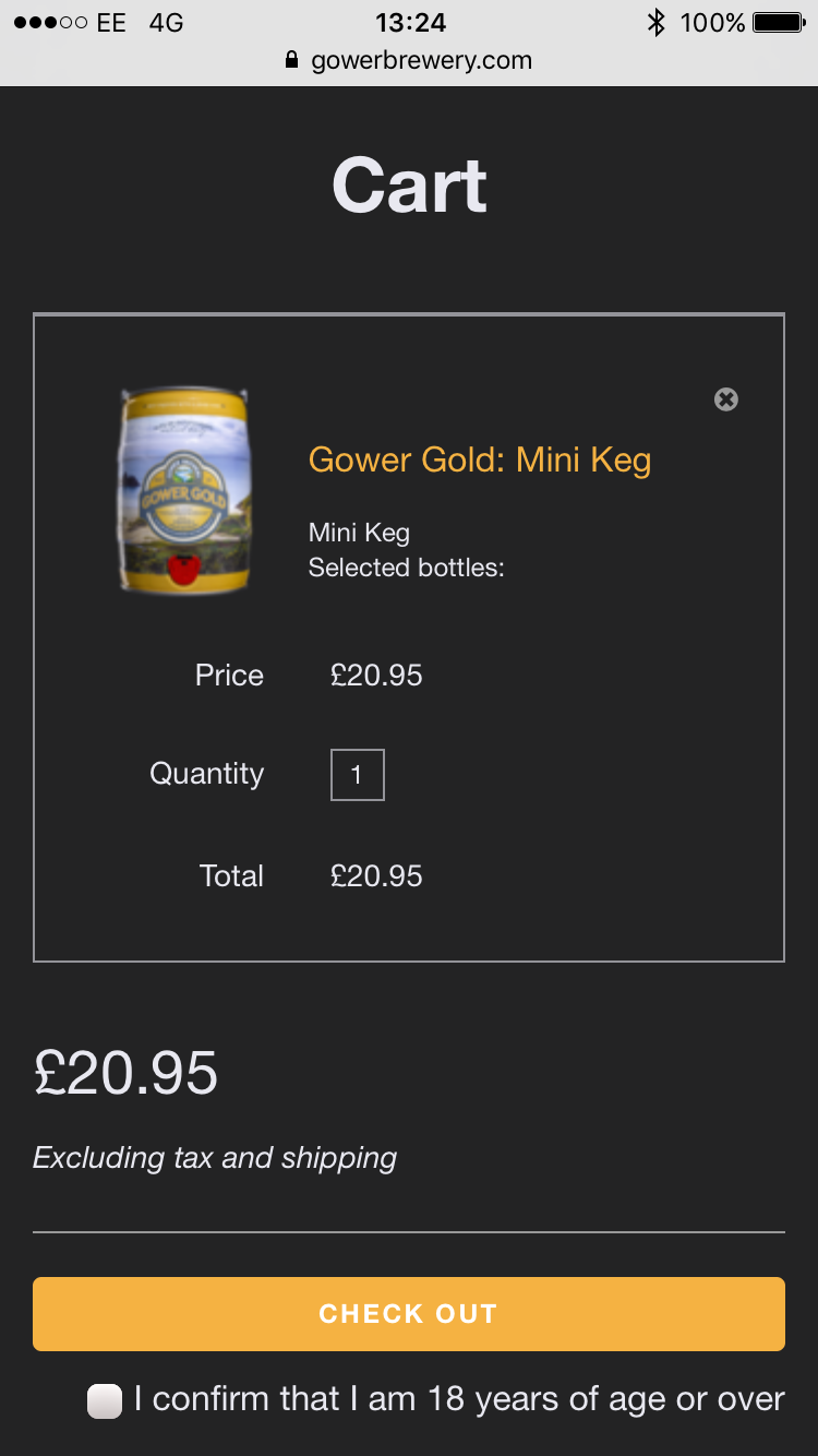

Nickfromwales Posted August 25, 2017 Share Posted August 25, 2017 I'd say the mesh will suffice then. Saves you about £225.......or 10.74 kegs of mothers milk. Tres bien. ? Link to comment Share on other sites More sharing options...
