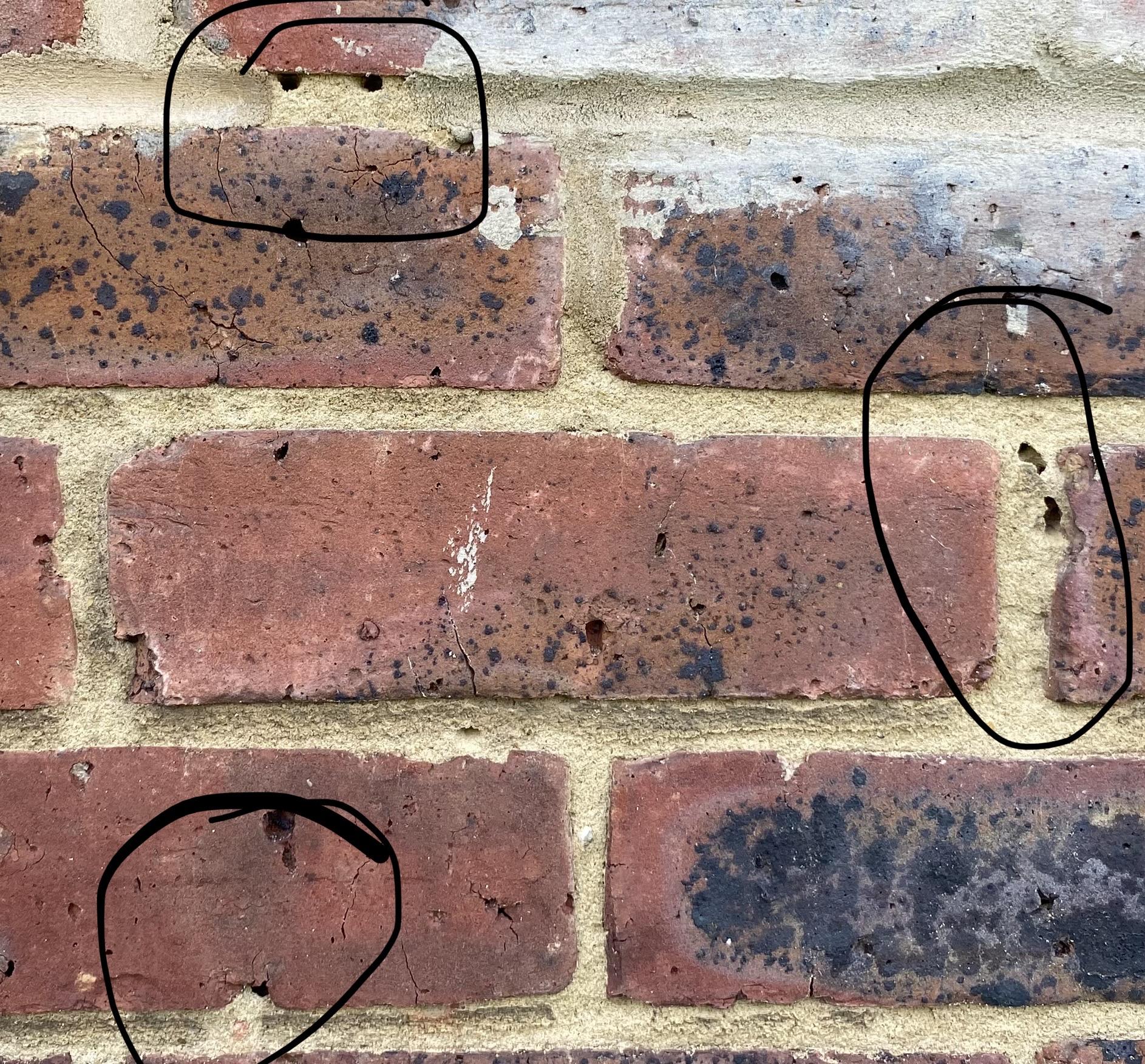

IMG_4730.thumb.jpeg.6648b44315be48dcd6584505f143b5ed.jpegHello, I have mortar bees infestation, I repointed few bricks before, but new holes appeared after few days. Not sure what else I can do. Don’t want to repoint the whole wall.

Leave them be, they are unlikely to do any structural damage. I had them in a previous property for 13 years without any issues. Masonry Bees are solitary and do not gather in large numbers although a few will choose the same patch of wall which suits them best.
I had them erode a whole 1.5sqm patch of a wall. And I don’t want it to happen with the rest of the wall. It if was only one or two holes, I wouldn’t be worried. But after I come back to the wall, there is always two or three more holes per area as I have two different patches.

Killing the Bees that are there wont stop them coming you need to encourage them to go elsewhere. Either make life a bit easier for them IE get a Bee brick ( or even a wall) or much tougher, IE see what the effect of washing the wall with waterproofing solution is or a weak mixture of peppermint oil and water - works for spiders.

I don’t want to use a waterproof solution. As my mortar/bricks will retain moisture and had previous issues with that, which are solved now. I had to do 4:1:1 mix for the repointing of sand, hydrated lime and cement. Wanting the mortar to be breathable. Will go down the route of peppermint oil spray.
