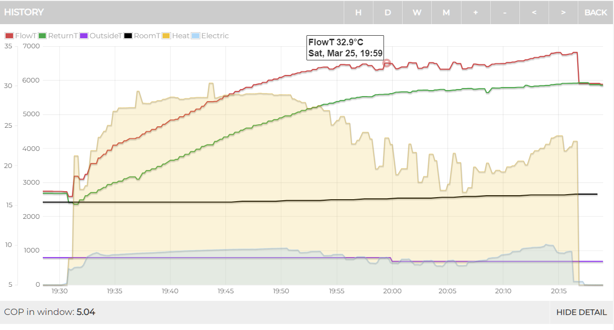

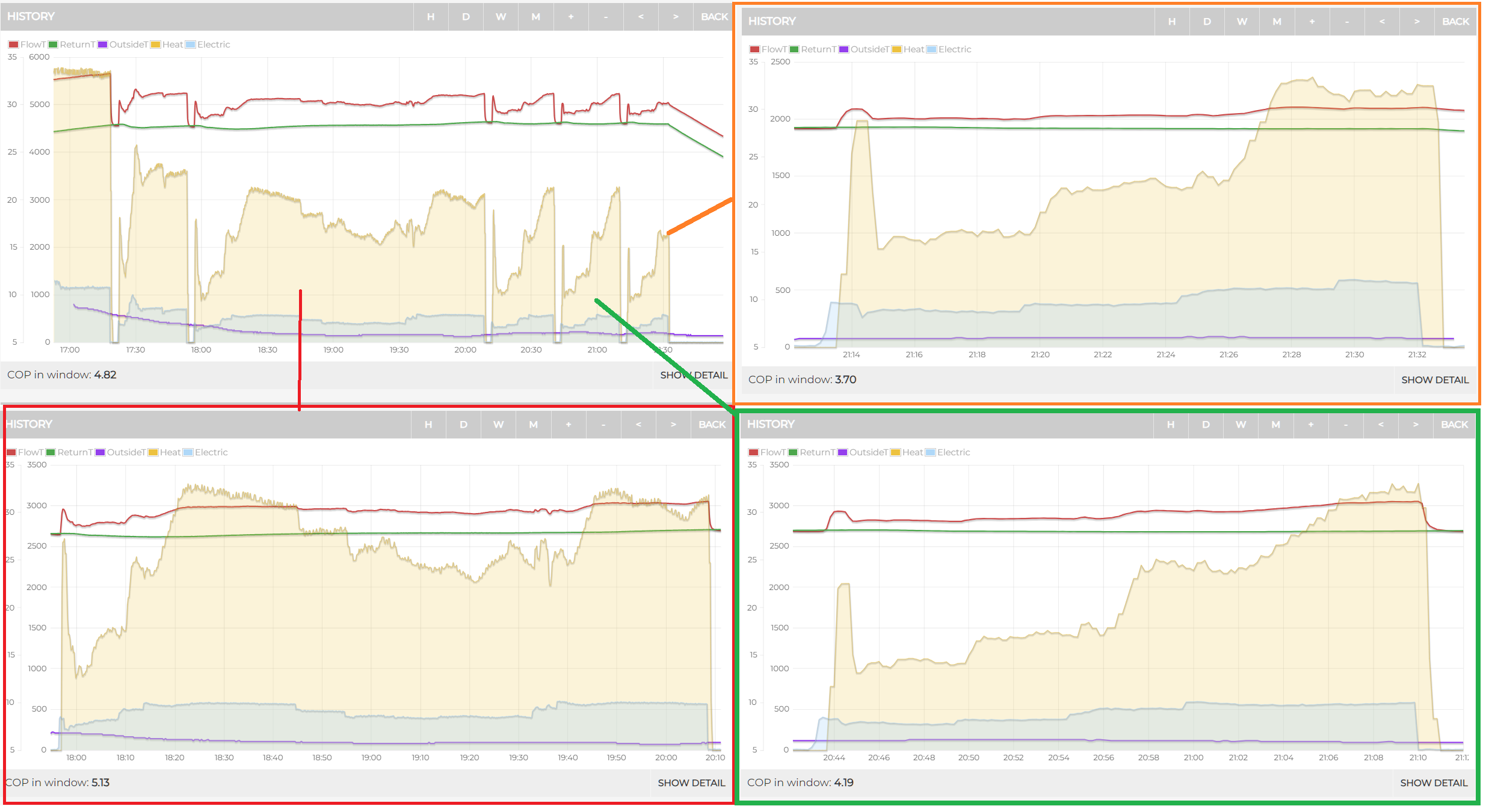

JohnMo Posted August 11, 2023 Posted August 11, 2023 On 11/08/2023 at 11:20, JamesPa said: However there is one concrete thermodynamic argument namely that cycling inevitably means that the flow temp must be higher than if the pump were running continuously in order to deliver the same energy on average. This compromises efficiency. I can't quantity by how much however, because I don't have a model to estimate the rise in flow temp required. It's probably not too difficult to work out if one put one's mind to it, which I may do in an idle moment. Expand A did see a video the other day where the guy was recording flow temps and CoP. In theory a flow temp of 30 would have been good, but the reality was 35 gave him a better CoP over the period, due to how the heat pump cycling occured. Difference in CoP was 4.0 compared to about 4.5. So not always that straight forward. 1

JamesPa Posted August 11, 2023 Posted August 11, 2023 (edited) On 11/08/2023 at 11:42, JohnMo said: A did see a video the other day where the guy was recording flow temps and CoP. In theory a flow temp of 30 would have been good, but the reality was 35 gave him a better CoP over the period, due to how the heat pump cycling occured. Difference in CoP was 4.0 compared to about 4.5. So not always that straight forward. Expand Fair enough. At this level all sorts of 'second order' effects intervene. I doubt anyone has a comprehensive model so I guess the algorithm to optimise is, first minimise the flow temp then, if there is cycling, try tweaking it! Or alternatively do the first step, have a pint, have another pint! There comes a point where things are good enough! Edited August 11, 2023 by JamesPa

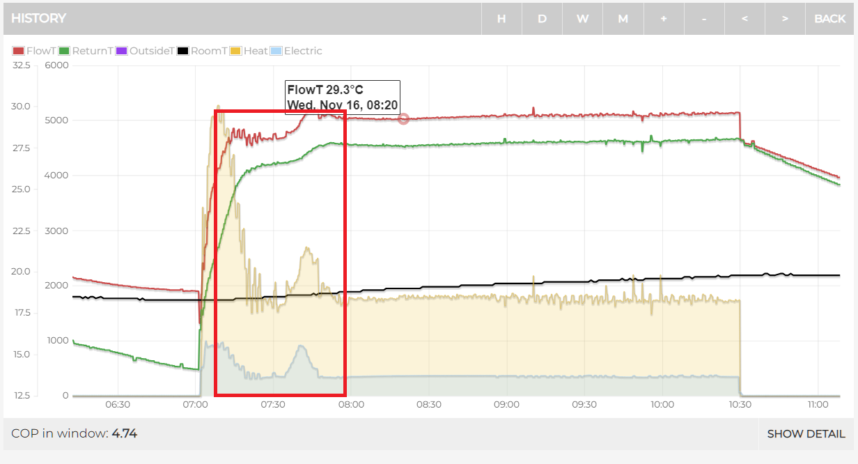

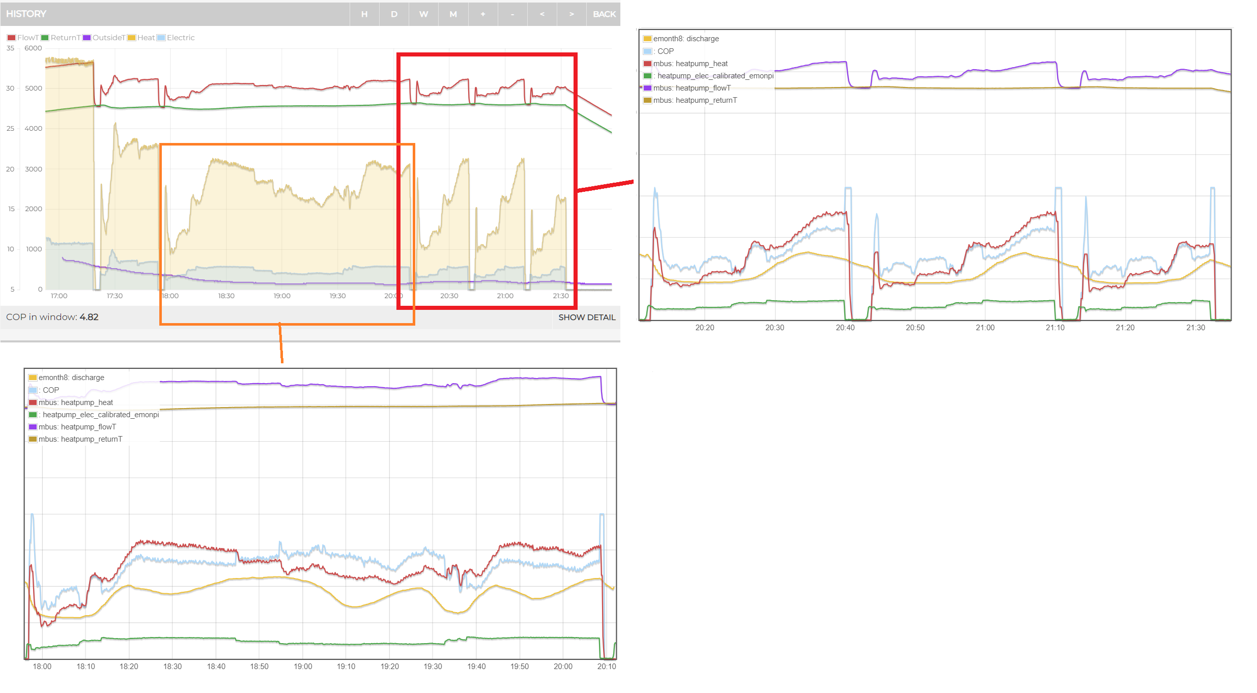

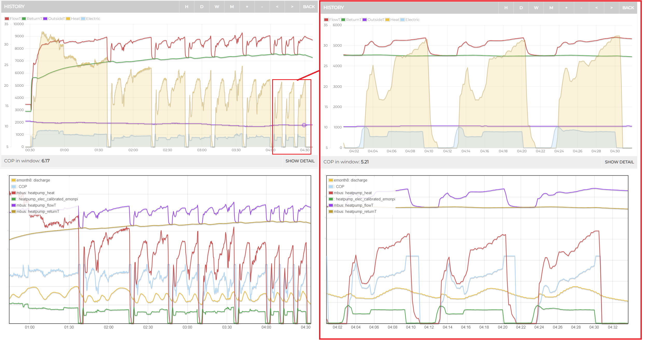

DanDee Posted August 11, 2023 Posted August 11, 2023 On 11/08/2023 at 11:42, JohnMo said: A did see a video the other day where the guy was recording flow temps and CoP. In theory a flow temp of 30 would have been good, but the reality was 35 gave him a better CoP over the period, due to how the heat pump cycling occured. Difference in CoP was 4.0 compared to about 4.5. So not always that straight forward. Expand The difference wasn't due to how cycling occurred, but due to how the heat pump manages its refrigeration cycle/pressure/expansion valve when it hits the steady state(target flow temp), in a particular range of flow temp from 29-30C to 34-35C. yet when the flow temp is rising from 20 to 35 at the start, that issue doesn't occur. Sometimes at the same flow temp during the same heating cycle there's no issue initially and then the issue starts. It happens even at 35-37C(rare occurrence). This shows how the issue temporarily occurs until the system finds its happy medium at the bottom range output of the HP.

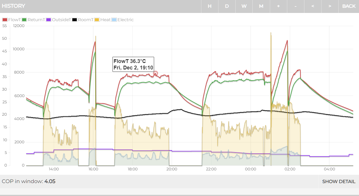

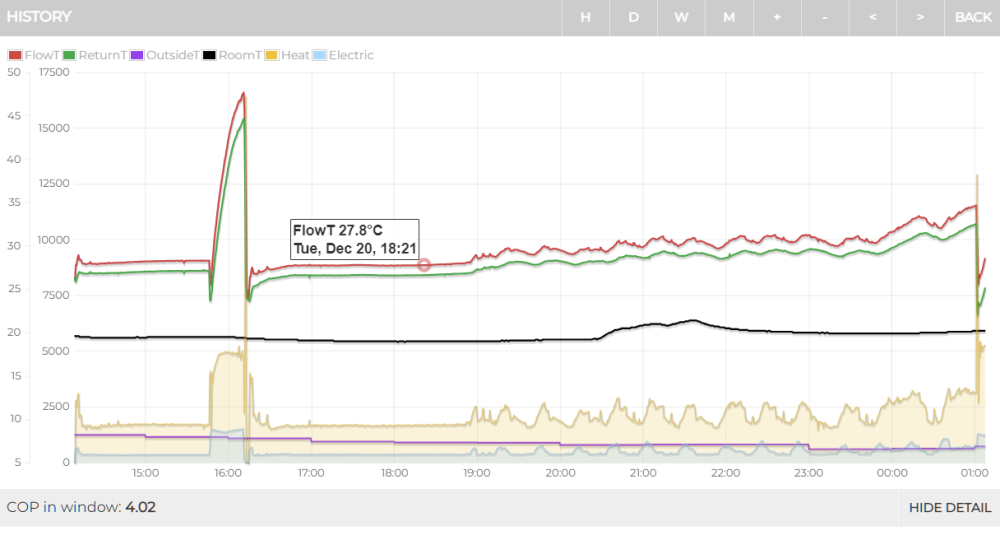

Archer Posted August 11, 2023 Posted August 11, 2023 This video by John Cantor has some interesting analysis of Heat Pump cycling and how it isn't always a bad thing. I'm going to post a related dilemma in another thread so as not to hijack this one - would be grateful for any thoughts from people though

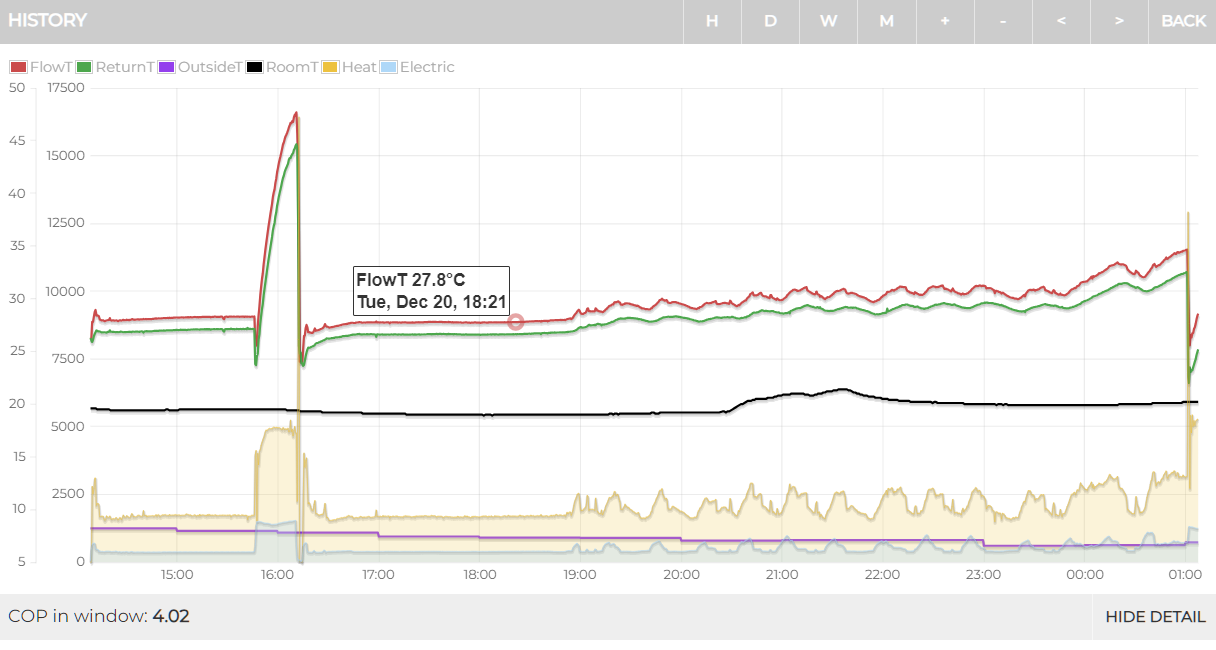

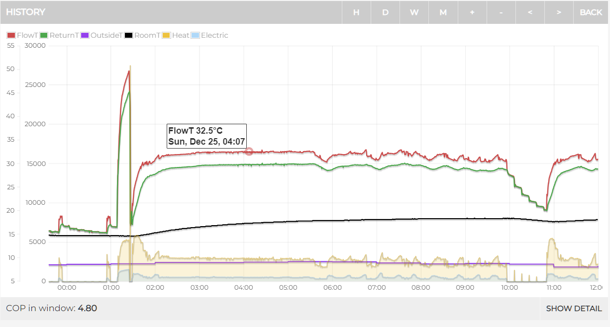

DanDee Posted August 11, 2023 Posted August 11, 2023 On 11/08/2023 at 14:41, Archer said: This video by John Cantor has some interesting analysis of Heat Pump cycling and how it isn't always a bad thing. I'm going to post a related dilemma in another thread so as not to hijack this one - would be grateful for any thoughts from people though. Expand This is an example of how John's 6KW Ecodan, instead of running smoothly at minimum it chases its own tail in between compressor speed and expansion valve, continuously adjusting its opening until the system overshoots the target temp and starts cycling. With the cycle COP being lower due to the system pressure adjustment, and not being able to set itself to a fixed condition(or more constant).
SteamyTea Posted August 11, 2023 Posted August 11, 2023 On 11/08/2023 at 15:22, DanDee said: This is an example of how John's 6KW Ecodan, instead of running smoothly at minimum it chases its own tail in between compressor speed and expansion valve, continuously adjusting its opening until the system overshoots the target temp and starts cycling. With the cycle COP being lower due to the system pressure adjustment, and not being able to set itself to a fixed condition(or more constant). Expand Not watched the video (watching the mist come in over Mount's Bay instead), but are those symptoms a sign of a poorly designed system, rather than just one component?
DanDee Posted August 11, 2023 Posted August 11, 2023 On 11/08/2023 at 17:22, SteamyTea said: Not watched the video (watching the mist come in over Mount's Bay instead), but are those symptoms a sign of a poorly designed system, rather than just one component? Expand I need to re watch the video(I seen in the past, not today), I think the video was done with examples from other systems vs the one I mentioned(his current one). The system in my analysis runs very well when it comes to delivering medium to high output, very rare does modulate efficiently as expected for minimum output, but often starts to cycle due to the flow temp rising as a result of the system increasing the compressor speed at the time when the condensing temperature/pressure is on the rise anyway due to how the system manages the opening of the expansion valve(closing and opening at certain levels within whatever the parameters set in the system).
