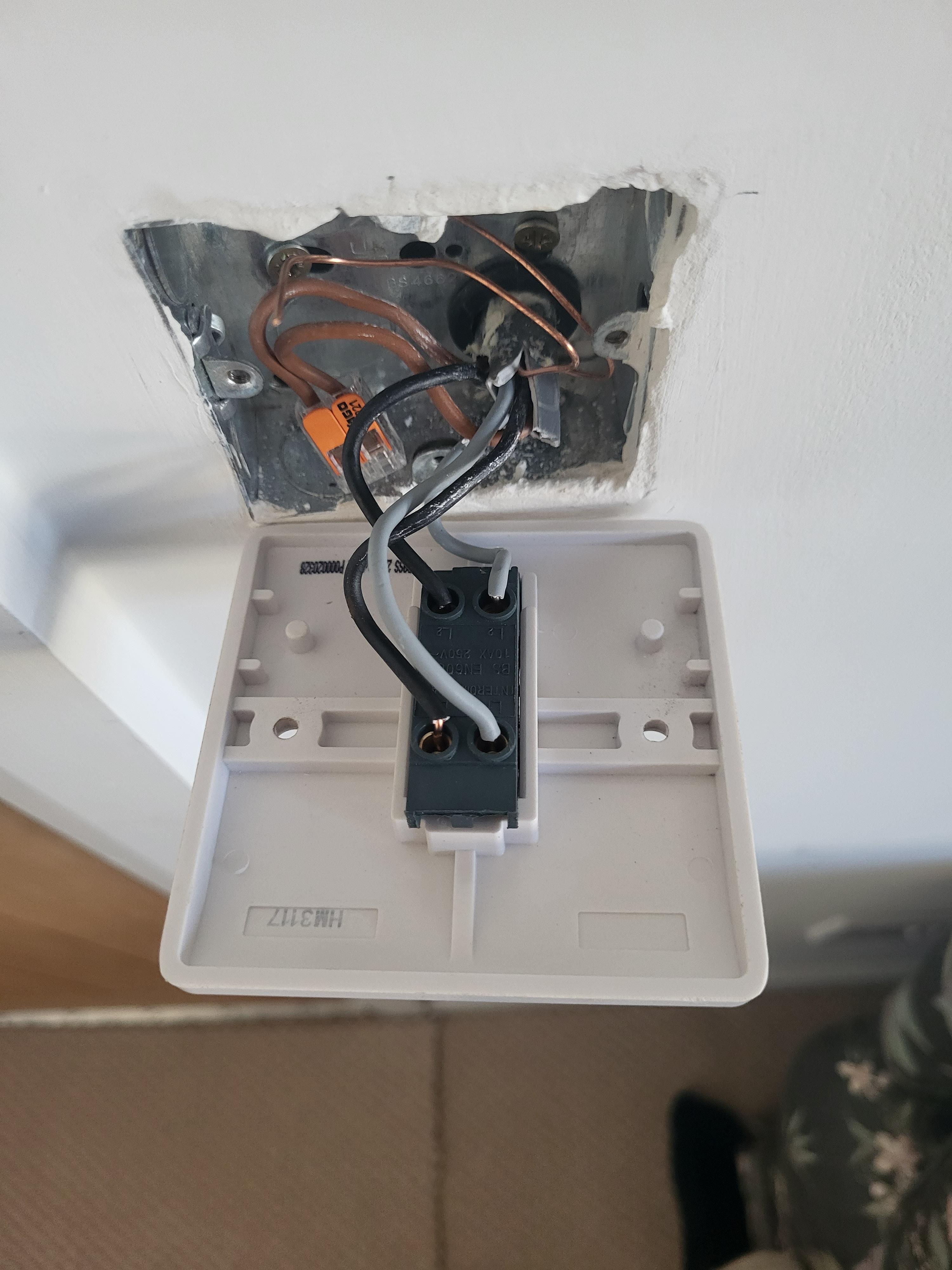

Andehh Posted August 8, 2023 Posted August 8, 2023 (edited) I have over complicated the garage lights, and now need to simplify. Our electrician has proven himself somewhat of a ''character'' so I am trying to limit our active use of him. The garage lights are controlled via three standard light switches & a PIR. Idea being, the PIR is the main controller for the lights, but there are over ride switches. 2 inside the garage & one in the corridor leading to it. It sort of works, but gets very confusing as to whether a light is on due to PIR (& its timer) or one of the switches....and whether you need to turn it off again, or whether it will turn itself off. Before I ask the electrician to strip it back out again...what would work is if I could replace each of the light switches with an equiv one but that is on a timer itself..... so whatever has turned the light on...we know it will turn itself off again. I found the below off Amazon which looks like it would work, but the switches are all double wired into each other (ie 2 x black and 2 x grey into the back of them), and this one only accepts a single wire. 6A Illuminated Timer Switch Rundown time lag Energy Saving, 12sec-12min Adjustable 2 Wire : Amazon.co.uk: DIY & Tools Can anyone recommend an equiv switch to the above, but that can take multiple wires in/out to link it to the other switches? Thanks! Edited August 8, 2023 by Andehh

TonyT Posted August 14, 2023 Posted August 14, 2023 The photo shows an intermediate switch. green and yellow sleeping required on the bare copper and some brown tape on the other conductors.
Andehh Posted August 14, 2023 Author Posted August 14, 2023 (edited) Thanks Tony, have you ever come across an automatic intermediate switch? Unfortunately he can be patchy on these finishing details...... Hence desire to try and avoid using him other then this last headache I'm trying to work through! Edited August 14, 2023 by Andehh
Mattg4321 Posted August 14, 2023 Posted August 14, 2023 No sleeving. Are you sure this guy is an electrician??!!
Andehh Posted August 14, 2023 Author Posted August 14, 2023 If trades were trusted, reliable and did their job first time.... This forum would be a bloody quiet corner of the Internet!!!! 1
TonyT Posted August 14, 2023 Posted August 14, 2023 You need to show what’s at the other switches and light fittings to see how it’s wired. I’ve not seen an intermediate PIR

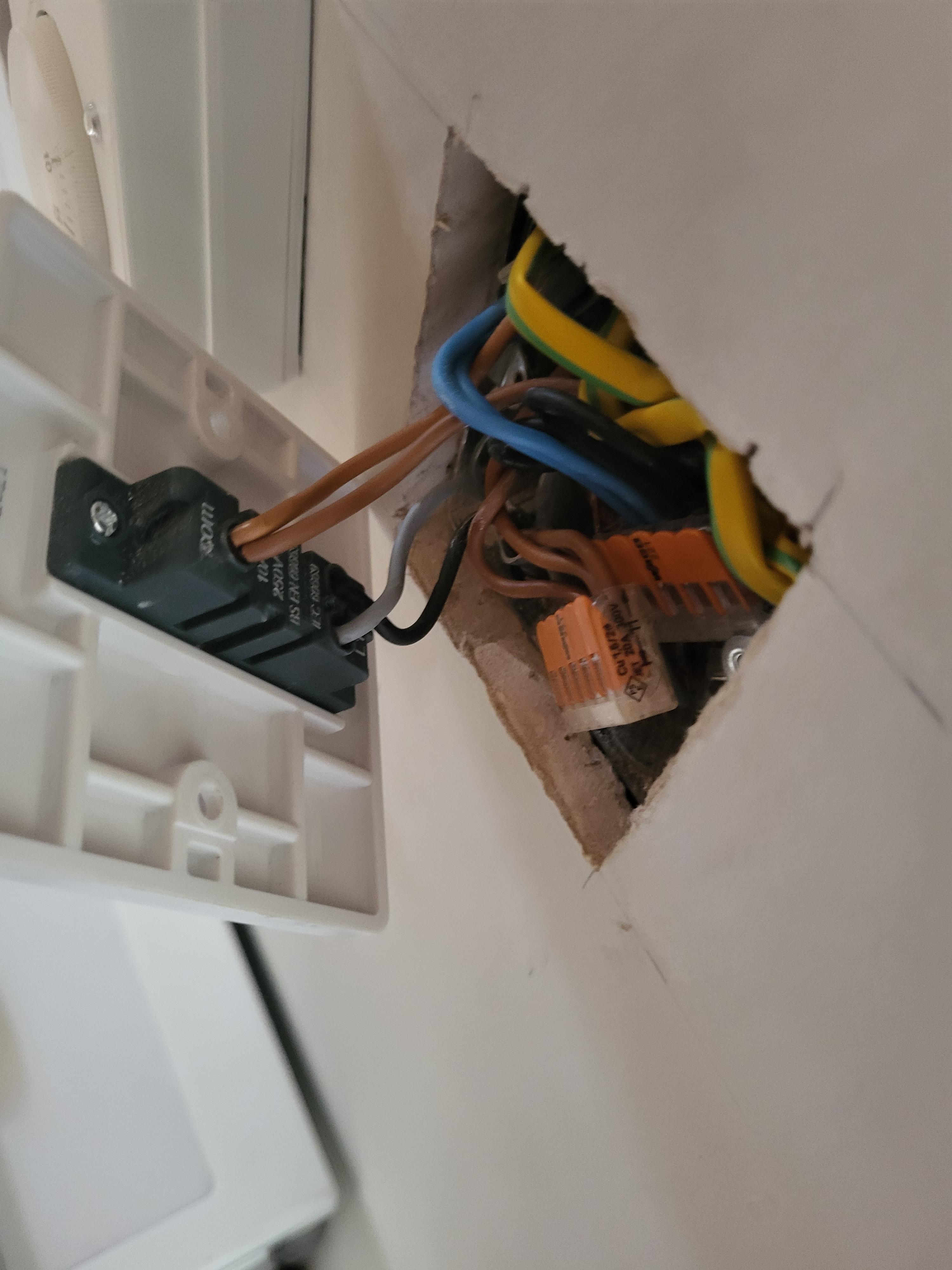

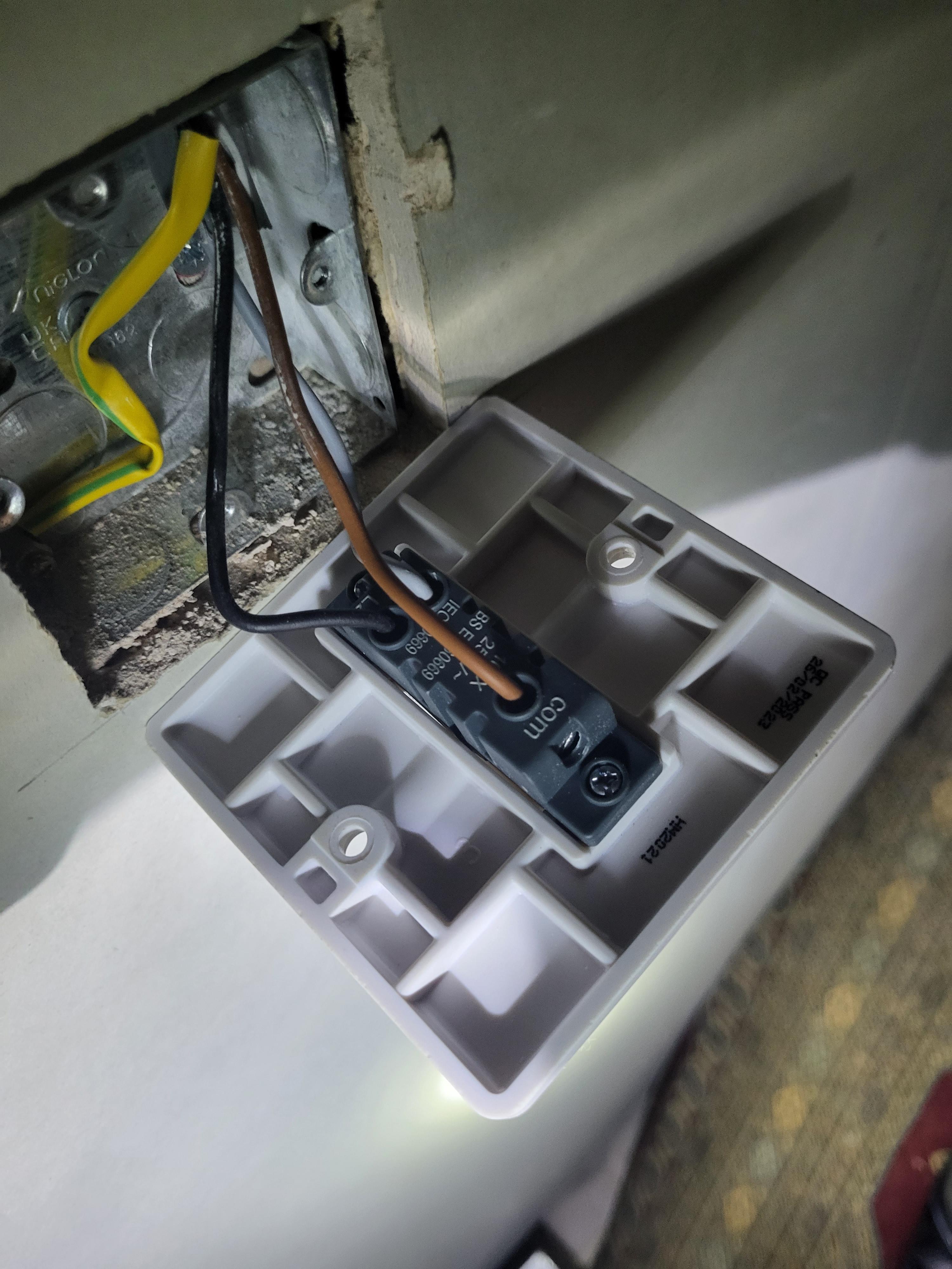

Andehh Posted August 14, 2023 Author Posted August 14, 2023 Thanks Tony! Please see attached photos of the three switches. All work as manual "on" over rides.
Mattg4321 Posted August 14, 2023 Posted August 14, 2023 Any of the time lag switches will work as you have a 3 core and earth between the switches. It’s an incredibly simple job for a competent electrician. 1
Andehh Posted August 14, 2023 Author Posted August 14, 2023 Thanks Matt, is that with the intermediate switch? As that's the one in the critical location to make it work for us? Any wiring diagrams to articulate what you mean please? Thanks
Mattg4321 Posted August 14, 2023 Posted August 14, 2023 You won’t wire it as an intermediate/normal 2 way set up as the way time lag switches work is completely different. They turn themselves off, rather than it needing to be possibly turned off from 3 positions. You’ll just need to provide a permanent line and neutral to each switch. Then common together all the switched line outputs to the lights.
