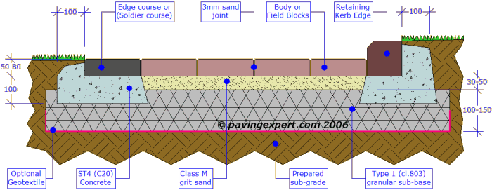

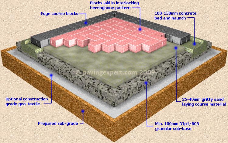

Temp Posted August 5, 2023 Share Posted August 5, 2023 (edited) Most weeds don't really grow up through the gaps they grow down into them. It's near impossible to prevent that - I resort to weedkiller.  The Paving Expert website is great for all things paving..  Choosing.. https://www.pavingexpert.com/blocks03 https://www.pavingexpert.com/blocks  Example specifications.. https://www.pavingexpert.com/specs01#specbpv  In my experience the two key things to get right are the preparation (compacting the ground, compacting hardcore in layers, falls, drainage etc) and edging/kerbs especially on driveways but also if ride on mowers will drive over edges. If you don't get that right no matter how good it looks initially it won't last.  Brick pavers are normally laid on sand over hardcore but if you change your mind to something else like Paving slabs they may be laid on mortar.. With some types of slab or on steps and capping stones it's essential to butter the back of them with a slurry primer not just lay them on mortar. If you don't they will come unstuck after a few years. I've used Ultrascape Pro Prime for this. Mortar should also be full coverage not dot and dab (With some types of stone the mortar pattern will show through as surface staining).  Pictures from the Paving Expert site..   Edited August 5, 2023 by Temp Link to comment Share on other sites More sharing options...
