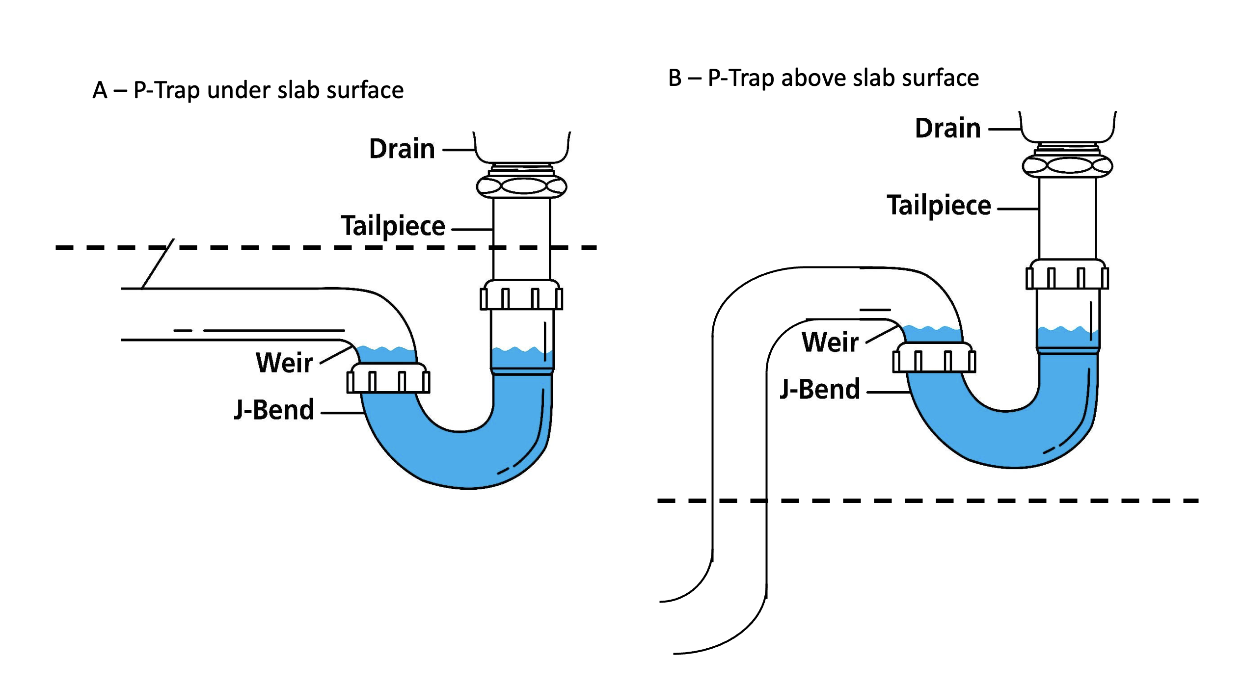

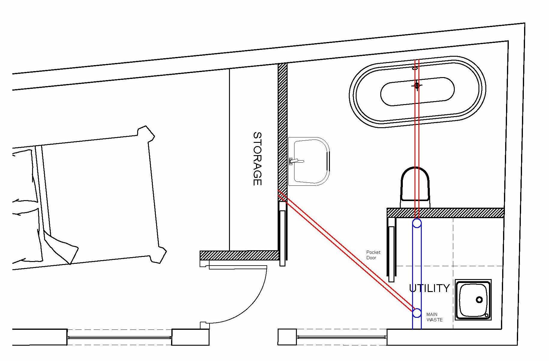

tvrulesme Posted August 5, 2023 Share Posted August 5, 2023 I'm in the process of slowly converting a garage into living accomodation. The garage currently has a concrete slab floor which will need to be insulated and screeded etc. One part of the garage will be the master bathroom. I have a basic layout and know that I will have a freestanding bath so would like to chase the concrete for the drainage as I will need to hire a floor saw for another job so may as well get this chased at the same time. Layout of the bathroom is below (red lines show 50mm waste, blue 110mm waste): My question is regarding a P-Trap for the bath waste. Is it advisable/recommended to have the P trap burried in the slab so I have max wiggle room above to connect to the freestanding bath or would you just poke a 50mm though the slab (with a 90 degree bend) and have the trap above the slab? i.e. A or B in this picture? Link to comment Share on other sites More sharing options...
joe90 Posted August 5, 2023 Share Posted August 5, 2023 (edited) I would not bury a p trap in a concrete floor with no wriggle room to fit the bath, why not use a bath trap https://www.screwfix.com/p/mcalpine-bath-trap-white-40mm/84362. Above slab, short length of 40mm pipe then 90’ bend down into concreted pipe work, far more flexibility and you are able to change/clean the trap in future. Also with this you don’t have to sweat about accurately placing the under slab pipe work. Edited August 5, 2023 by joe90 1 Link to comment Share on other sites More sharing options...

tvrulesme Posted August 5, 2023 Author Share Posted August 5, 2023 6 minutes ago, joe90 said: I would not bury a p trap in a concrete floor with no wriggle room to fit the bath, why not use a bath trap https://www.screwfix.com/p/mcalpine-bath-trap-white-40mm/84362. Above slab, short length of 40mm pipe then 90’ bend down into concreted pipe work, far more flexibility and you are able to change/clean the trap in future. Also with this you don’t have to sweat about accurately placing the under slab pipe work. Yes I thought this would be the way to go. I was balancing the extra wiggle room above for the bath vs trying to get accuracy when I haven't even figured out which bath I'm going to get yet. Link to comment Share on other sites More sharing options...
