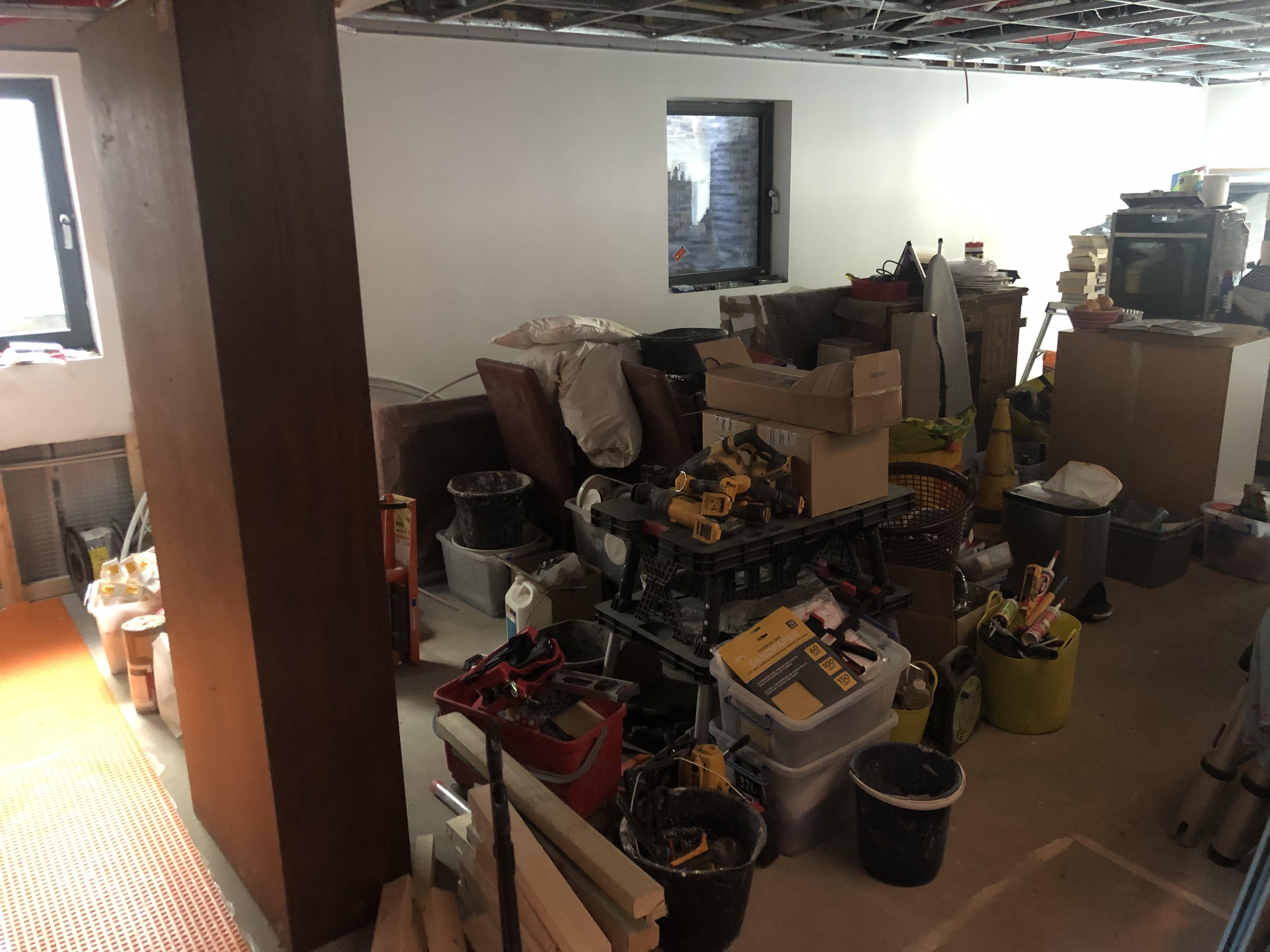

Pocster Posted August 2, 2023 Author Posted August 2, 2023 Picture is worth a thousand words @ToughButterCup . The orange on the floor to the left is the decoupling mat . So I can tile maybe 2 rows before I swear again
