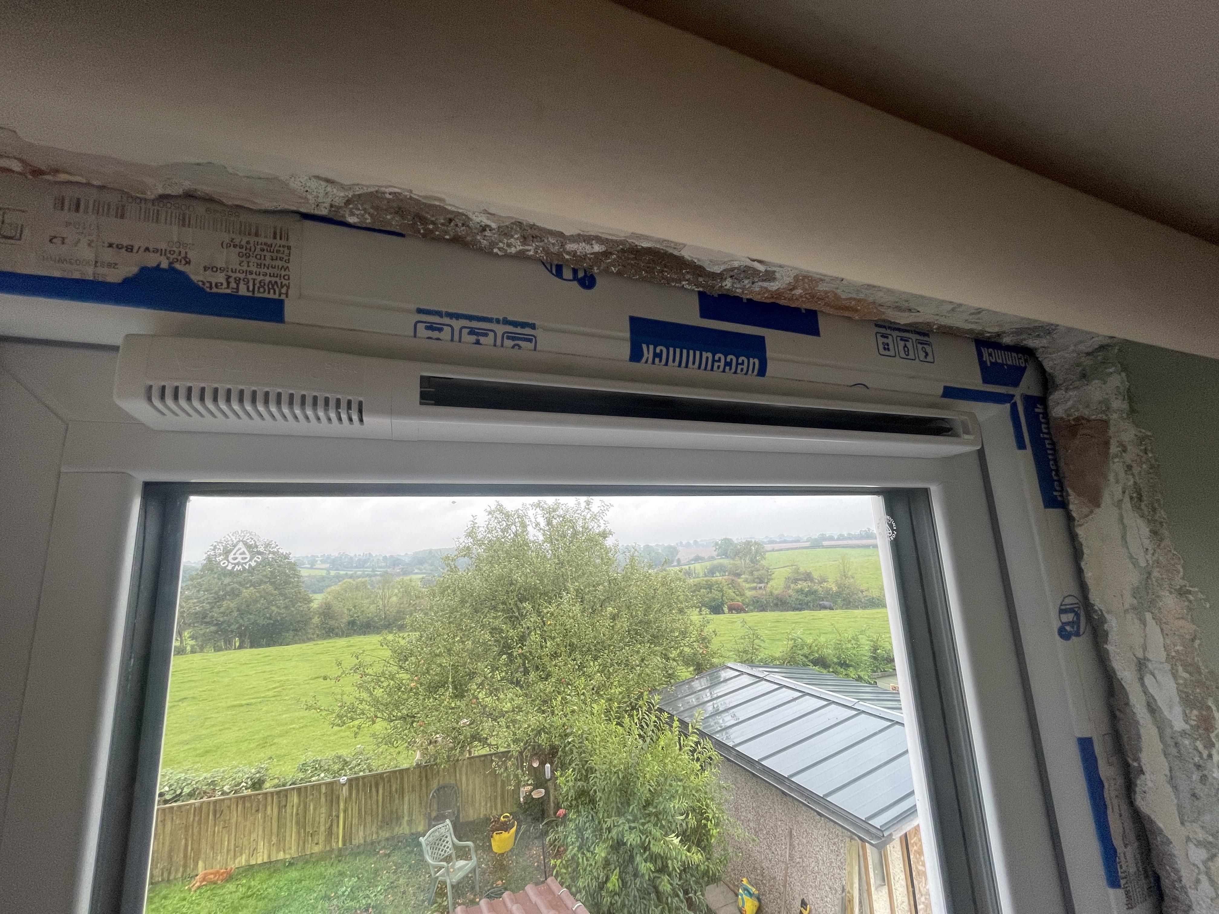

HughF Posted August 2, 2023 Posted August 2, 2023 I ordered my new bedroom windows (Uw 0.98, 3G, upvc - nothing fancy) with 4000mm2 vents fitted to each opener (my fabricator of preference didn’t fit them onto the head), and now I’m looking at replacing the supplied trickle vents with humidity actuated ones. I ordered some from bpc ventilation, can’t remember the exact brand, but they’re too chunky to fit. Does anyone have a recommendation for slimline ones?

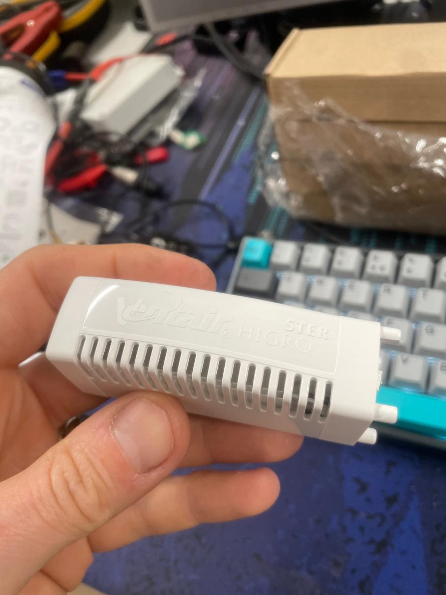

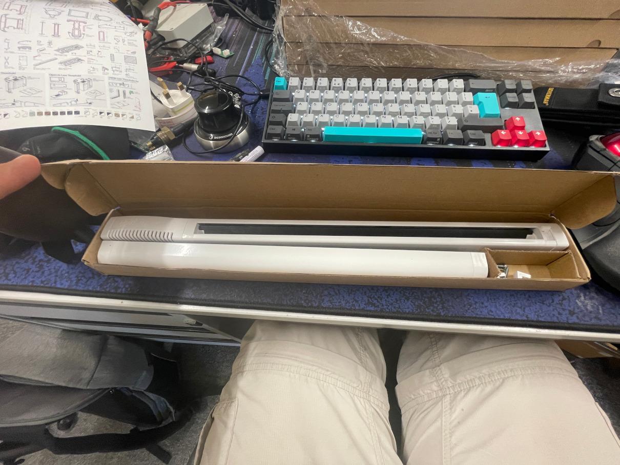

HughF Posted September 14, 2023 Author Posted September 14, 2023 They have arrived... Very much nicer than the ones from Glidevale... 2

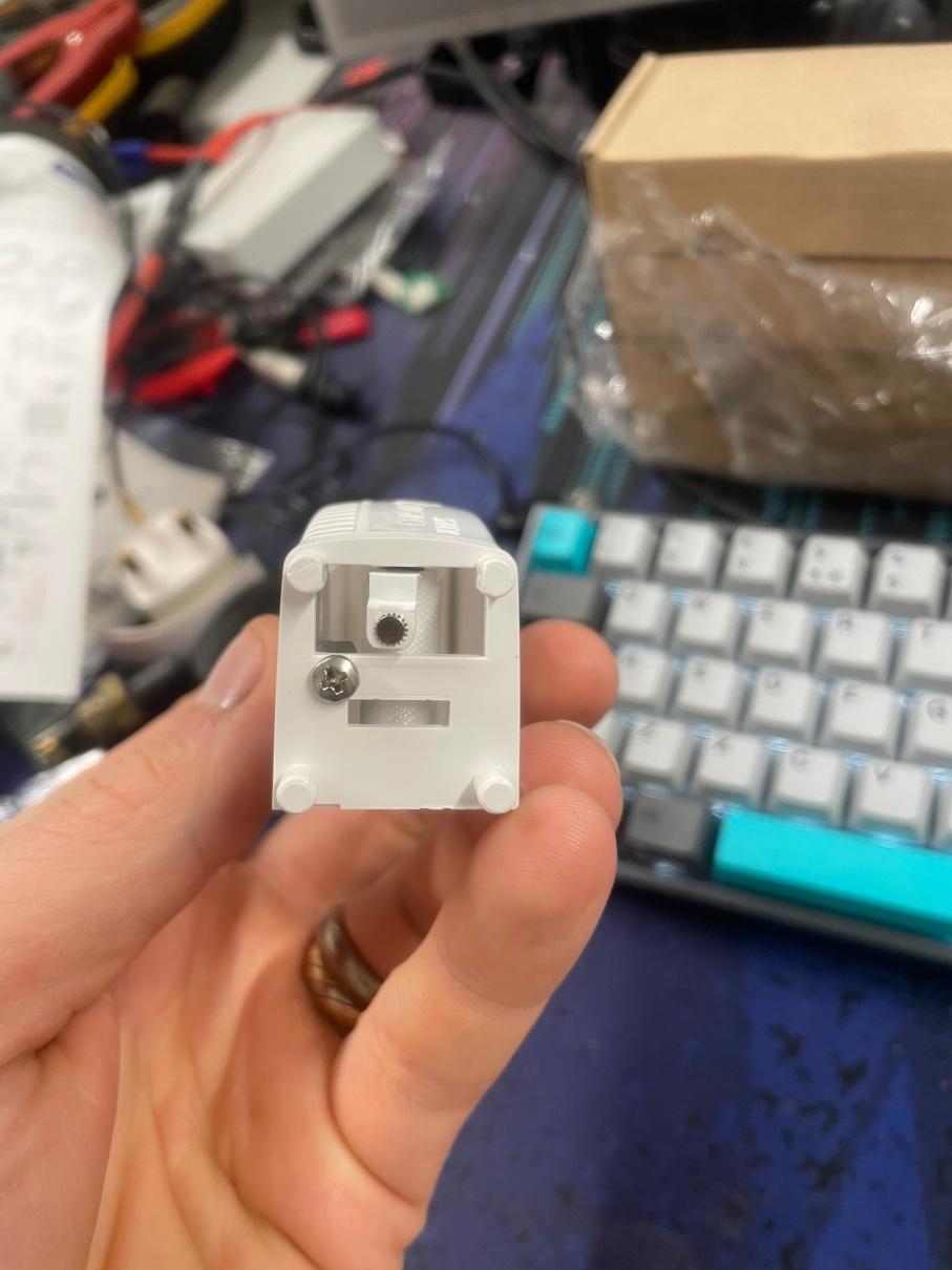

HughF Posted September 17, 2023 Author Posted September 17, 2023 Urghh, always something…. Slots are wider than the mounting holes on the fancy new vents… I’ll figure something out…

HughF Posted September 17, 2023 Author Posted September 17, 2023 5 minutes ago, HughF said: Urghh, always something…. Slots are wider than the mounting holes on the fancy new vents… I’ll figure something out… Wondering if I can just glue them on with mitre fast? The outsides fit perfectly, just the inside that’s the issue
HughF Posted September 18, 2023 Author Posted September 18, 2023 16 hours ago, HughF said: Wondering if I can just glue them on with mitre fast? The outsides fit perfectly, just the inside that’s the issue Yep, mitre fast and one screw to the rescue… 1
